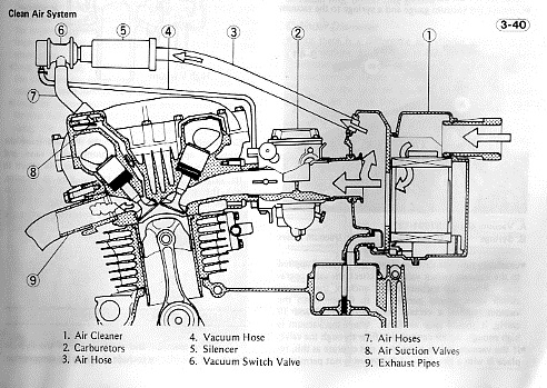

If the epa paraphernalia is still connected, would detach its vac hoses from the carb holders, and cap/plug the vac nipples on the carb holders (see image below). This is to eliminate possible air leakage due to the epa paraphernalia.
Could also temporarily detach the vac hose from the carb or carb holder that's furnishing vacuum to the petcock, so as to eliminate possible air leakage incident to the petcock, and test run with the petcock in PRI position.
The above should leave all vac nipples capped/plugged.
If racing idle persists after warm-up, use the thumbscrew to reduce rpm to the lowest relatively steady idle, where WD40 may be sprayed around the carb holders to test for any change in rpm caused by ingestion of the WD40.

I can easily run a section of vacuum line to connect the 2 nipples you have pointed out in the image on the right, but what exactly is the image circled in red that needs to be removed? What exactly is that?

26 Apr 2012 20:41 - 26 Apr 2012 20:42SpectreRob750 wrote: I can easily run a section of vacuum line to connect the 2 nipples you have pointed out in the image on the right, but what exactly is the image circled in red that needs to be removed? What exactly is that?
What exactly is that? --- That's the factory installed epa paraphernalia on bikes so equipped.
It's called Kawasaki Clean Air Injection System (see image below).
It's unnecessary for proper engine performance.
It serves to inject addition air into the exhaust ports to help burn any remaining fuel.
If it's there, toss it!
