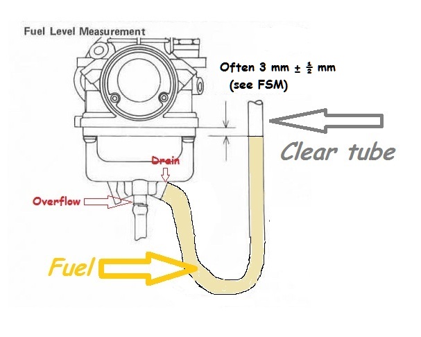

Am uncertain whether the carbs at hand have an overflow circuit.
Such circuits aren't electrical. An overflow circuit basically consist of a vertical tube inside the float bowl allowing gasoline to escape when the level gets high enough to reach the top of the tube.
Gasoline entering at top of the tube passes down through the tube and out through an exterior nipple on the bottom of the float bowl.
If there's no nipple on the bottom of the float bowl, there's likely not an overflow circuit in the carb.
Where there's no overflow nipple (usually with a hose attached which is routed to exit underneath the bike) there's no visibly escaping gasoline to indicate an overflow condition inside the carb.
Without an overflow circuit, proper operation of the float valve may be determined by performing the clear tube test. Such test will demonstrate whether the correct fuel level is being maintained by the float valve.
The clear-tube test doesn't require removal of the carbs.
If the clear-tube test indicates a malfunctioning float valve, there are other possible remedies that don't require removal of the carbs.
