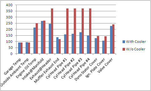

OMR's chart provides a definitive answer to the question about their effectiveness. One thing that jumps out at me is the 16 degree increase in temperature at the exhaust outlet. I wonder if there was a tuning difference that led to a change in EGT or did the addition of the cooler alone produce this?

A 200+ degree drop in cylinder head pipe temps sounds way too much, and the exhaust header temp drop also sounds strange to me, but then again I'm no engineer. It's also strange to see the inlet temps being about the same as the outlet side considering that fuel constantly cool the inlet side and hot gasses constantly heat the exhaust side, but I guess there are reasons for this that I do not understand.
The drop in oil temp is very reasonable and is what I would be concerned about. In general, we do not have temps high enough nor speed limits high enough to warrant a cooler, but if I did a lot of hard running and/or idling in traffic in a warm climate, I would definitely add an oil cooler. And even if you do add a cooler that you rarely need, you can cover it up most of the time to prevent air flow and just leave it open when needed.

Keep in mind all, laser temp guns can be tricky/deceiving due to angles (reflected light vs refracted back to the gun)....
The key notes in those measurements are as follows...
* All FLUKE Bead measurements are accurate (oil temps).
* Laser "Cover" measurements will be fairly accurate due to decreased angles, aimed right at the cover.
* In noting the intake & exhaust ports, assumption is fairly accurate due to minimal measurement change in the intake side for this wouldn't change but the exhaust side would due to decreased operating temps, kinda makes sense...
As for the exhaust pipes, hard to say due to angles, not sure I buy the large change either but these are the measurements obtained with the laser temp I recorded...
The biggest thing for me is the oil temp, here in AZ @ summer temps of 110-118F, oh yeah huge change in oil temp thus engine temps... Must needed here in Hell! :laugh:
Just in case interested, tools used...

10 Apr 2012 16:40 - 10 Apr 2012 16:57OMR, I graphed your readings in a crude spectral format. Some interesting stuff there. Can you repeat these tests to give a more statictically sound look? Also, can you verify your IR gun readings with your contact thermometer? I have a healthy distrust in those IR guns as the emissivity of different materials can throw them off at different temps. Is 370 the max scale on your IR gun at an emissivity of 1? Interesting that the oil in the case only changed a few degrees and yet you see that huge difference in temp at the "pipe". Can you show us that location? The reason I am so curious is I live in Phoenix (Chandler) as well and I don't ride my KZ in the hottest months because I don't have a cooler but I want one but have heard so many conflicting opinions. I would like to repeat your tests when it gets to face melting temps here to see what different oils, coolers and some other variables will have on the temp and performance of the bike.

20 Apr 2012 21:37I'd have preferred to see a chart done apples to apples- seems temps and dyno oil were checked against cooler and synthetic.
I cant find the chart I found on the net showing 4 engines on a dyno and all they compared were dyno to synth. Fake oil ran quite a bit cooler
