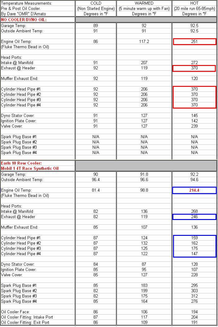

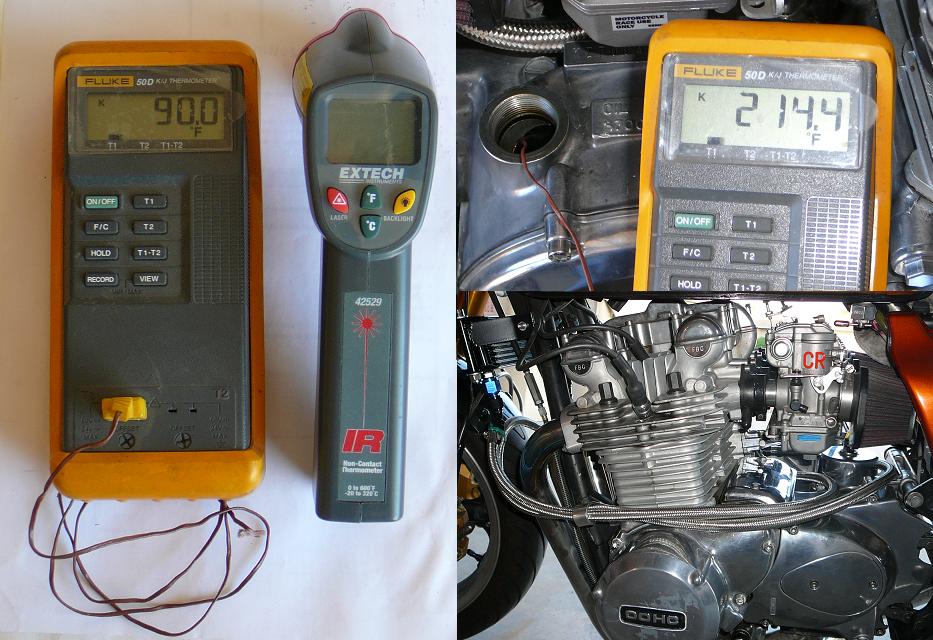

26 May 2011 07:31The after market kits would take oil under pressure off the main oil gallery. There's a plug on the right hand side of the engine that they would remove and install a plumbing fitting to attach the oil line.
That plug is for measuring the oil pressure.... On my KZ anyways... :S
I can't speak for this guy but I know what I measured in temperature differences pre & post cooler on my 900 here in AZ @ 92F... I believe the same would happen when it's 115F :pinch:
He's correct about the cooling fan concept where stop & go traffic, cooler won't do a lot. But when 115F out, I stay in the pool, screw riding.... :laugh:
