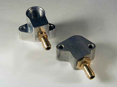

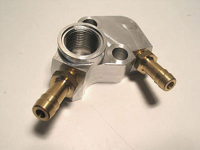

No eBay APP ID and/or Cert ID defined in Kunena configurationHere's an example of the two parts that are fitted to connect the two hoses routed to and from the finned cooler.
These two parts replace the single stock part where the oil pressure switch is located.
Other versions include the hose barbs.

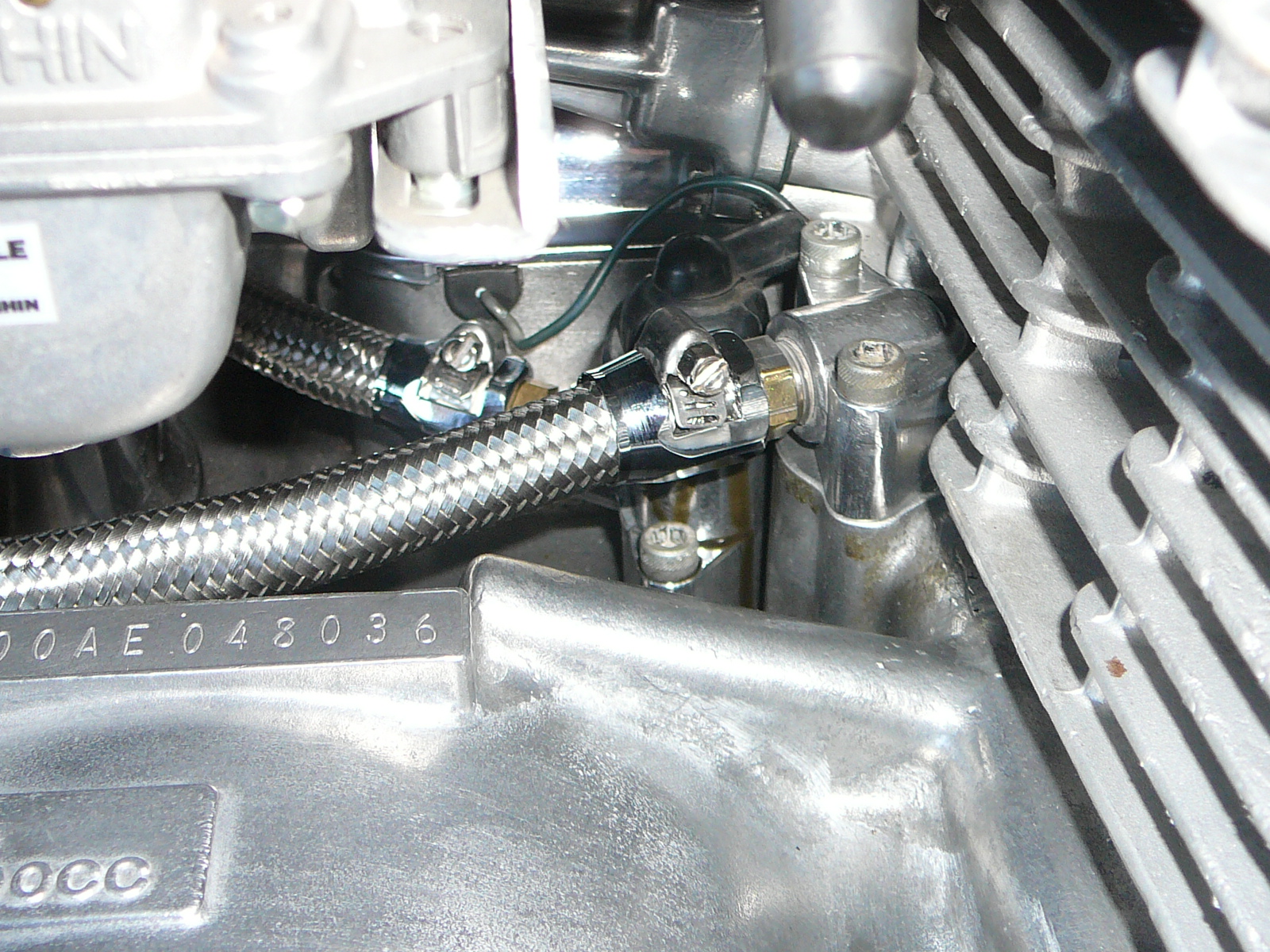

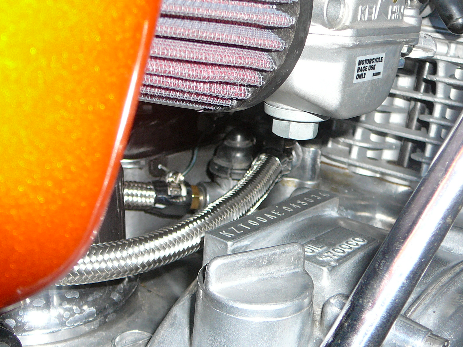

Sorry but this is about the best shots of the coupler engine mounting I have... Should at least give you some ideas...

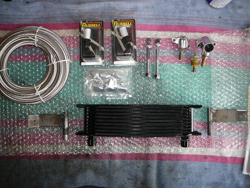

Regardless of the cooler you go with, here's pretty much the complete setup...
Coolers mount differently so don't mind my Earls side mounts.
