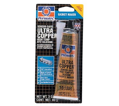

If annealing fails to fully seal, could add a second old gasket (if available), and regardless of whether using one old gasket or two old gaskets, could also slather in some Permatex hi-temp copper sealant.

Wireman is right, these are the folded gaskets and they definitely took a set the first time they were installed. I just learned my lesson, and I'm going to order a dozen on Monday. Will that high temp RTV hold up to the temps experienced right at the head. Those pipes are regularly 500*F at idle, I can't imagine how hot they get when you really pour the coal to her. I guess it's my weekend to fight with exhaust. I just got done fixing the exhaust on the Maxima. The stupid weld that held the muffler to the flange decided to break loose.
