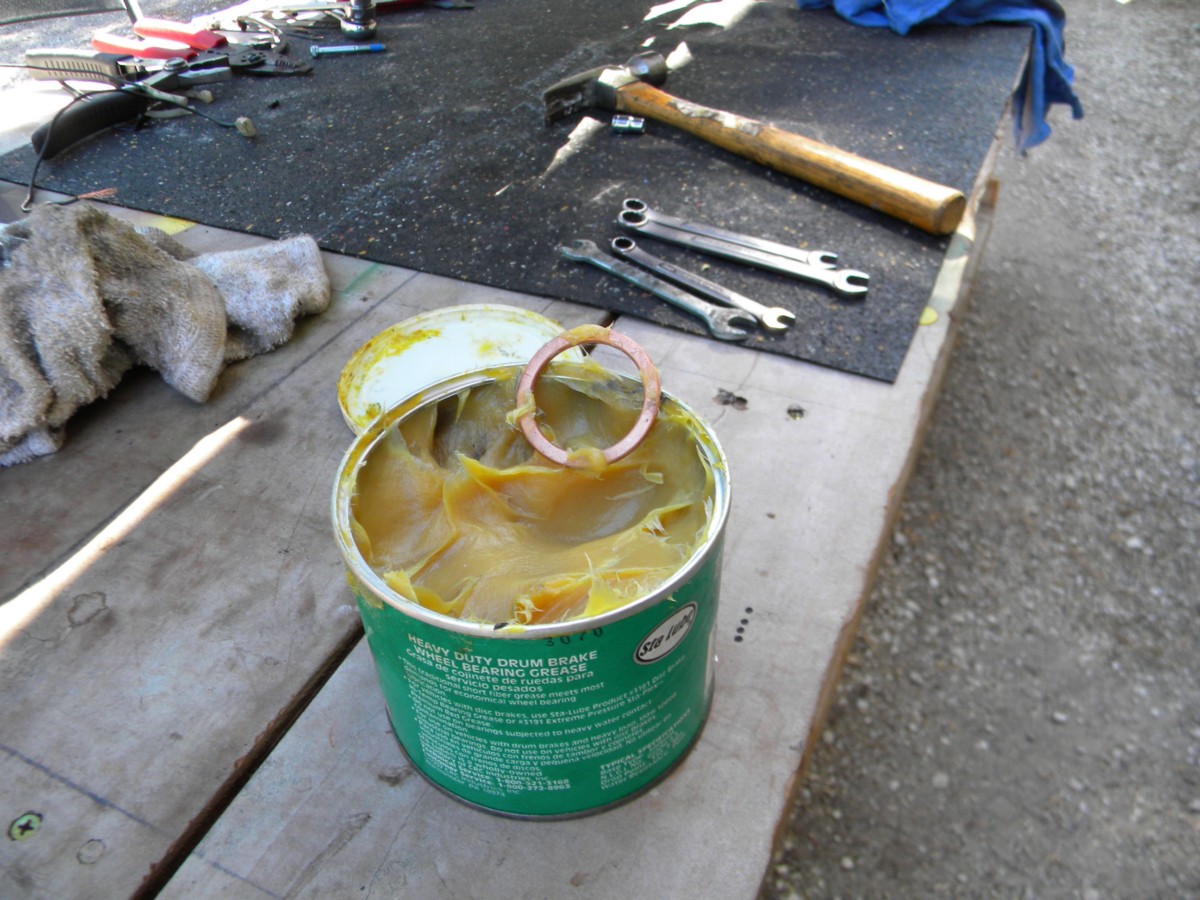

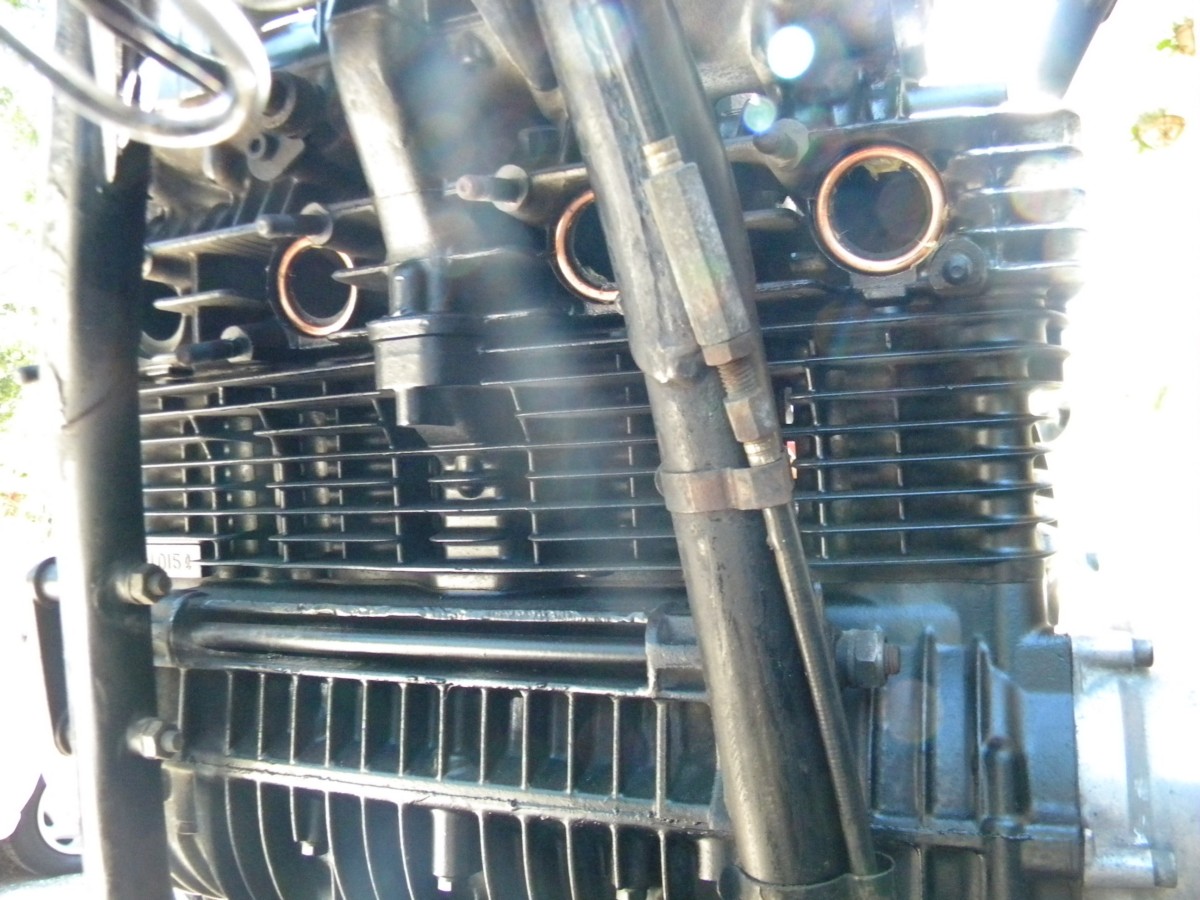

when ordering anything from Z1 ent i am now always including 8 new ones...it it the answer for me as i have many projects going and i have stripped a stud and it cost me 200 and time by the time i finally had it fixed..which could have been worse...the new ones are the answer.....these things are way to expensive for shortcuts at this stage of the game imo....

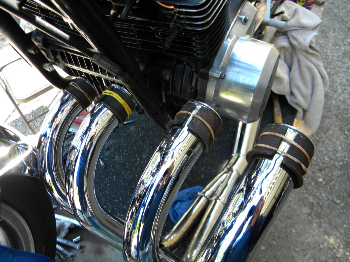

another question was how to hold them in place....i use a dab of grease wiped on the ex side...and rubber bands to hold the half collars
