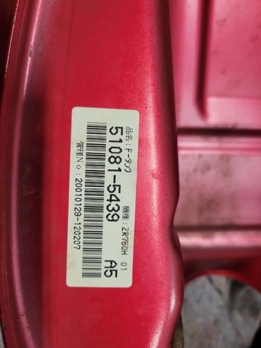

- mykznme
- Posts: 276
Re: 2004 zephyr...need help.

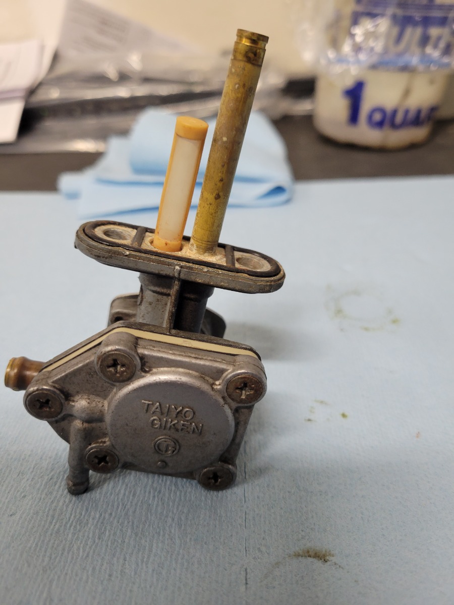

13 Feb 2026 10:30 - 13 Feb 2026 10:35This is the sticker on the tank and the petcock that was on it.
The petCock looks to have been replaced.

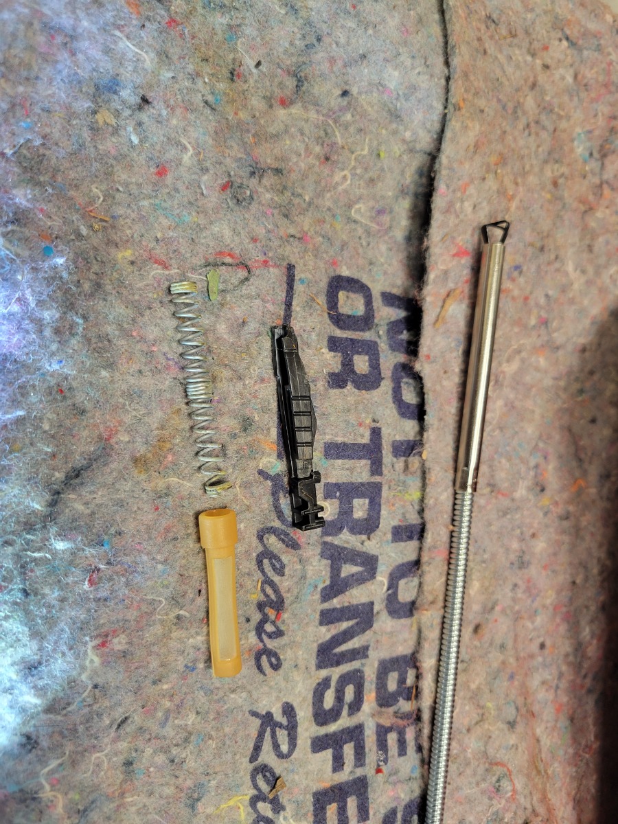

I pulled these out of the tank.
A pre filter for what I assume is from the old petcock,a spring and I have no clue what the plastic bit is from...
