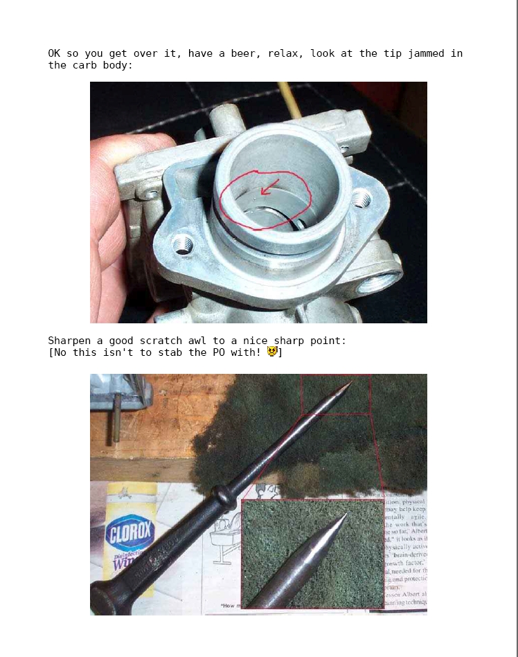

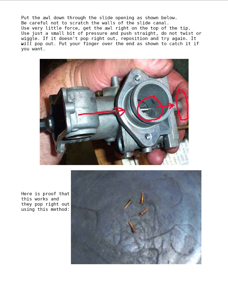

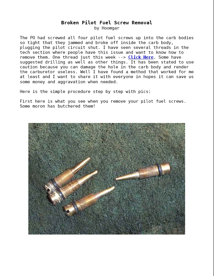

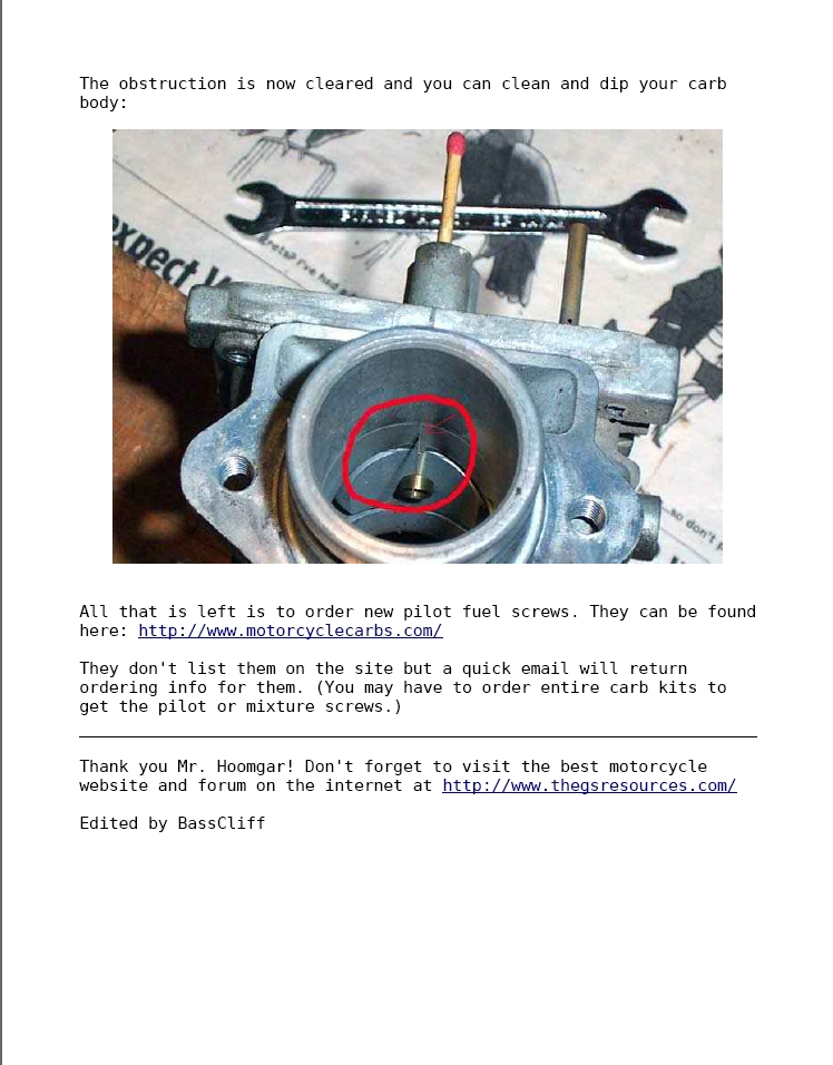

Remove the bleeder tubes under the main jets and give them a clean. Compressed air is not a cleaning medium!Did you inspect and set the pilot air mixture screws to 1 1/2 - 1 3/4 turns out? A broken air mixture screws tip can made your day!Are the carbs mechanical/vaccum synced?

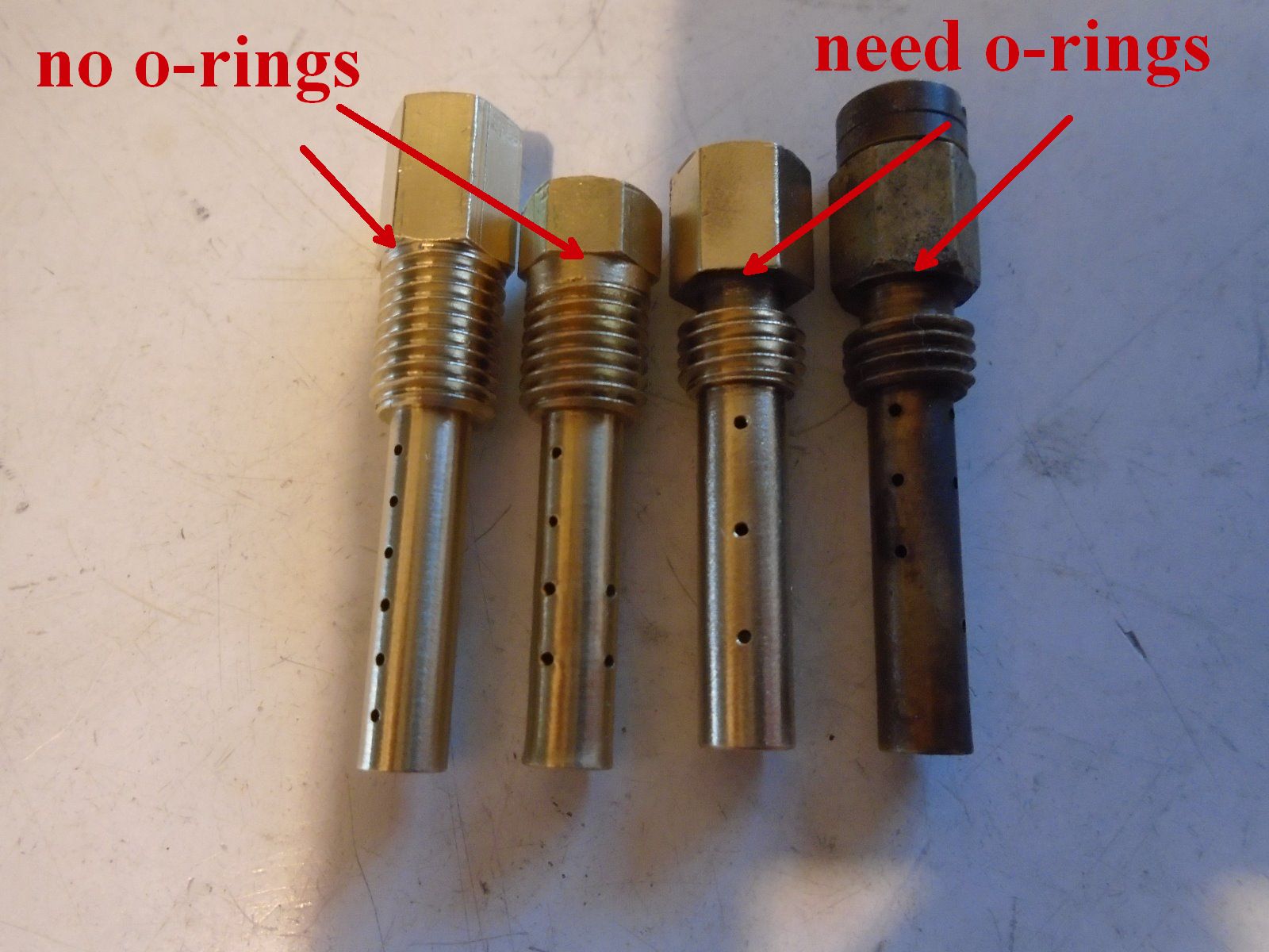

Scirocco, all above mentioned has been done air screws are 1 1/2 turns out. Mechanically synched for now. Thanks for the suggestions. These are Z1b carbs, are pilot jets supposed to have o rings? none of these do.

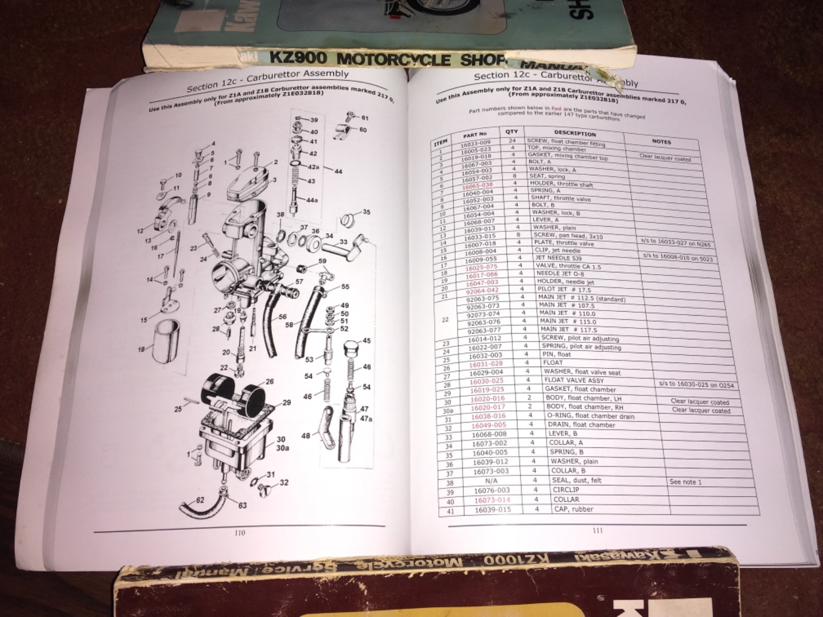

Here this will help with item terms. There are no ORings on the pilot jet #21, non on the main jet emulsion tube/ jet holder #20, nor on the pilot air adjustment screw #23.

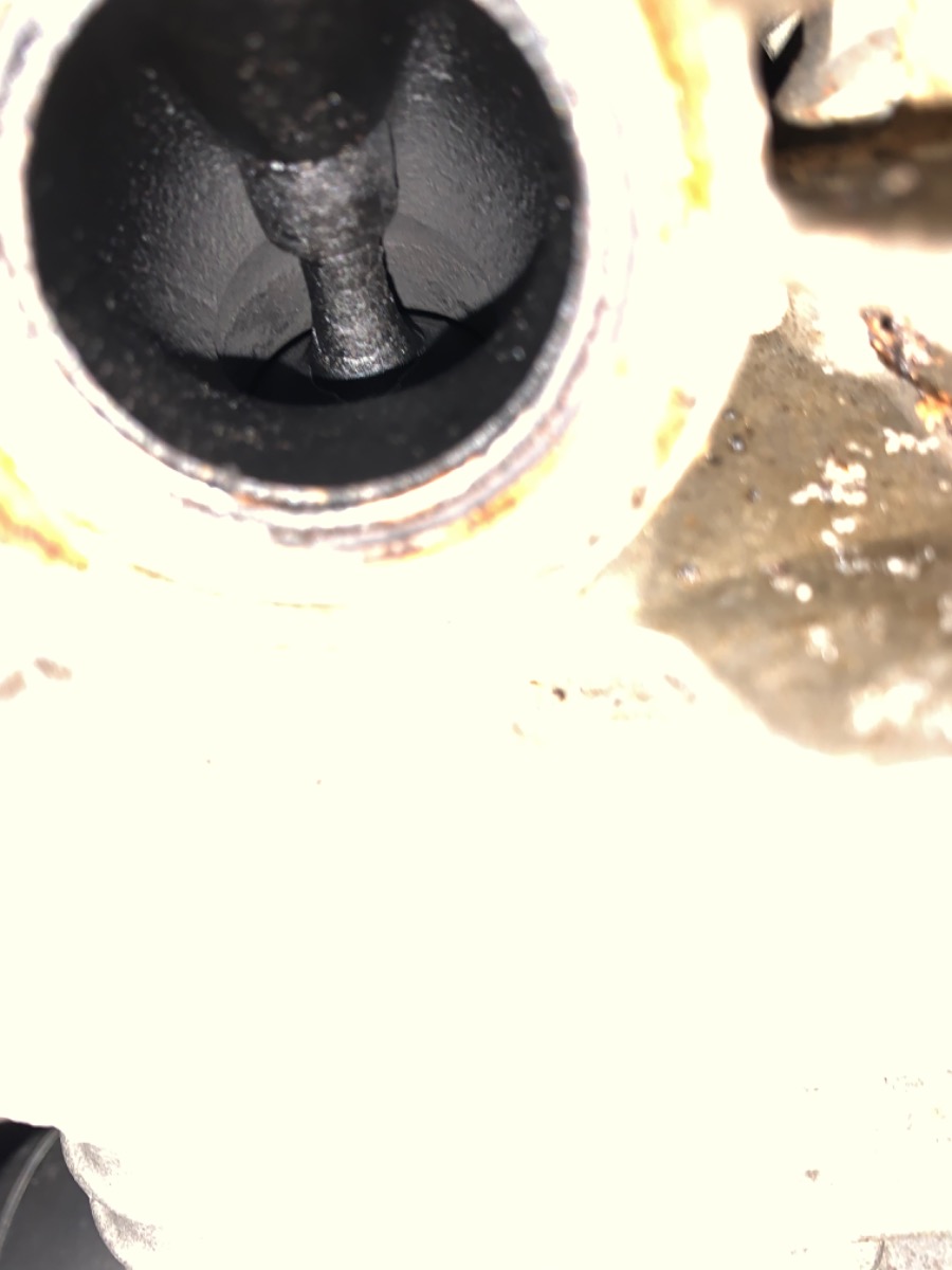

Looks like it’s been running rich or burning some oil, but I don’t see anything “Abbynormal”.
