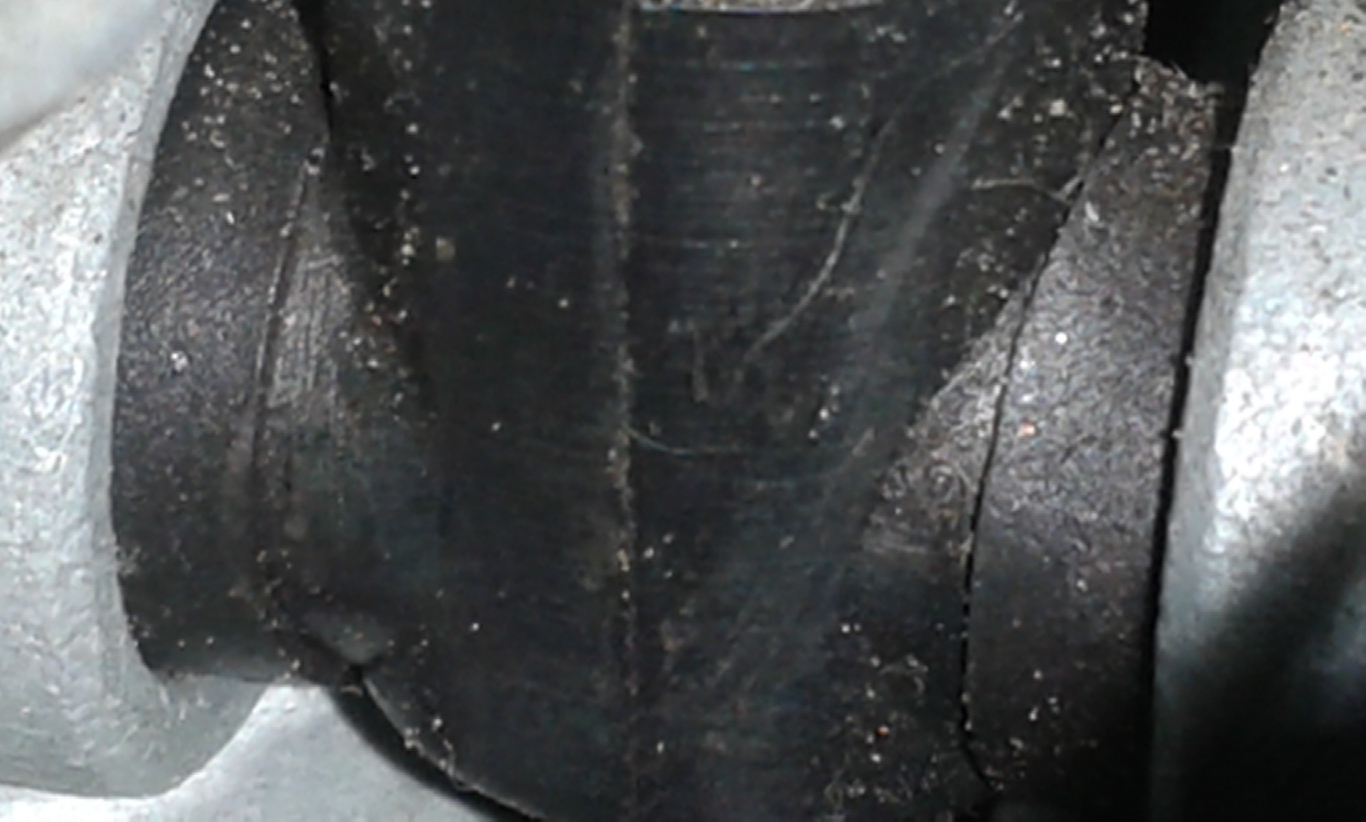

13 Mar 2023 07:45I agree ! it's almost a given they will leak.You should split the carbs. The small rubber coated fuel Tee's are almost sure to be cracked and need replacing.

13 Mar 2023 09:36I agree ! it's almost a given they will leak.You should split the carbs. The small rubber coated fuel Tee's are almost sure to be cracked and need replacing.
Or will soon. There's nothing worse than gas leaking on a hot engine, just below your crotch!

That's the plan, for now they're going on to see how it runs shifts etc. Connected battery today after my key came in the mail and all good, starter spins, spark at plugs all lights and horn work, pleasantly surprised.

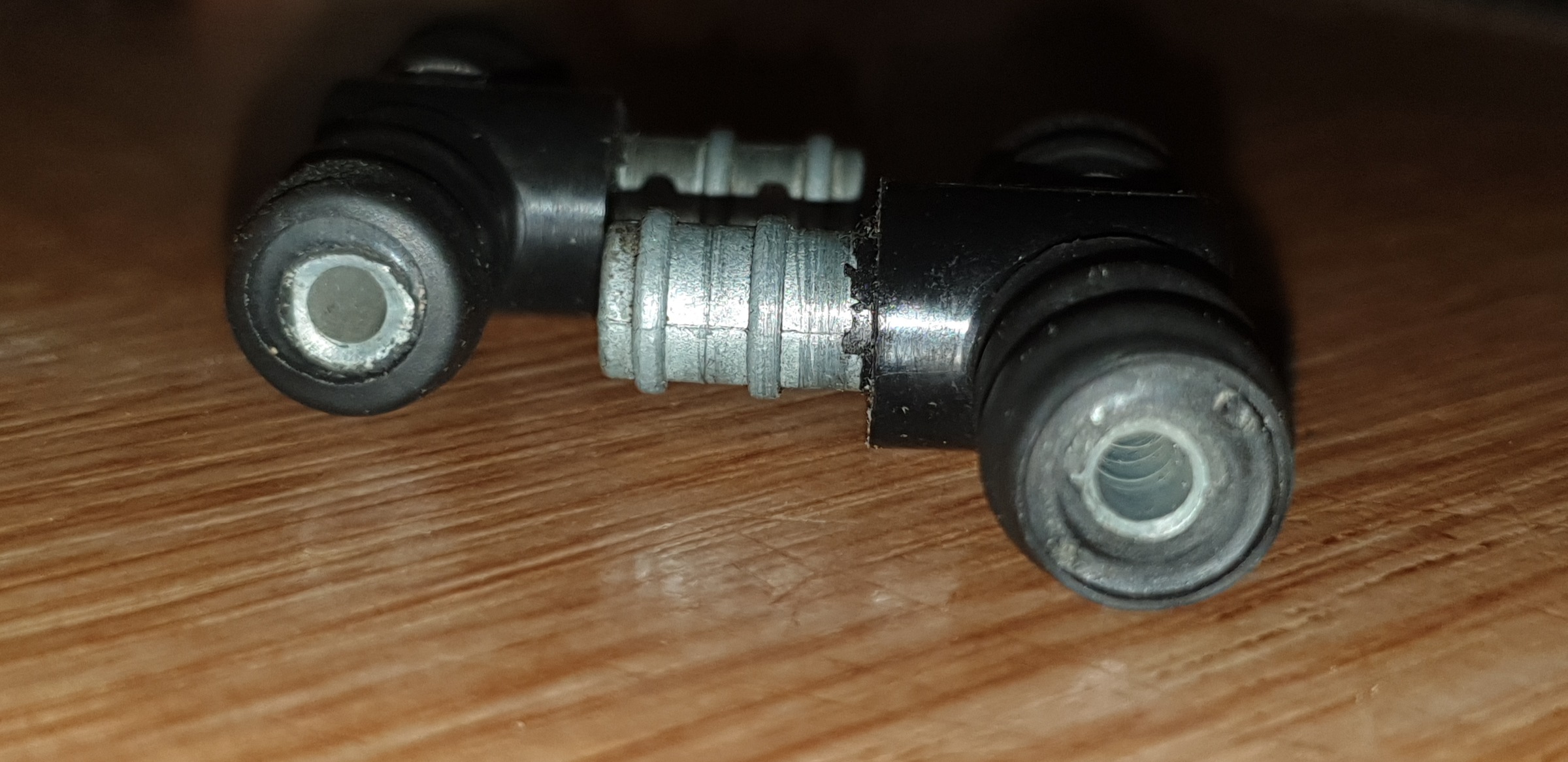

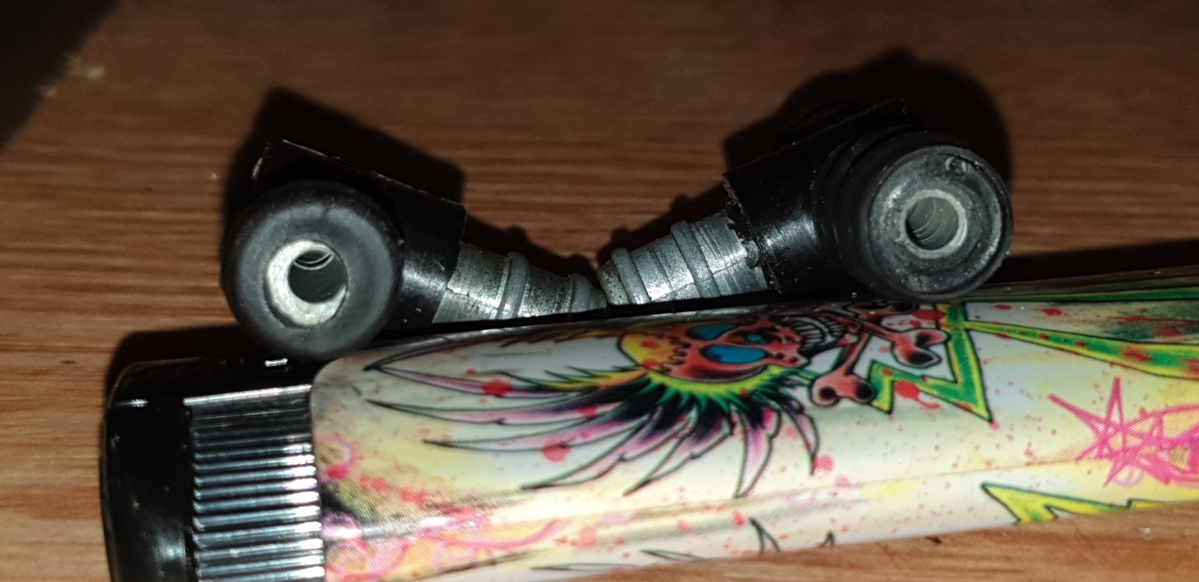

If the tees between the carbs are still in good condition you can revive them by soaking them in gasoline overnight. That will stop the leaks.

Heat shrink may not survive long exposed to gasoline, especially when exposed to ethanol.
We 're aware of a process in which Teflon tape is wrapped around fuel tees to improve the seal. We have seen carbs on which it was done perform for many years with no leaks. Teflon appears to be quite resistant:to gasoline and ethanol:

14 Mar 2023 08:20I did this shrink tube trick in 2017, no leaks.Heat shrink may not survive long exposed to gasoline, especially when exposed to gasoline.

Seams either Teflon or shrink wrap the the carbs need to be unganged. At that point buy replacement tees or upgrade to aluminum or brass with ORings. Much cheaper/easier to change at the next rebuild.

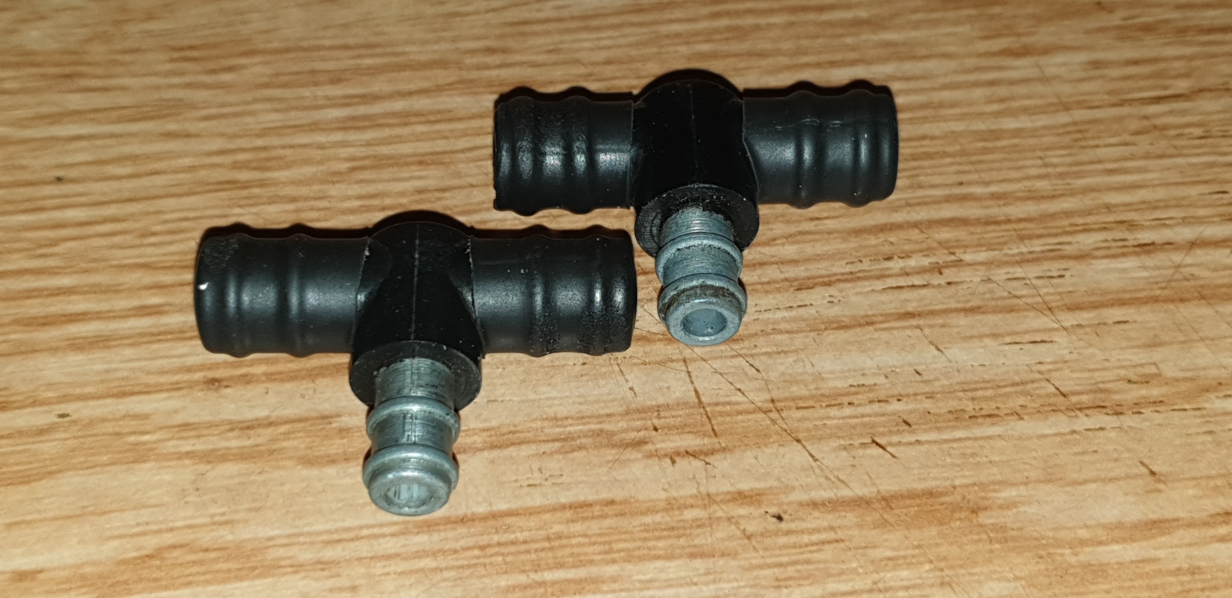

Found my spare heat shrink tubed fuel tees. Just in case if you want to give it a try and save some money.

Thank you for the offer, I believe I have everything needed to reassemble when time comes.
