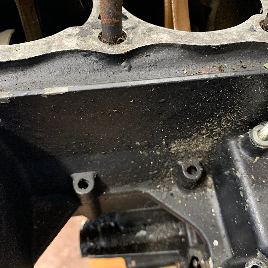

So today I started removing fasteners to split the cases, I’m waiting for my clutch tool so I’m leaving the large ones in. It’s a little nerve wracking removing the 6mm bolts torquing them up hoping they don’t snap off. They came out ok but I found two missing bolts. I’m glad I’m taking this engine apart, hopefully I’ll catch all the errors. The clutch plates look ok but the springs are heavy duty, I’ll revert to stock, I’m not drag racing and I don’t want to pull on that much spring. If my hold up continues I’ll start breaking down the wheels for new spokes etc. the spokes are terrible, par for the course here. Zinc plated spokes don’t hold up long.

I also cleaned and tapped out the 8mm jacking bolt holes.

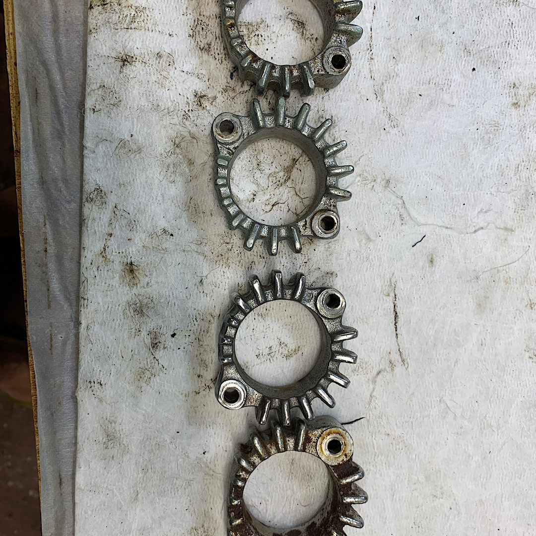

While I’m waiting for some stuff (I’ll be doing that a lot) I’m going through all the bags of parts figuring out what to clean and keep, what to replace, etc. I discovered today that I have a mismatched set of exhaust header clamps. 3 are early style, consistent with the low engine number and one is the newer style. This gives me 3 choices.
Use the ones I have, perhaps after re-chroming
Find one early style of the correct handedness ( they are lefts and rights)
Get a whole matching set of new style ones.
I’m leaning toward finding the 4th matching clamp but whether I can find one remains to be seen.
Ugh. I’m trying to keep it pretty original but it’s not easy.

Those exhaust rings will clean up nicely. There may not be a need to rechrome.

I just bought a set of flanges from Ebay, I'll see how all the chrome looks.
