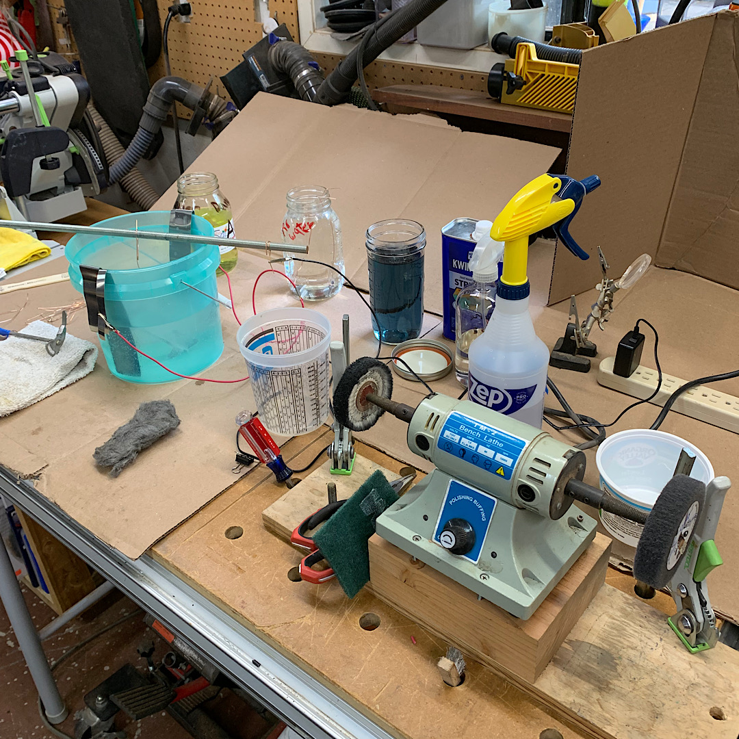

Aloha allI’ve found a 1973 Z1 here on Maui. Build date was 10/72. The bike was in rough shape, missing many parts and not running. It was originally sold in BC Canada and brought here by the second owner many years ago (I bought it from him). He lost interest and moved on to Harley Davidson, which comprises most of the motorcycle scene here. A few years ago I restored my K3 750 Honda I bought from the original owner, it was a fun project. I didn’t think I’d do another vintage bike but here I am. I have a three going over at the SOHC forum and I’ll keep this one going too.Right now I’m on hold waiting for carb parts so I can run the engine prior to taking it apart, the parts are some hard to find stuff coming from Germany. I’ve removed a lot of the peripheral stuff and started on painting small things. I use POR15 for most of the black things, the frame will be done that way after media blast. The motor will get VHT black after what promises to be a difficult paint and corrosion removal process. I won’t be doing any media blasting on the motor, it scares me.ive been finding as much NOS stuff as I can, so far I’ve sourced fenders, the grab rail and some small stuff, none of it cheap. Being that I am here on Maui in our marine environment I will be doing some things to help slow down the effects of our salt air. The final goal will look like a UK market Z1 with the green and yellow colors. I have the original tank but it was severely damaged in a divorce dispute (I think). I have a long way to go including taking the engine apart to check it out, it was bored first over in 2009, I spoke with the machinist that did the work and I think it will check out ok. The exterior work has been found to be lacking, I’m going to go through all of it. I’ll post a few photos here including one of my K3, I call it “stock ISS” because it’s a 73 in 70 livery since that’s what my K0 1970 CB750 looked like back in the day when I bought it (in 1970).

I'm doing some small parts plating trying to keep it as original as possible. There isn't a plater here and I dread shipping a box of stuff to get lost.
I also have done some rust removal in a different bucket, takes time but works well.
