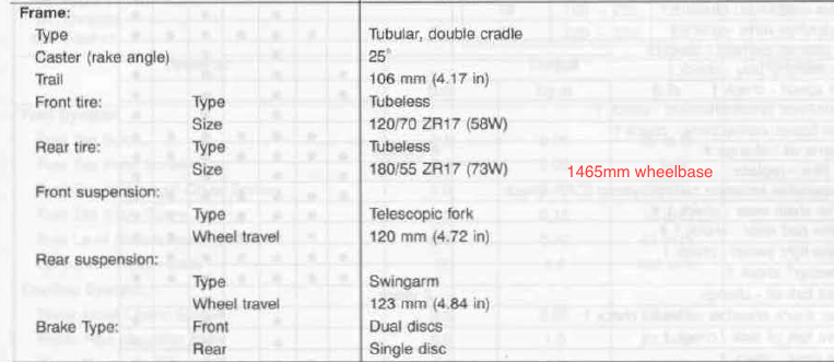

These ZRX 1200 dims are all I have. I believe the 1100 has a slightly shorter wheelbase and some other small changes. These numbers are what I based my target on. I rode a friends ZRX1200 and was impressed with how it handled. I figured that was a good goal to aim for since its overall design and construction is similar to the KZ.
