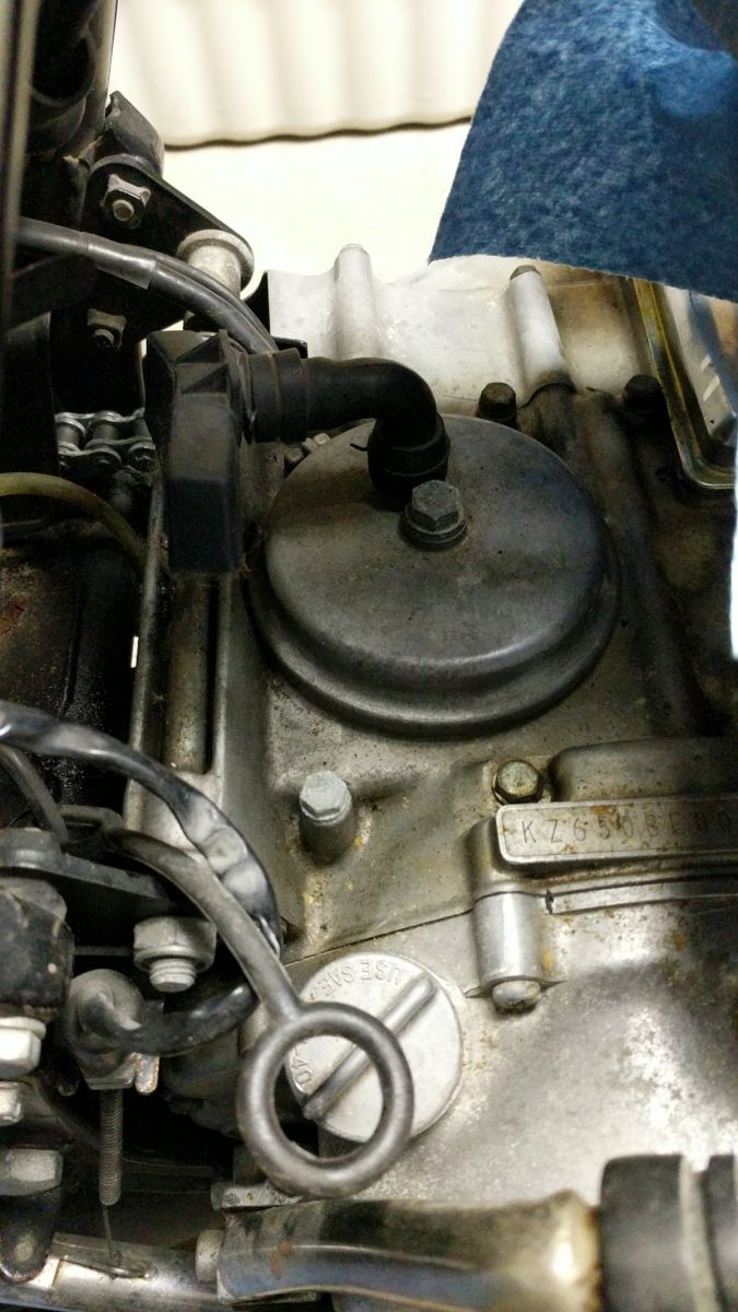

Thanks guys, will follow that advice. Also, can someone identify this for me? Don't even know how to look it up but I've tried and went through the Haynes manual but no luck...

If your question is about that little "L" shaped rubber tube it is Kawasaki part number 92059-137. It is the "Breather Tube." It should connect the stock airbox to the breather cover. Your photo shows it attached to the breather cover, but of course there's no airbox in your photo. Its purpose is to allow the gases from the engine, which likely contain particles of oil, to be drawn through the airbox then through the carbs so they are burned in the engine.
If your question is about the little rubber loop shown near the oil filler cap, that loop is for the carb fuel overflow hoses. Those hoses are routed from the bottom of the carbs through that loop and they then exit below and behind the engine toward the ground. That way if any excess fuel flows through them it will land on the ground not on the engine. Ed

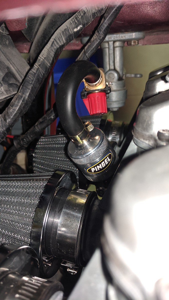

Thanks Ed! I meant the L shaped item but good note on the other piece too. So I've seen examples where people route the breather cover through a hose toward the back of the bike. Others use a POD. Is there a preferred way? The hose seems to make sense to me.

29 Oct 2019 10:12 - 29 Oct 2019 10:12650ed wrote: The preferred way is to attach the breather hose to the airbox, this is why the professional engineers at Kawasaki designed it that way. That way the vacuum inside the airbox when the engine is running draws fumes through the hose and then into the engine. Running a hose any other way will result in oil laden fumes venting onto the rear wheel or other parts of the bike unless some type of catch can has been attached. Ed
Thanks Ed. Yes I understand that the stock airbox would have been ideal but unfortunately I don't have it

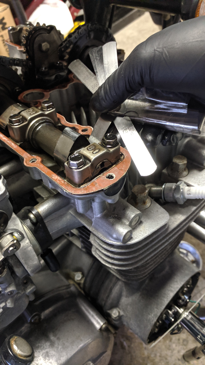

I have completed my valve clearance checks, my haynes manual shows that I should measure when the top of the lobe is up and slightly tilted toward the bucket (when lined up with the cam gear indicators). I used this method and found all the lobes within clearances so that was awesome!
I searched for a while and I found so many versions of measuring. One where the lobe is directly perpendicular to the bucket. Another where the lobe is perpendicular to the valve cover, another where it's parallel to the valve cover. I went with my Haynes manual but I recorded all the other measurements just in case. Replaced the gasket as well.

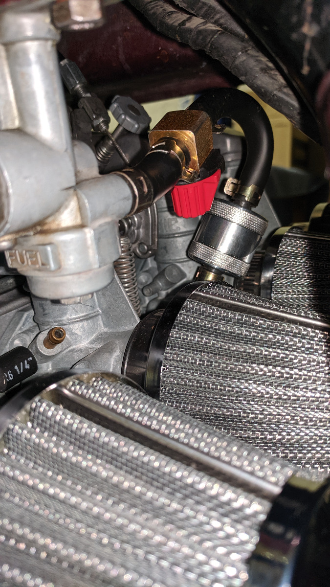

After cleaning the tank and putting gas in, I might have damaged my petcock or something because it's slowly leaking in the off position. A drop every couple seconds roughly. After a day of the tank sitting there there's a nice big gas puddle, my garage smells great :pinch: Trying to source a placement petcock (part number 51023-1023) as most people seem to think a rebuild is no use most of the time. Other than the slow leak from the fuel line, there's no other leaking as far as I can tell. Is it fine as a quick and easy fix to add a fuel shut off ? Any issue with this just being a permanent solution if I can't get a replacement petcock?
I'm sure I'll find one eventually but just curious if it's a decent enough workaround.

Rebuilding the petcock is a perfectly viable solution as long as there is no internal damage. In fact, with the ethanol-laden fuel most of us have to put up with, rebuilding is basically a part of routine maintenance.
If the sealing surfaces are not pitted, a rebuild should fix the problem. I always polish the face of the lever and also the seat that the little o-ring, which is almost always the problem, seals against. A little time with some good aluminum polish will do wonders for the valve.

A rebuild kit for my petcock would take a week to ship and was about $50 incl tax and shipping. Local store had a MotionPro fuel cut off that was pretty good quality for $25 so I decided to grab that even if it's just temporary (figured it's good to have around anyway). I'm inquiring about a replacement petcock from a friend as well so hopefully that comes through. For now I routed the cut off.
