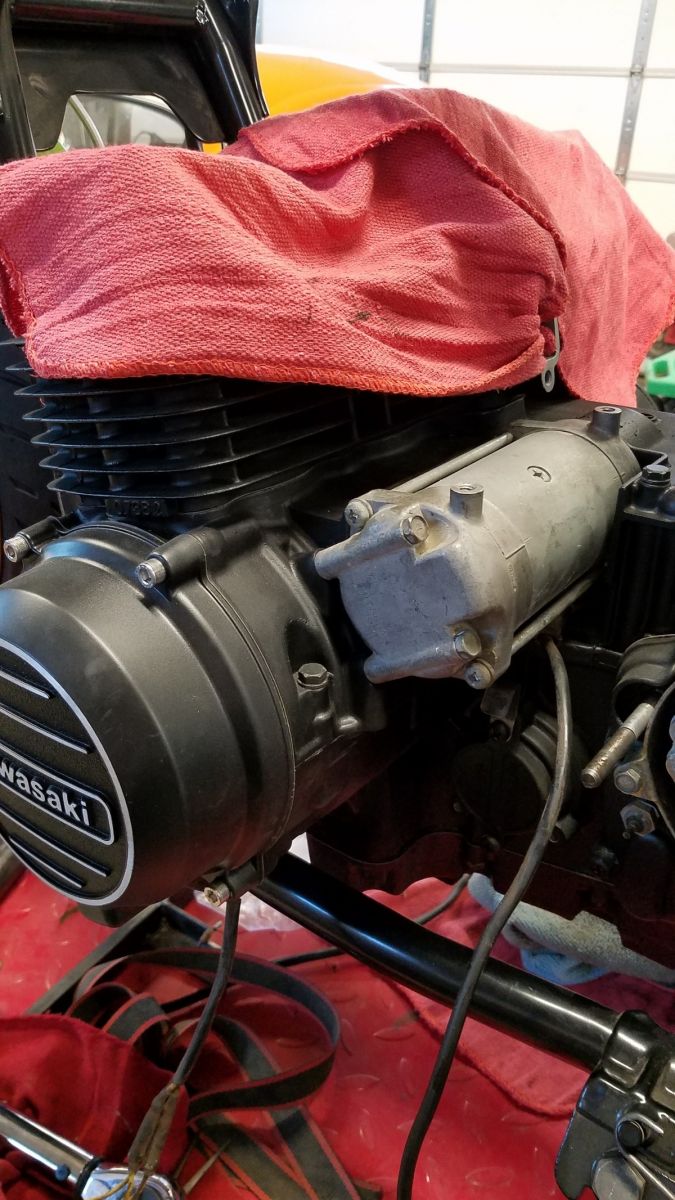

Re: Saving a '81 KZ750-E
25 Nov 2020 16:49

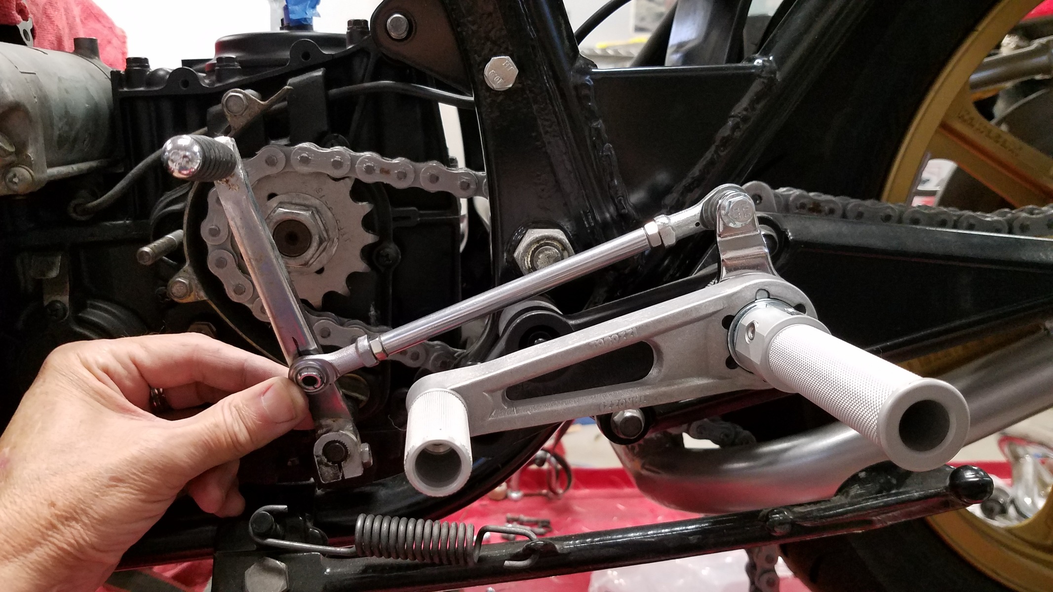

The o-ring arrived today, so I got the starter installed.
I started to fabricate the shift linkage. I will need to cut down the stock shifter to the right length and drill a hole so I can bolt the linkage up.

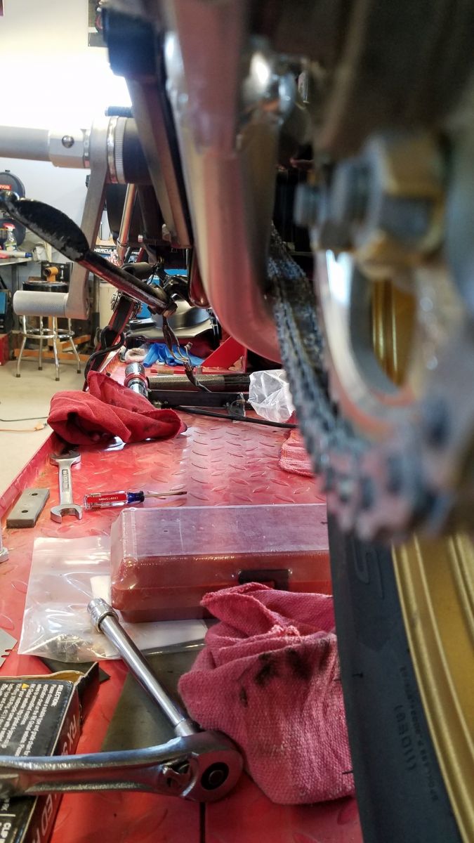

25 Nov 2020 16:54

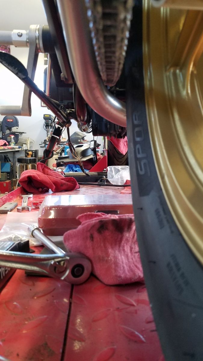

I also started to fit the chain in place for the first time, and as I was fearing it interferes with the swing arm gusset I made. I will need to pull the swing arm and clearance it. The chain looks like it won't need a huge amount of relief in the tube wall.

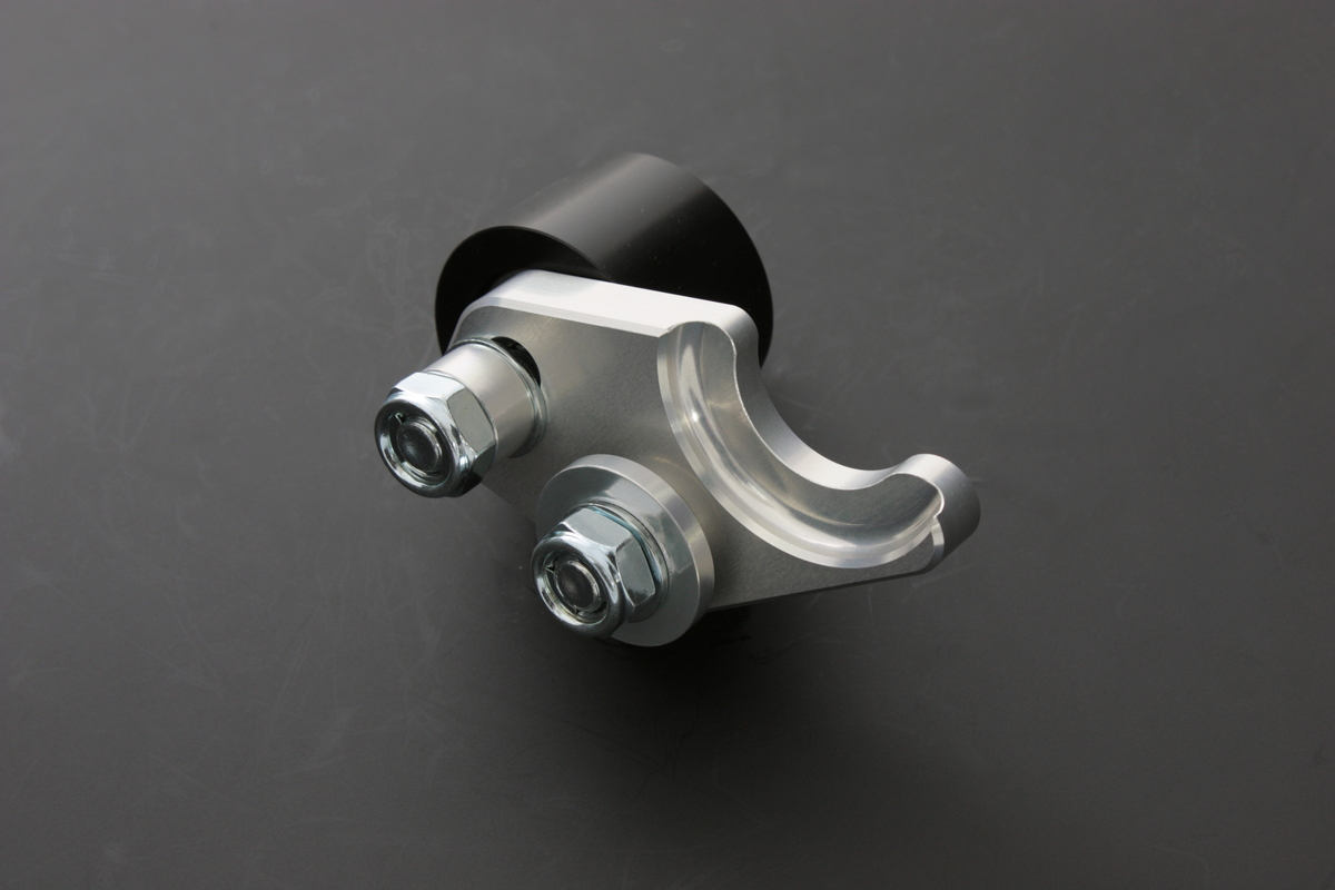

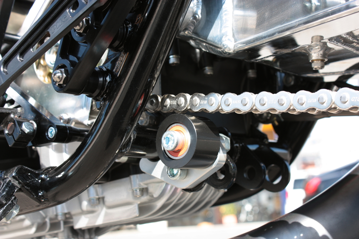

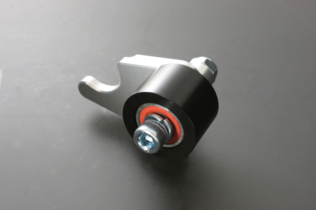

- Thanks: 2260
26 Nov 2020 04:40
26 Nov 2020 07:57 - 26 Nov 2020 07:58
My chain clearance issue is on the side of the chain. That set up looks like it would control the vertical clearance, not the horizontal. Thanks, though... I will post some pics of the interference to make it more clear.
