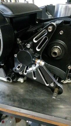

Nice job on the actuator cover....very nice!
Kawboy74 wrote: As mentioned a few days ago, I am posting the picture of my hydraulic clutch cover with the Yamaha slave mounted. The spacer setup allows me to move it closer by shortening them if need be as I haven't determined where the chain will run on my frame. I will likely need something around 3/8'-1/2" for a 180 sized tire on a zx600r rim. I had the face of the slave flattened for something I intend to insert there later. The clutch rod can be determined later and if longer than stock is needed can be made from 1/4" rod. The bottom hole where the shift shaft passes through has also had a bearing installed for smoother operation.

16 Apr 2016 19:45Kawboy74 wrote: As mentioned a few days ago, I am posting the picture of my hydraulic clutch cover with the Yamaha slave mounted. The spacer setup allows me to move it closer by shortening them if need be as I haven't determined where the chain will run on my frame. I will likely need something around 3/8'-1/2" for a 180 sized tire on a zx600r rim. I had the face of the slave flattened for something I intend to insert there later. The clutch rod can be determined later and if longer than stock is needed can be made from 1/4" rod. The bottom hole where the shift shaft passes through has also had a bearing installed for smoother operation.
David
That's bad ass, thanks for the info.
