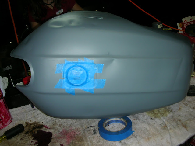

18 Nov 2011 22:25 - 19 Nov 2011 09:44
Got the tank coated, with Red Kote and it came out pretty good. Pretty simple process. A couple pieces of advice for anyone wanting to do it. Do it in an open area, the fumes are super strong, and they tell you to use two quarts to start with and drain out what doesn't stick, but I can tell you for sure that a single qt is plenty for our tanks.
Now I know why they call it Red Kote!!!
Slosh and sit.. slosh and sit... very exciting stuff!

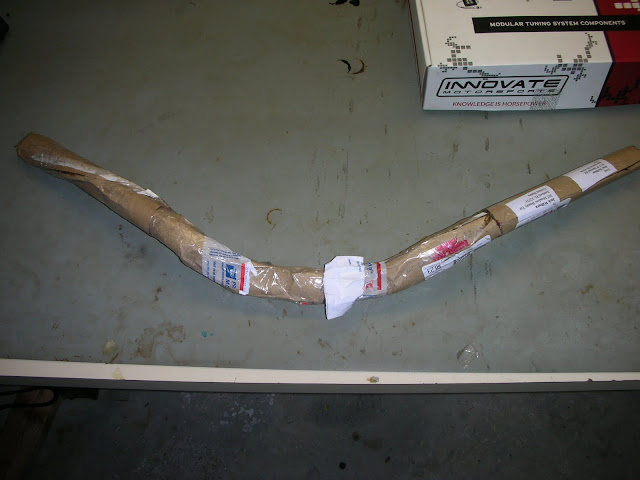

OOO and I got in some new toys!!
I have no idea whats in this package!!
O Yea!
Gonna be bench testing this and start playing with it next week! Can't wait.
I guess the cat is out of the bag!! Yes, I am FIing it...
O Yea!

Re: 1982 KZ1000 to Fighter..
20 Nov 2011 21:17
No guesses, really! Didn't think it was that hard, lol
