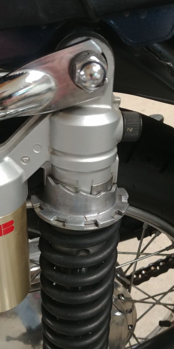

Replied by Kidkawie on topic ZRX1100 shocks on a Z1?
13 Mar 2020 08:40
Im going to be taking these apart in a few weeks to shorten them a little, but Ill describe whats already been done.
You remove the stock spring prelosd "pin" and use the housing instead. The problem is the inner sleeve is only held in by friction now. I welded the inner sleeve to the outer adjuster ring. The left side shock is spaced out with a couple washers for clearance.
My plan is to install a limiter (like the last pic) to lower it about an inch.

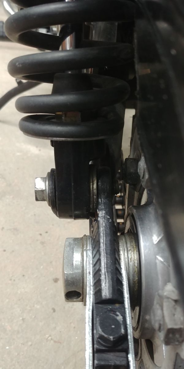

Replied by 2wheelfiddler on topic ZRX1100 shocks on a Z1?
12 Mar 2020 19:06
Hello Kidkawie,
I have a 78 KZ1000 LTD on which I've installed a set of ZRX1200 shocks like you did.
I noticed my chain rubbed on the swingarm since doing the swap and I noticed on your post you have pictures that seem to show you modified the top preload adjuster.
The photos are blurry so I'm not sure how you modified them, could you send me pictures?
Thanks!
Thanks!

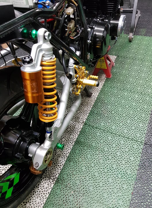

Replied by foxkawa on topic Gpz750 1982 will be a Eddie Lawson replica. Almost :-)
15 Jan 2020 07:41
With the zrx swingarm the suspension will be wider then stock so i. The new shocks had 14mm ID had two bobbins for the swingarm and drilled a larger hole so it fits the upper shock bracket. The new shocks has 14mm bushings so i took a tube who had m10x1.25 inside . I turned off the outer diam from 20mm to 14mm except for 3mm . Now i have a nut that fits perfect in the upper hole on the shock.
Sorry for my english
