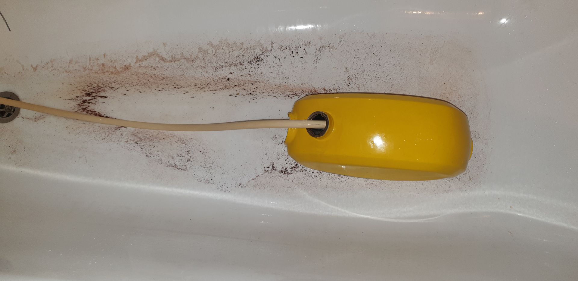

I use only POR15 since decades to repair, de-rust and seal fuel tanks.
www.por15.de/Fuel-Tank-Kits:::15.html
Used a POR15 10 liter kit on a classic moped tank a few days ago.
If you follow the ikit instruction you will get superb results like me.
Picture shows the first step, degreasing the tank. A lot gung and rust flake covert under the cracked fuel and oil layer dissolved.

Photo looks like the tank is in the bathtub --- hope you finished the job before your wife got home!!!
