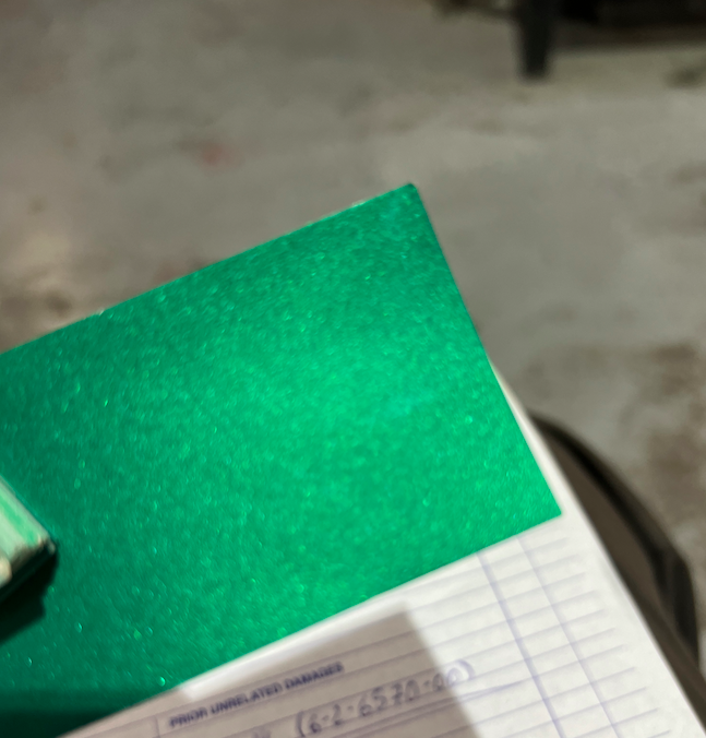

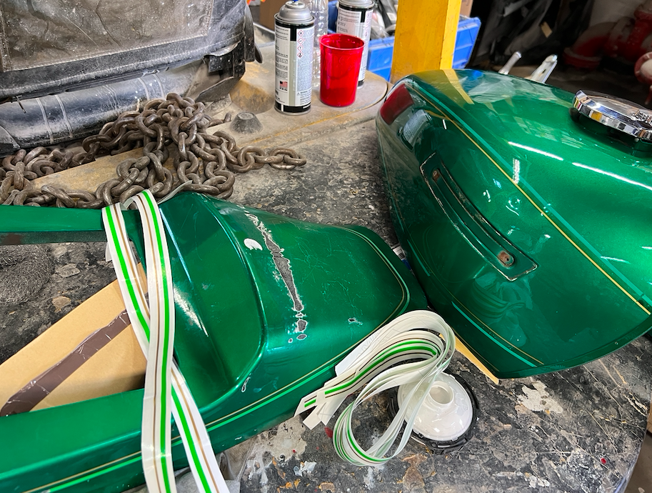

Well I dropped off the tank and fairing. Apparently it will be ready by Thursday!
This shop does EVERYTHING. They mix the paint on premises, have high tech paint booths, etc. They are so good they have government contracts to paint, planes, trains, and automobiles.
So. they will use two stage urethane. I wanted three stage, but for $600 Im not going to argue.
I was SHOCKED that they pulled from their color palette option, the EXACT emerald green of 1977.
You can see it below.
BTW, like Nessism and SO many others tried to tell me (im hard headed and obnoxious and for that I apologize) they are going to put the pinstriping UNDER the clear, not over.
Below is a photo (a poor one) of their color match with flake/pearl and when I dropped off the tank:
