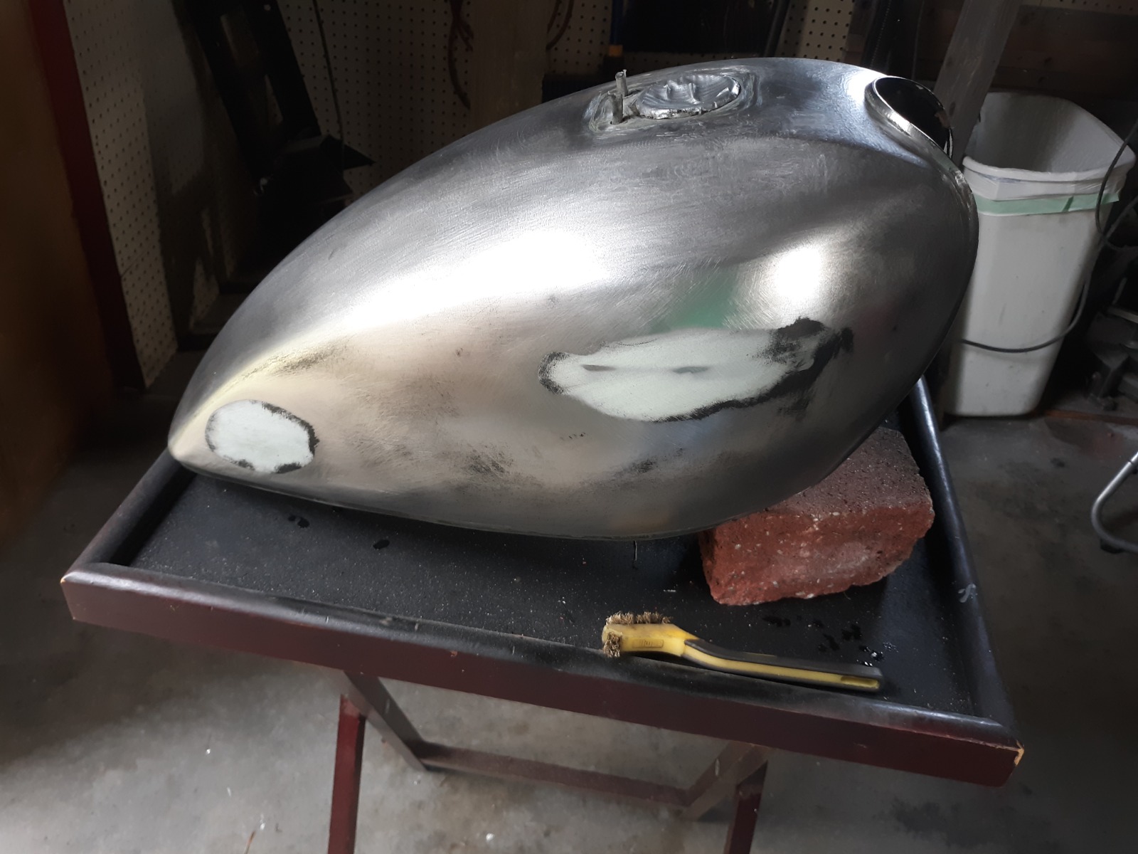

I've got a few dents that will need filler. I'm taking the tank all the way down to bare metal. Do I use self-etching primer or epoxy & do I lay that before or after the bondo?

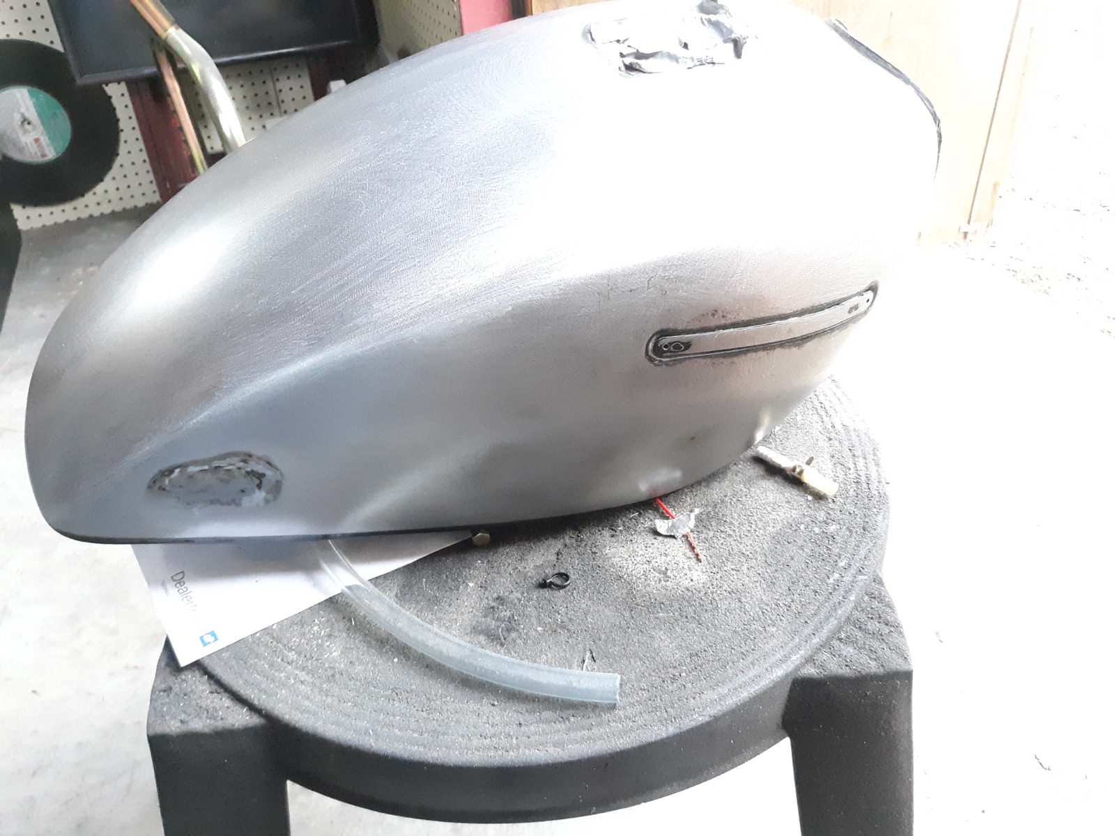

Here's where I'm at...watched a few videos on using guide coats, foam blocks to sand contours, etc.dents are filled but for the tank badge bracket, should the bondo be spread out a bit further? I can just make out the top edge & one end of the bracket but I don't feel them. Everything feels smooth, no ridges or obvious low/high spots but I've never done this before. The black is what was left from spraying a guide coat.

After the bondo/primer I do the same as Nessism and put a coat of fill primer on then sand and repeat until the transition disappears.
