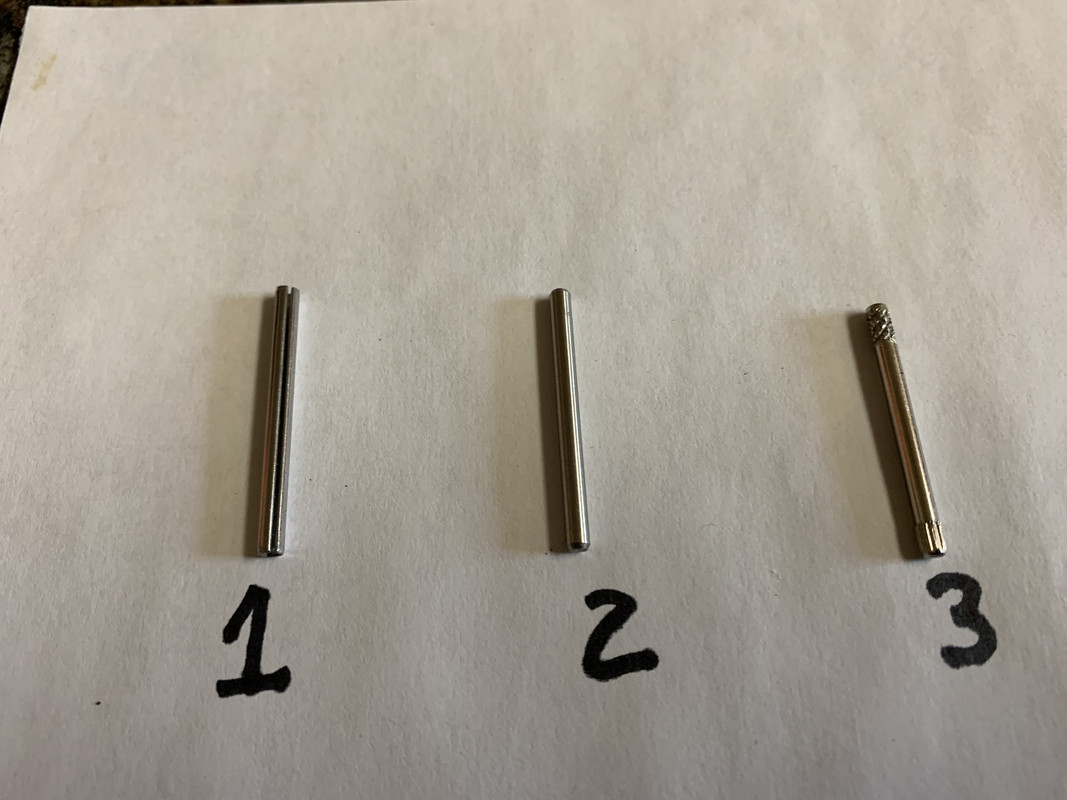

I could use some help with this guys if you would be so kind.
Before I start driving these pins in above my freshly painted tank I need to know where each one goes. I'll post a pic of what came with the cap,It came with three pins shown below, #1 is a roll pin, #2 is a solid pin just a tad shorter than the roll pin and #3 is a shorter pin that is knurled on one end and serrated on the other end.
It's my thinking that #1 is used to mount the cap to the tank and #3 is for the other end of the cap for the latch to grab if so is the #2 pin just supplied to help drive the pins in place?

20 Apr 2023 08:28
The below might be helpful Moose (Alan Milyard shows how)
Kawasaki Z1 Super Six - Tank and Panels - YouTube

20 Apr 2023 09:04
Thanks Wookie, Unfortunately that's for the locking cap that needs only one pin the cap I have is a repop Z1 cap with no lock just a latch.
