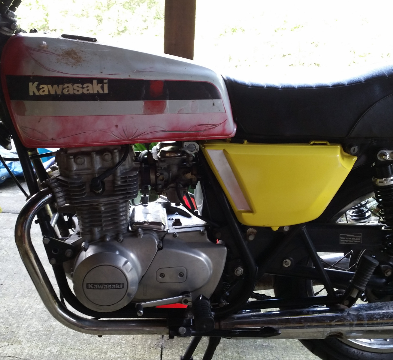

The tank from a KZ550 (or '81 GPz550) will fit, though I don't recall the capacity offhand. This is an experiment I did a few years ago.

That looks great! Is that the stock 440 A-1 stepped seat? Do you remember if the rubber mounting donuts(?) were in the same place as the bike ... tank or frame? I really appreciate you taking the time to respond to me. Thank You!

D'oh! I'm sorry - didn't see that you have an A model *and* I managed to mix up 440 and 400.
That's a '79 KZ400B: it has a flat seat. However...
I didn't do anything to the rubber mounting dealies on the bike or anything to the tank - just stuck it on there. The clubman bars did not appear to be an issue lock-to-lock, but I must mention that I did not ride it like that.
If I can get into the workshop this weekend, I'll try that same tank on a 440 LTD (belt drive) and see if it fits.
