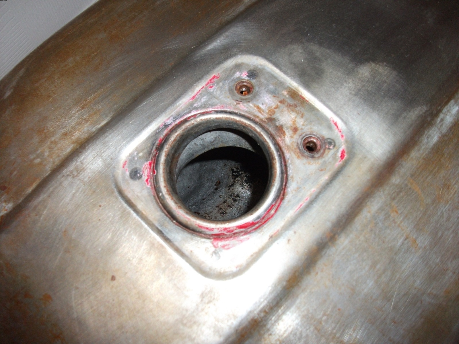

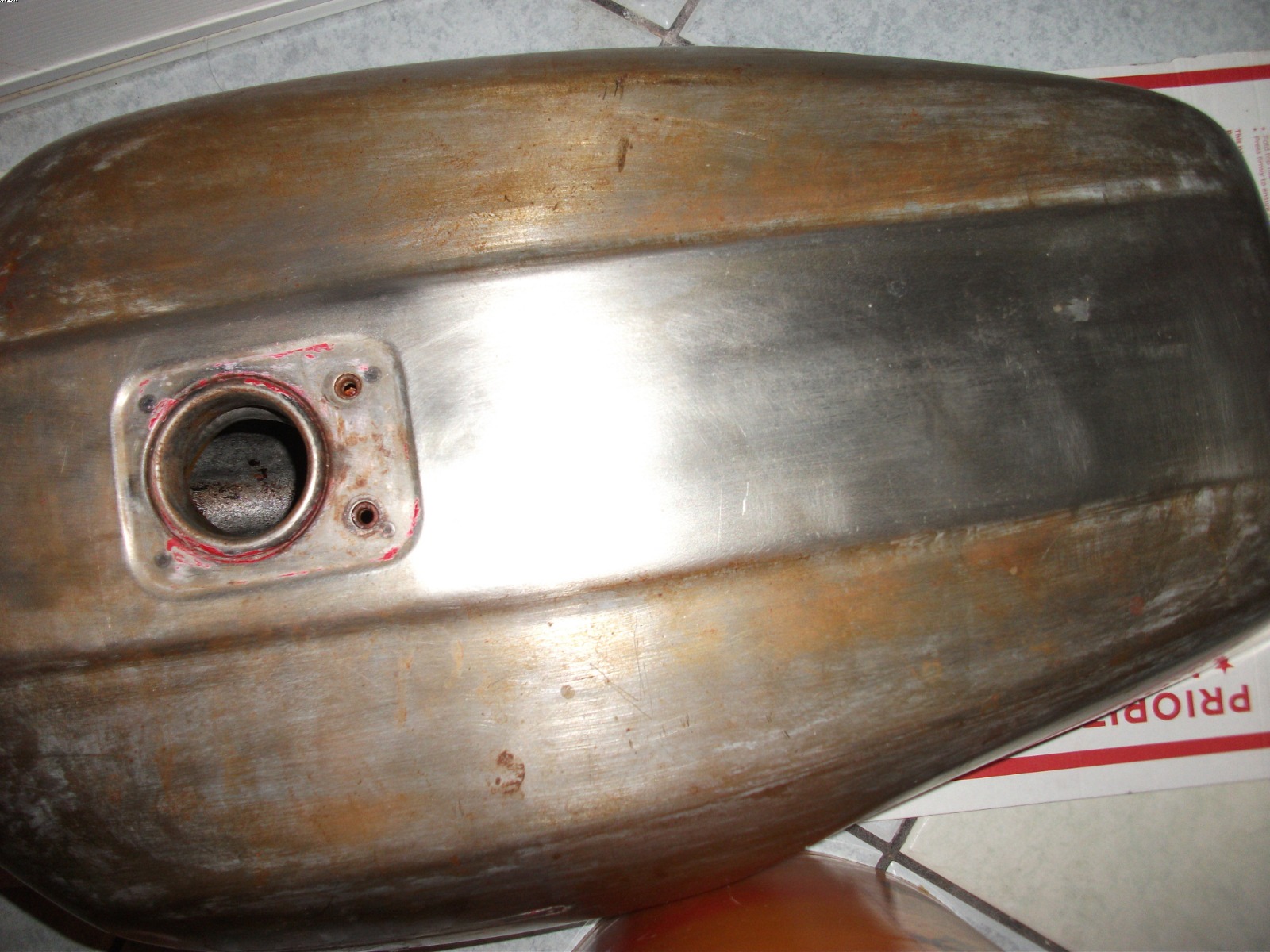

I've used this product for years and am currently restoring two gas tanks.

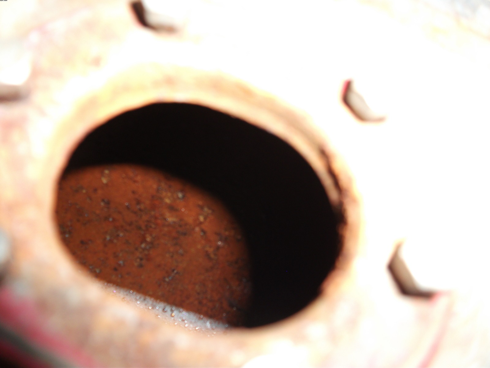

The first pic shows how much rust was inside the tank. I poured 3 gallons of Evapo-Rust into the tank and moved
the tank to different positions for a couple of days. It removed all of the rust. There are some black stains inside
the tank but it's cosmetic at this point. I'm waiting for a Caswell epoxy gas tank kit to come in.
I've derusted a lot of GPZ1100 parts with just three gallons. The liquid is totally black but it is still active.
The pic of the top of the tank shows the center shiny and free of rust. I dipped a maroon Scotchbrite pad in
the heavily used Evaporust and removed the rust from the top-center of the gas tank in less than 3 minutes.
This product is amazing and it's biodegradable.
