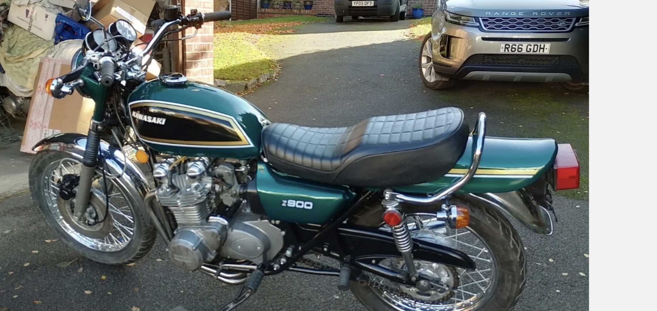

i bought the Z900 as a partly restored bike, most of the work is not to my standard, so have fully stripped it.
frame and all chassis parts have been blasted then powder coated, engine fully stripped, all parts checked, then vapour blasted, carbs stripped, cleaned, all rubber replaced. Forks stripoed, new stanchions, seals oil etc, needle roller swinging arm kit, new 4 into 4 exhaust system etc. Clocks refurbed, new faces, glass, re paint, basically everything. Its cost a fortune so far.
The paint whilst ok is none standard and needs reverting to standard.
colours of Diamond dark green. Had a good response from Ralph but of course hes US Based, which doesnt help.
I was contemplating spraying it myself as have sprayed car parts before, mainly to save cost as being retired money isnt in abundance. the prices ive been quoted are i think very expensive. It seems you can have 1/2 a car sprayed for far less then a tank and panels. Also none of them have heard of the Kawasaki colour or that its a candy all they seem to want is a sample to match or paint code which i have neither.
The post i saw where the guy sprayed his in duplicolour cheaply looked good to me, id be more then happy with that finish. Photo as is now.

What's the aim? To get it back to stock? Lots to do / get if that's the aim. Tail light looks to be off a later model that had a squarer tail piece, J model maybe? . Rear shocks are wrong. Fork gaiters need to come off. Headlight ears should be chrome. Indicators appear to be repop for tripple era bike. Grips and seat are wrong. Needs 4:4 exhaust.
Idiot lights are earlier model style.
I have a 100% original survivor 76 if you need reference pictures.

Hi yes as near as possible to stock, already sourced a lot of needed parts, tail light, fork ears and new stanchions to get rid of garters which were hiding rust. Sourced brand new 4 into 4 exhaust full system, new centre stand , grips, foot rests etc It will never be 100% but will be near enough, however the paint is ok but stripes stuck on top and not lacquered, to be honest looks a little amateurish, needs to be back to original.
