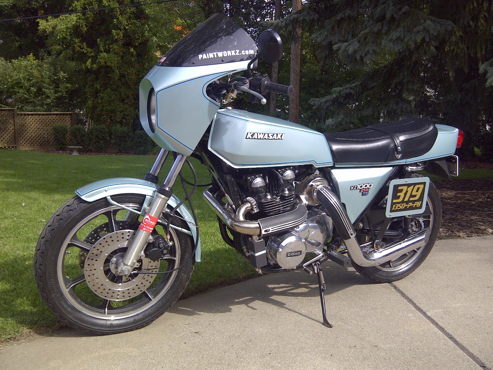

- PaintWorkz
- Posts: 376
- Thanks: 70
Re: Redoing Z1R
25 Nov 2019 08:28
Zero Gravity sells a decent replacement, tint is a hair darker. I bought a couple seconds off their eBay store a few years ago......I could not figure out what the blems were.
