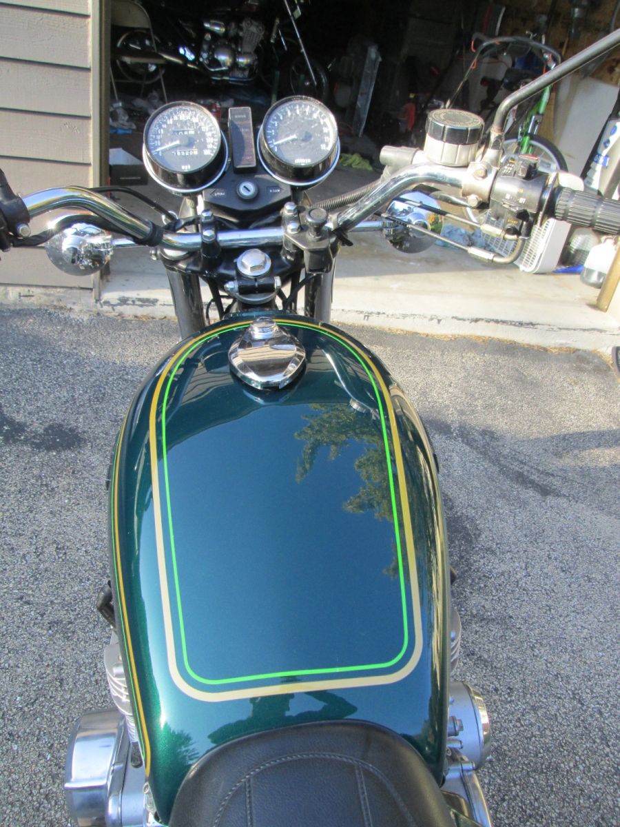

Here's the finished product. I thought it was perfect but looking at it today I think it's favoring the right side by maybe 1/8th to 3/16ths. Took me long enough to notice it so I can live with it. Better than the last one I did anyway. (2nd pic is first one I did)
