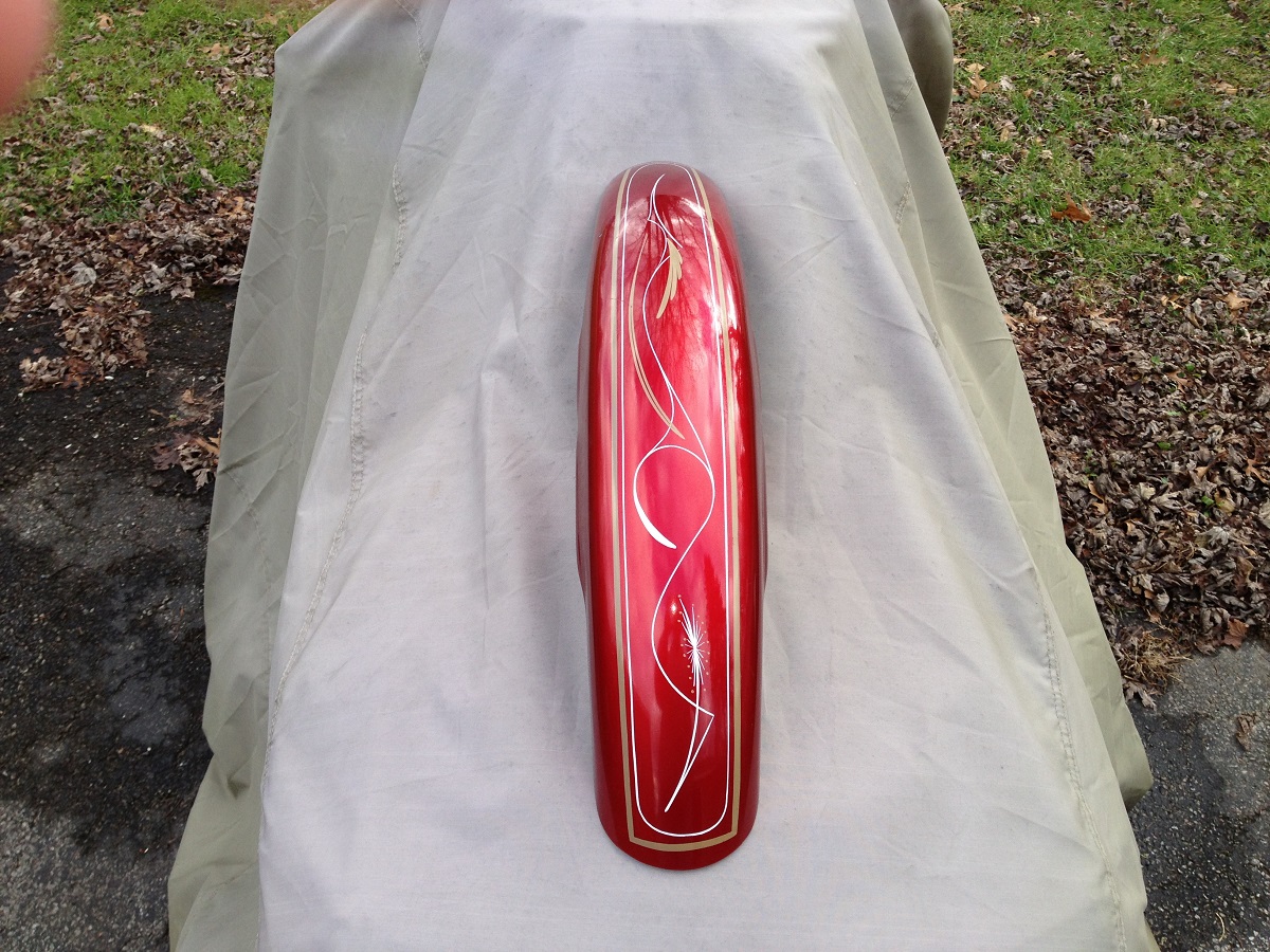

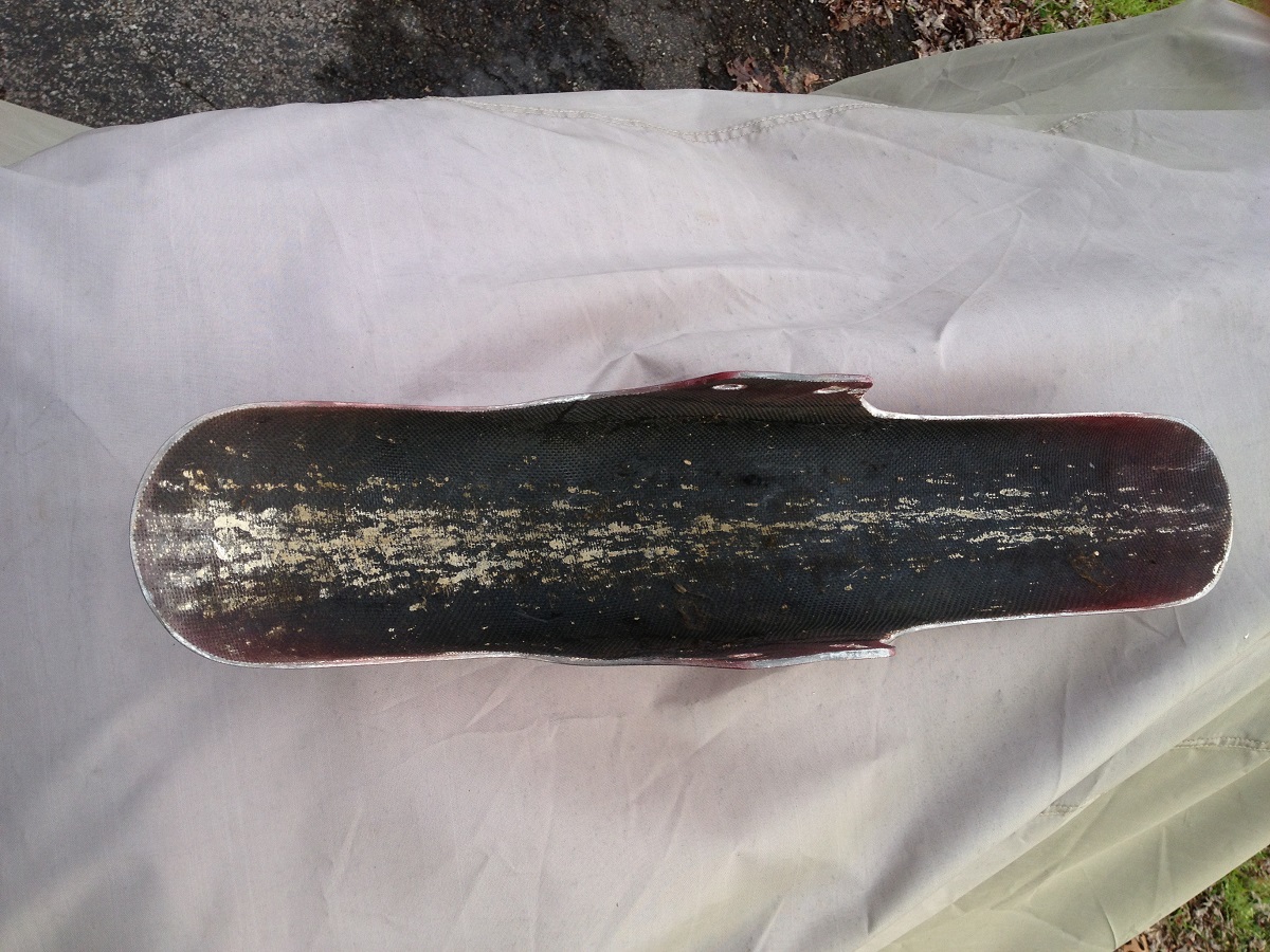

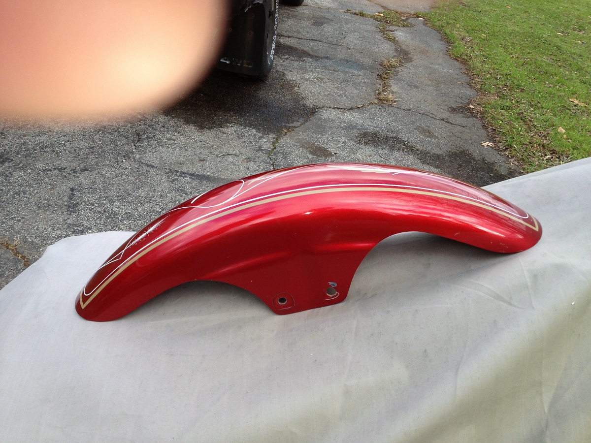

I sent this fender to one of our members that wants to paint it black, & he asked me if I thought if he could remove the paint with Chem strip
I told him I havn't got a clue, any suggestions ??
Pete
Pete

Negative on the paint stripper. It will eat into the resin binding the fender together.

I would just sand it down, that will also give it a good surface for the paint to adhere to. The original paint looks fairly decent so it might not even need to be completely removed, getting a smooth surface would be the most important part.

He can sand it with #150 then #320 and paint it followed wit #600 between coats.

No stripper! it will eat into it.
400 grit wet sand, keep it wet. Ready for primer "Steve! he's not sanding wood!"

If no deep scratches, he can skip the coarse stuff.

150 on a DA sander is about right. Buzz off as much of the paint as you can. Painting on top of old paint results in too much film build that's prone to big chips.
