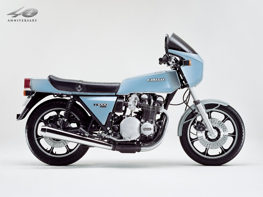

Anyone have any experience with the application of decals/transfers to tank/guards etc..
I've got a pinstripe decal set for my '78 Z1-R and would like to know any dos/don'ts/hints.
Particularly - do these require activation of the adhesive or are they just "peel and stick?"
Not sure what brand these are or if they're OEM - they came with the bike when I bought it.
Promo pic of the bike for reference
