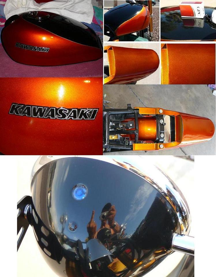

22 Jun 2012 23:24

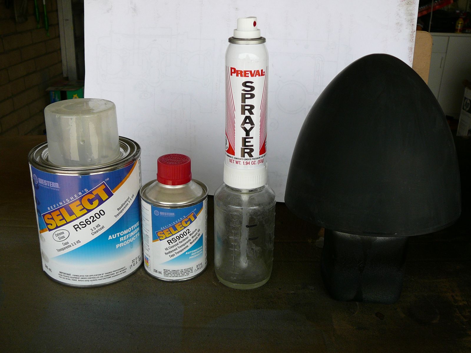

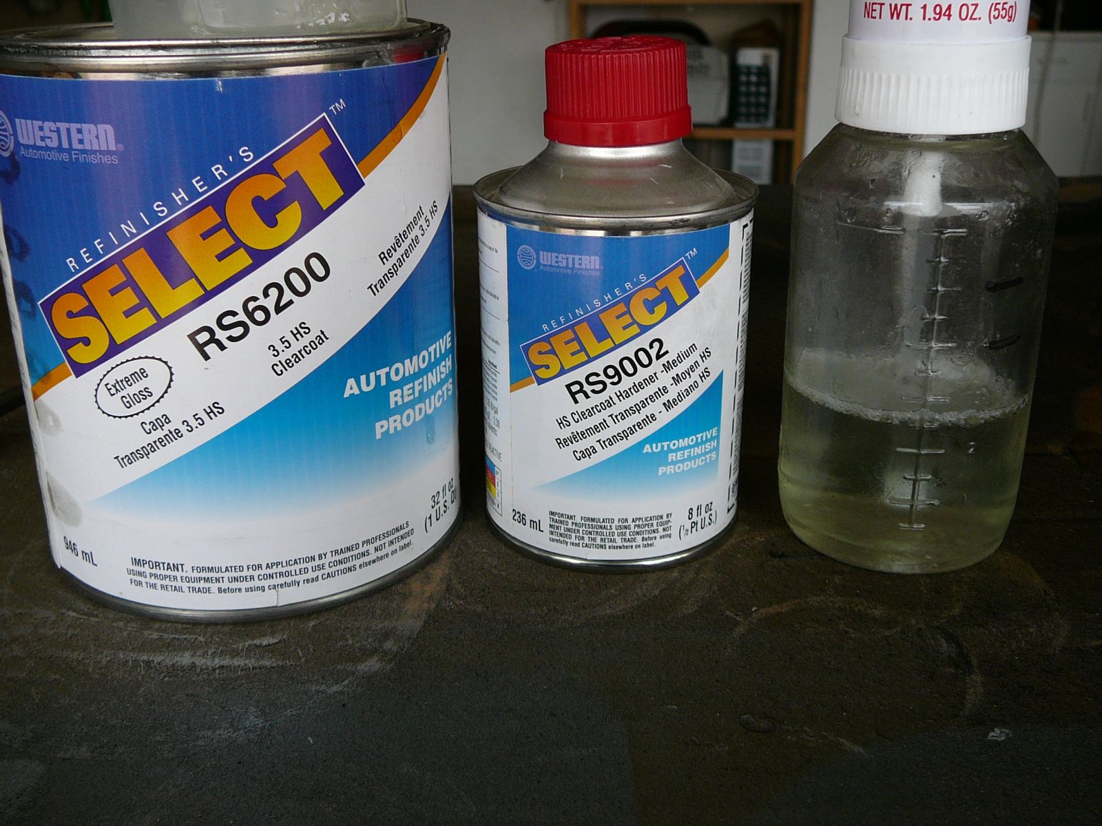

Here's a write up for painting chromed head lights.... Same process for plastic side covers using adhesive promoter... The tank, same process with out promoter...
can painting...
For the Prevail unit, home depot, ACE hardware, Lowes etc all have them... It's actually rather cheap.
2 part clear, I got mine @ Sherwin Williams automotive paint stores, several here in Phoenix valley.... for both 2 part clear ~ $60.
The key is you can use about any can automotive paint but as mentioned, none will hold up to fuel without a clear coat applied... The clear is what is protecting the paint from fading, fuel spill, chipping etc...
