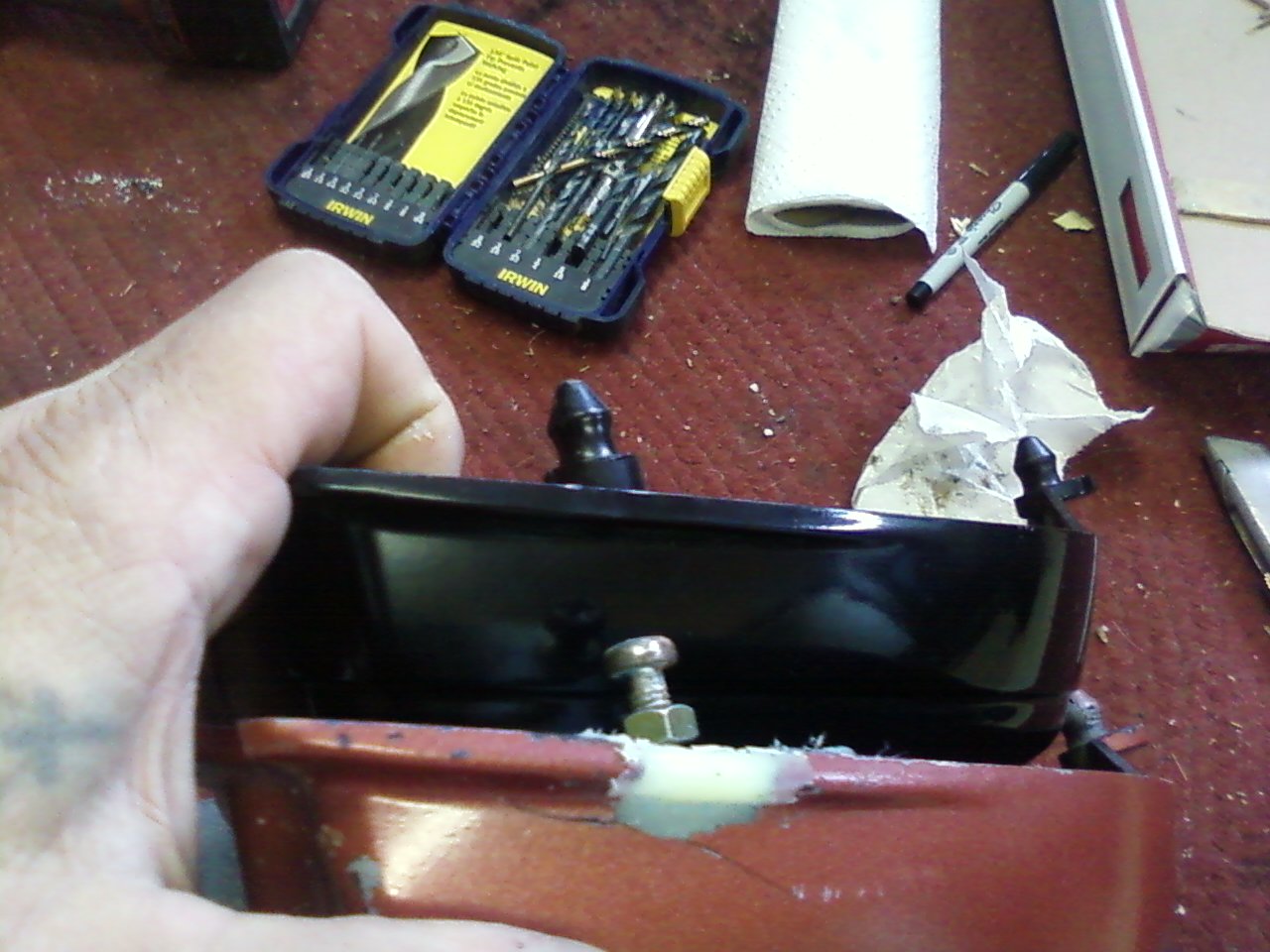

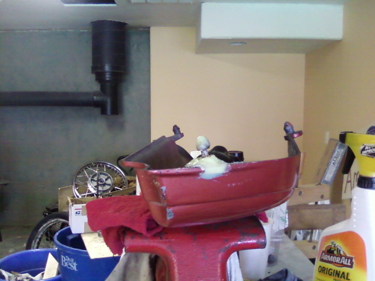

OK, I went to the Farm and Fleet hoping they had ABS piping and glue, no luck.
They did have this epoxy that has ABS at the top of the list along with steel, so for 3 bucks I went for it.
Guess what, It freakin worked :woohoo:
Here are the results

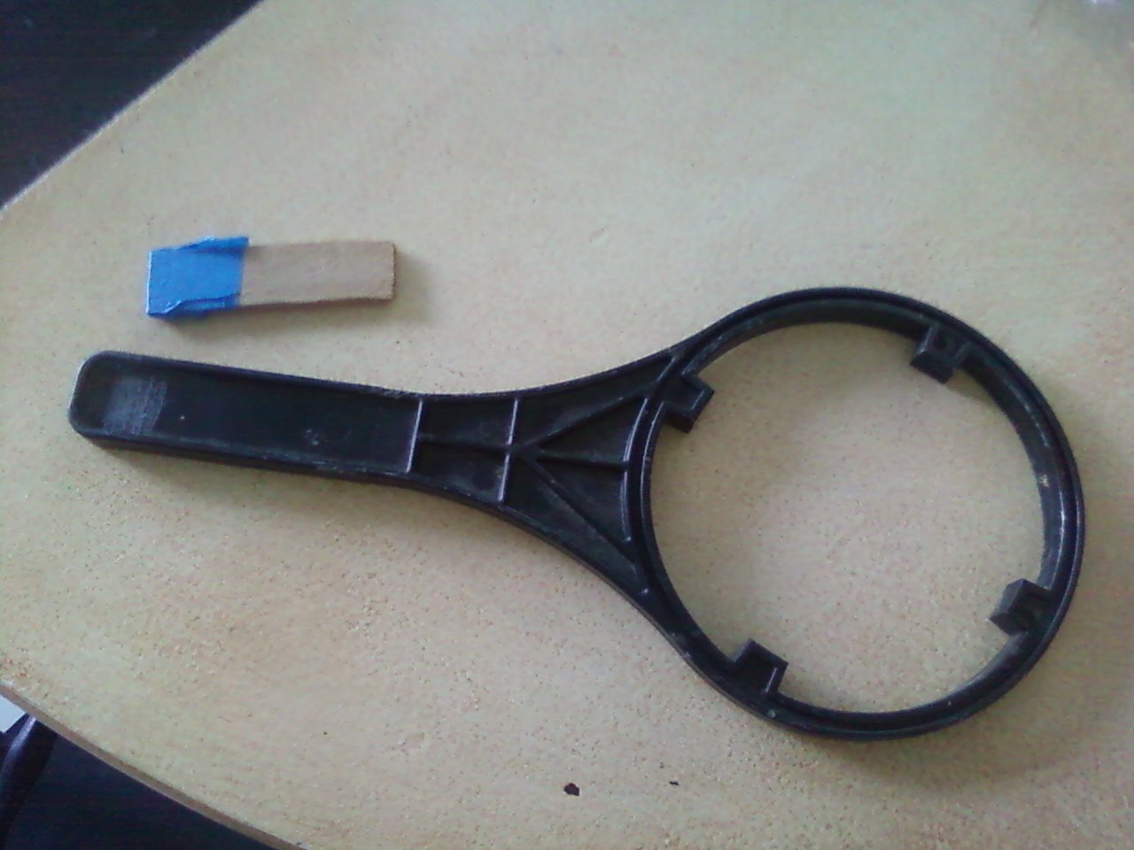

I found this plastic wrench at home and I borrowed the end from, it's hard but I'm not positive that it is ABS, I used it any way .
I filled the underside with epoxy and cut it off
I tacked the tab in place with a couple small dabs of hot glue.
I used my spare black side cover to make impressions in the card board for use as a template .

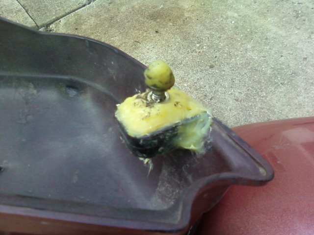

- bluej58
- Posts: 2474
- Thanks: 507
Re: Side cover repair
16 Jun 2013 21:57
Hey Joe, it's holding up very well, 9500 miles so far.
There is no flex to this product though and if you are using it for a crack I would back it up with a piece of ABS or some other material that they say it will stick to.
Please document what you are doing if you can.
JD
