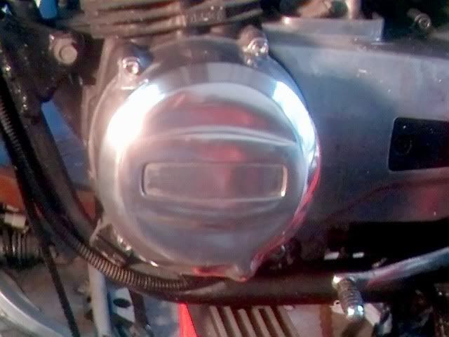

I don't know specifics about your swingarm. But, I've had really good results from "Mother's Alminum Polish"
The two covers were really yucky before. They look better in person than in this picture. The clutch cover is reflective enough to see myself in. But, it doesn't show on this picture. I wish I had a better pic. But, they didn't look like they had been cleaned EVER when I started and it didn't take long to get them to look really good.

I second the Mother's, pic below is 79 KZ650 that was very neglected, but no road rash, Repeated applications of Mothers resulted in this....

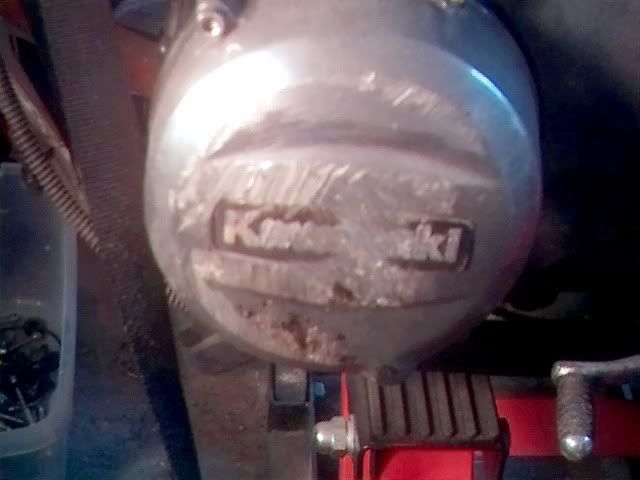

1983 KZ550 after the first crash
i96.photobucket.com/albums/l192/medic24baker/000164.jpg

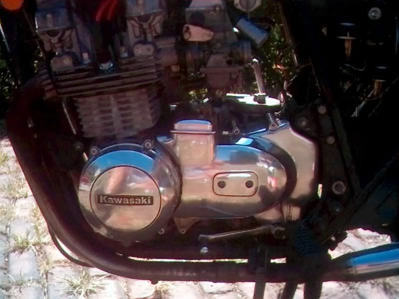

After a little bit of filing, then sanding, wet sanding, then polishing with a basic polishing kit from Caswell
i96.photobucket.com/albums/l192/medic24baker/000166.jpg
i96.photobucket.com/albums/l192/medic24baker/000167.jpg
i96.photobucket.com/albums/l192/medic24baker/000168.jpg
Just some basic supplies, elbow grease/time and beer!
