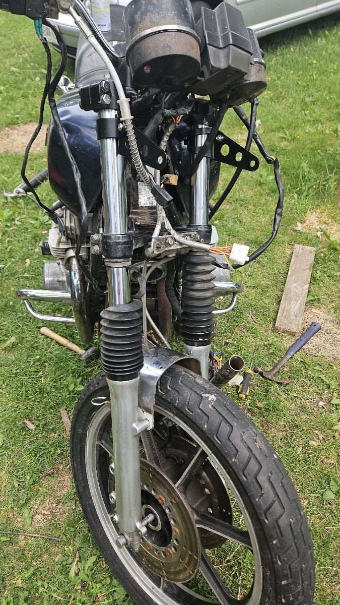

So I swapped the forks on my kz1000 csr for kz1000p forks and now realize that I need the front police wheel to fit the rotors on. While I'm at it i might as well put a police rear wheel on too, right? Wouldn't the stock 3.00x16 rear wheel combined with the police 2.15x18 wheel could cause poor handling? Im kinda scared of poor handling now.... IYKYK
Now my question; for the rear police wheel (2.50x18) would it be too much to fit a 130 tire on? I hear that its possible that the tire could deform to fit the smaller wheel. Im asking because it is difficult to find matching tire sets for the stock police wheels.
If having the 16" wheel on wouldnt cause poor handling, I won't worry about it, but I am currently worried about it.

I did swap the trees also. The lower triple was cooked so I almost had no choice. Now I just have to figure out headlight accommodations. Well sounds to me like I'll be keeping the 16" rear wheel for now unless someone else has something to add.

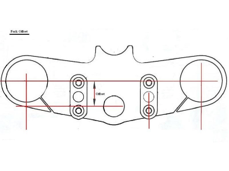

Looks like I was on the money with the stock rear and 18 cop front. If you post the off-set and fork length I will put them into a calculator. The stock CSR/ltd forks are 840mm from top to axle centre, J are 810mm.

Wookie I measured the csr forks, which were lying on the ground, from a direct line of center axle to the middle of the top of the fork, not including the cap. They ran at about 850mm which isnt what you have. Maybe i measured wrong? The offset of the axle was about 30mm unless that's not what you're looking for. The police forks were the same length as the J forks at 810mm.

20 Jun 2026 01:04 - 20 Jun 2026 01:10It's the off set in the tree's that I meant - That is the distance from the centre of the stem to the centreline of the forksTexasKZ you're killing me.. I appreciate the help but a lot of that went over my head. Correct me if im wrong, but are you basically saying that there are a lot of variables at play but in general a cop front tire is really close, like a 1.2% difference so it shouldn't upset frame geometry but tire manufacturer specs upset the difference?

You're right. It would have been a lot easier and cheaper. I guess i just dont view it in that way. I made the decision long ago that this was MY bike and ill just mess around with it. For me it was a game of compromises and I really didnt want the leading axle forks and the same old forks that could have almost killed me, regardless of whether it was my fault or not. Id rather install the ~10 years newer forks with the center axle that I wanted. The "can of worms" that I opened up is the fact that doing this conversion could have potentially made my problems worse or better, I dont know yet
. In a way this is my version of fun!
