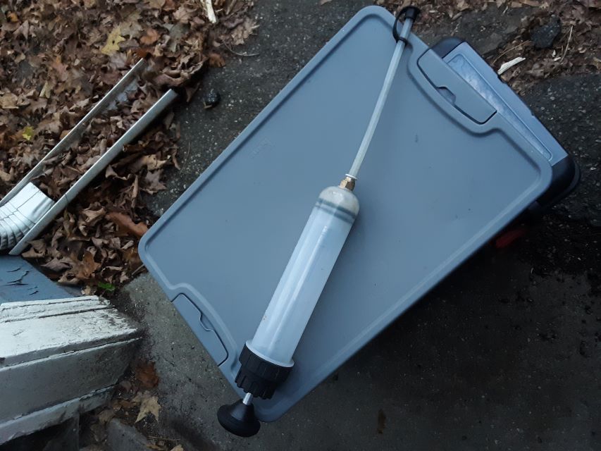

I had the same problem with my front m/c, no matter what I tried. What finally worked was emptying the whole deal then using a " turkey baster " pump I backfilled the entire system from the bleed connection on the caliper. Go SLOWLY and wrap a rag around the master in case of overflow.

01 Nov 2025 19:31
We finally got *some* brakes in it late today. Going to do the lever pulled all night trick. Probably sacrifice a chicken or pig at dawn, hope for the best.
