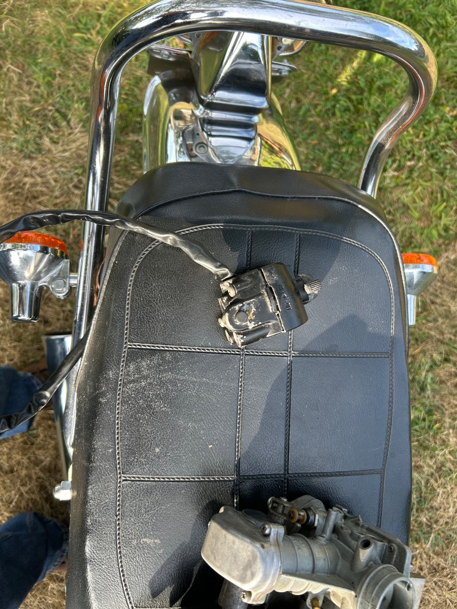

Hey Mr. Belt, changing subject a bit here ,but this is your thread, a few things you might be interested in
right side control with button, from my 650, and a breathing device, all for the price of a shipping label, and a donation to the club of your choice, have other stuff too, have fun with the bike
