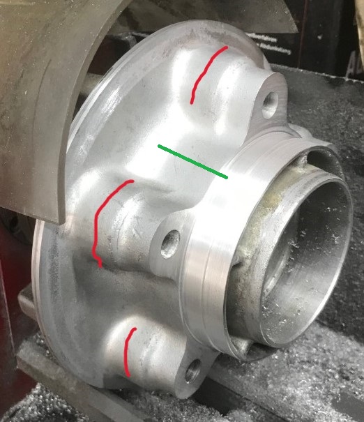

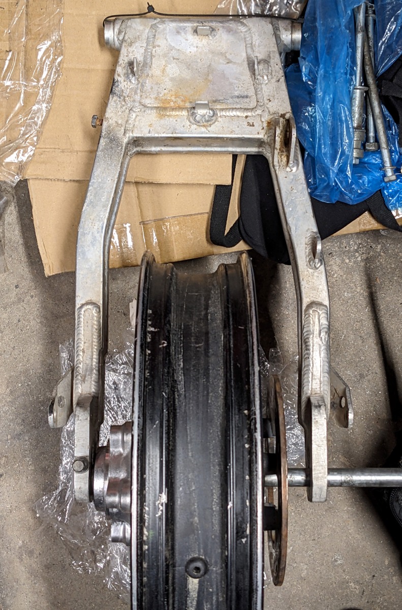

I'm mostly curious about how to fit the rear wheel. I happen to have a GXSR750 rear wheel, with sprocket carrier and rotor included. The KZ1000 rear axle is the correct size for the GSXR bearings, it right right in, I test fit the wheel GSXR into a CALFAB swingarm I happened to have handy. The wheel assembly fits between the arms of the swingarm, but it's a bit tight. There isn't much room left for a bracket to hold the rear caliper.
The real issue is that the center of the wheel is substantially offset to the right side. Comparing it to a KZ1000 LTD rear wheel I had handy, the GSXR sprocket is offset much farther away from the center of the wheel than the KZ wheel. Just eyeballing it, It looks like I'd need to take between 1/2" and 1" off of the GSXR sprocket carrier to bring the wheel back to center, when using the stock KZ1000 sprocket and chain line.
However, the sprocket carrier is cast with relatively thin walls, and cutting that far down into the carrier would basically remove the mounting surface for the sprocket. I don't think it's really practical to cut it down so that it has a similar offset to a stock KZ wheel.
Without making a custom swingarm, or finding one that was much wider, I guess then next option would to be make a custom sprocket carrier? That seems possible, but not trivial.
I guess a middle ground option would be to cut the GSXR sprocket carrier down as much as possible, and then try to use an offset sprocket on the engine side?

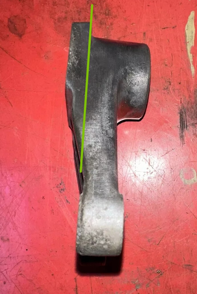

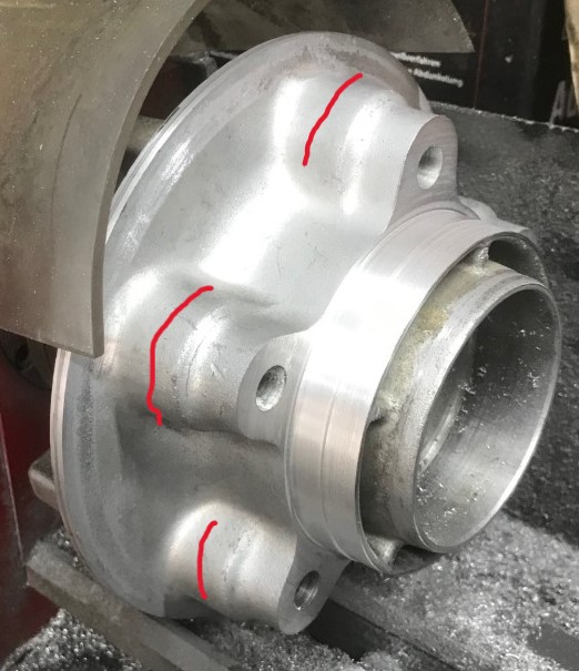

To the best of my knowledge you will definitely need an offset sprocket to allow the wheel to run central. The GSXR sprocket carrier looks very similar to the MK2 bandit item I am using (20mm axle) I have included a pic of my cut down carrier compared to a GSXR unit. The red line shows where the sprocket mounting bolts sit so still plenty of meat to secure the sprocket with 11.5mm removed. The MK2 bandit calliper hanger also has plenty of meat to allow trimming
That sprocket carrier of yours does look like it's pretty much the same design. I added a green line to your photo.
That green line follows a surface that slopes out (increases in diameter as it gets closer to the base). The casting wall thickness is roughly constant, so the inside wall follows the outside. If one were to continue to cut that center hub surface (centering surface for the sprocket) straight down, at some point it would cut through the casting wall and the entire center bearing carrier would fall off. It may still have enough meat for the bolts that hold on the sprocket, but I think it wouldn't be very useful without the bearing.
I still need to try to figure out how to take some real measurements. It's not so much about the chain location, but how much the wheel needs to move over to the left in order to be close to centered in the swingarm. If it needs to move 10-15mm, that's probably fine. If it needs to move 30 or 40mm, then things probably get harder.

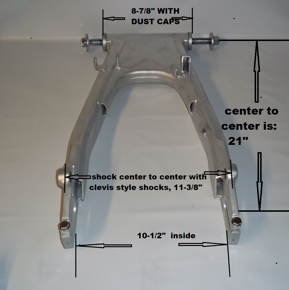

19 Apr 2025 06:39I've never tried this swap on a Kz, but I did put 87GSXR750 wheels on my 82GS1100, which was a popular thing back in the day. CalFab swing arm, spacers and offset sprocket did the trick.
I wonder if the GS1100 swingarm is wider. I had one a while ago but sold it. I did install it briefly on an '80 kZ1000, using the stock KZ wheel and caliper, and I recall it was an easy swap.
But for the GSXR wheel, if the left arm extends farther out to the left side of the bike it would be easier to center the GXSR wheel.
Anyone have a GS1100 swingarm they could measure?

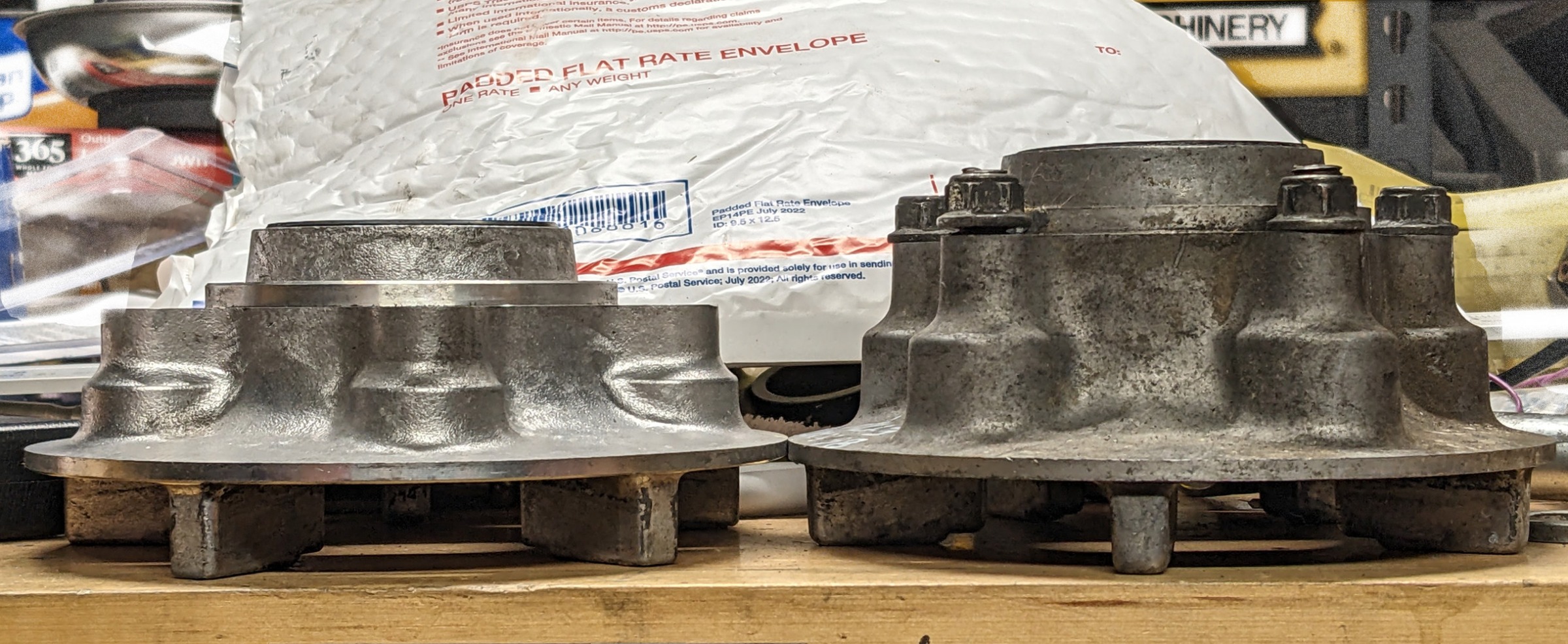

Well, the GS500 sprocket carrier does seem to be the correct answer. It looks like the same GS500 part, 6461101D00, was used from 1989 until 2009 according to Partzilla. It was easy to find one in good shape on Ebay. The carrier fits into the GSXR wheel exactly like the original, but the sprocket is about 15mm closer to the wheel.
The GS500 uses a 17mm axle as opposed to the 20mm axle that the KZ1000 and GSXR used. So the spacers on both sides of the carrier will not work without modification.
I need to get the assembly mounted on a frame and then figure out how to align the front and rear sprockets. Then I can size the spacers to line them up. Then figure out what brake caliper and bracket to use...
