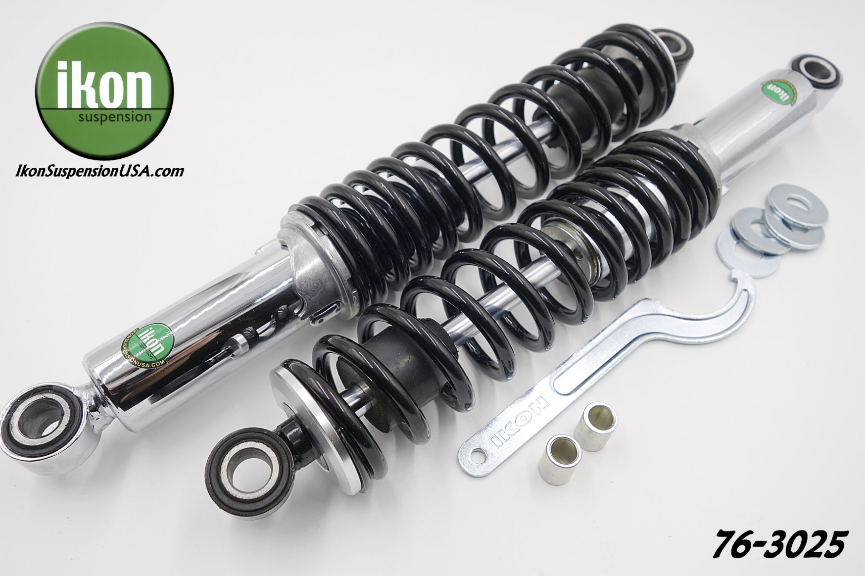

In any case, both Hagon and Ikon shocks have been recommended by many folks here on KZRider.
I spoke with a tech support person from Ikon about the spring rates they supply for the KZ1000. It's a triple rate spring, but the overall rate seemed to be relatively close to the '78 Z1R spring rates shown in the factory service manual. I figure I'll probably get a set of Ikon shocks at some point.

Figured I would give everyone here an update!
Bought the Ikon shocks and I have been thrilled by their customer service and their performance. Even had a guy from the factory give me a call to confirm my specs! Top notch stuff!
Bike rides way better now!
