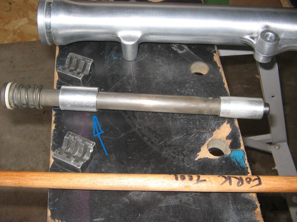

12 Jan 2025 07:23 - 12 Jan 2025 07:25I don't know about the 1100 frame but I was able to lower my 650 by 1" front and rear without any negative results.I'm working on a KZ-1100 but it's a little too tall. I can get it 2 inches shorter with 12.5" shocks. This
would give me good flat foot contact with road. What method would be best for the forks? A 2" spacer inside the forks? Or' would just sliding them up into the triple crown be best? The exhaust needs to be replaced anyway, So I'm thinking about rerouting the pipes and using smaller mufflers too.
The rear tire does scuff the inner fender plate when the shocks bottom out (a rare instance) I did do a DIY lowering block inside the front forks but it was only 1.5" long. Whatever you put in there only truly gives about half of that length in lowering that you looking for. The rest I was able to get by raising the fork tube up in the upper triple clamps.
I think your idea of trying to lower the front by 2" seems to be a bit too much. You have to remember those stock forks don't have a lot of travel to begin with. You also need to take into account suspension sag and rider weight when making some of these alterations.
