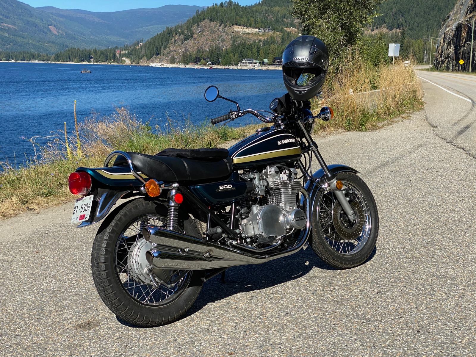

Yes, there was a photo.  Not sure why it disappeared but here it is again...
HRM how about a BOTM feature on that beauty ?

Very nice bike! Thanks for sharing pick Why is there no kickstarter ? when looking at the tires i think i will install the gold seals .Did you also get super low milage on them?

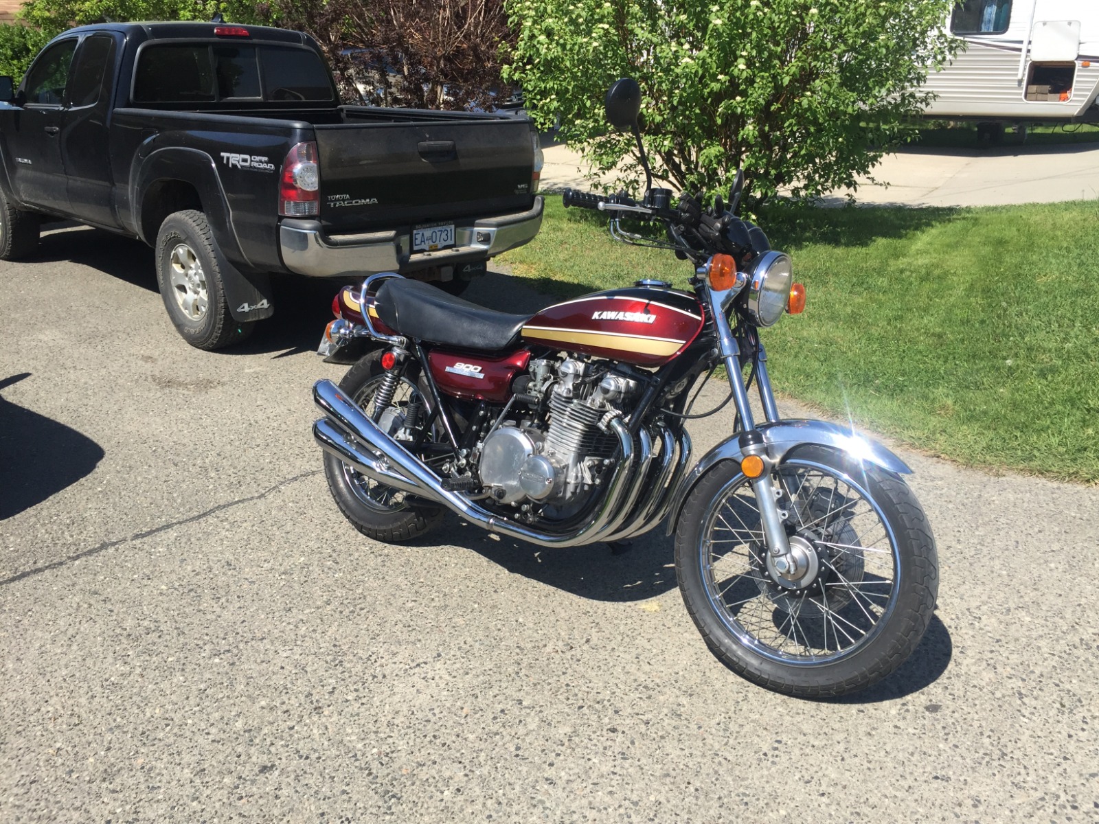

It had no kickstarter when I bought it, but the bike was a mess.  I stripped it down and rebuilt it completely.  I put a new kickstarter in it and when I started the bike up it sounded like two gears were skipping over each other.  So I pulled everything apart, checked and re-did the engine.  Same result upon startup.  I pulled the engine apart 5 times before I finally found what was causing the problem.  The PO had installed a close ratio transmission, and the kick start gear was barely touching its mate gear.  That's when I realized why the bike had no kick starter when I bought it.  Anyway, I rode it like that for a year and then pulled it apart again and replaced the tranny with a stock one.  I still have the close ratio tranny somewhere in my shop but I sold the bike to a friend.
The bike below is the one I have right now.  I don't put a lot of miles on my Z1's so I can't say I've worn a set of tires out.  My memory from a Z1B I owned back in the day was around 6,000 miles on a rear tire.  Wookie, I'll look to see if I have photos of that bike for BOTM.  I don't have the bike anymore though.
