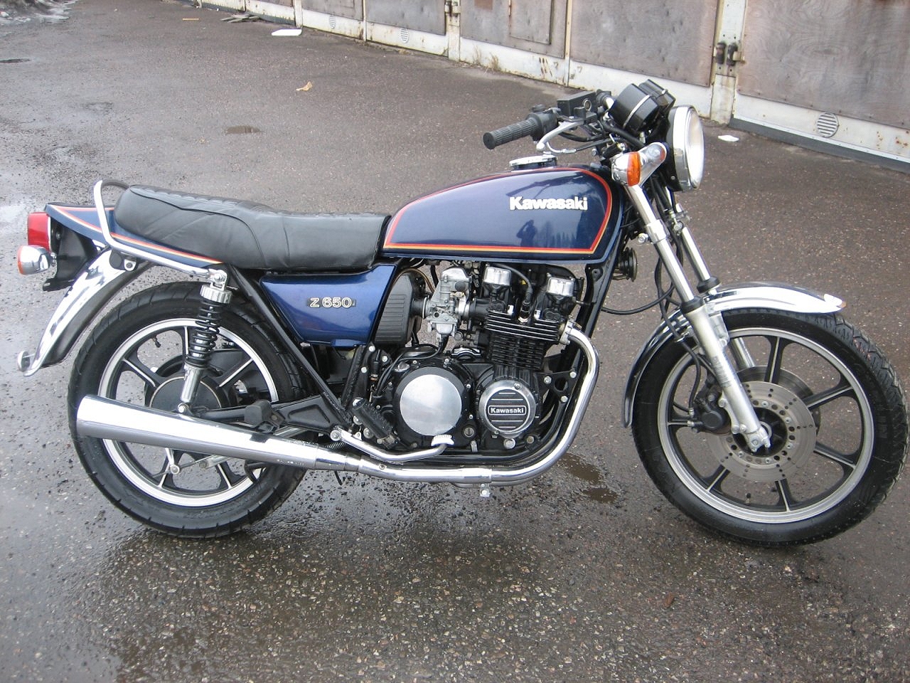

Hi all
I would like to fit a grab rail to my 1978 Z650 B2, does anyone know if one would fit from another bike?, maybe a z900 or 750?
thanks
thanks
1978 Z650 B2, US import to the UK

The frame grips are on but I wanted to fit one that goes round the seat as on the Z900

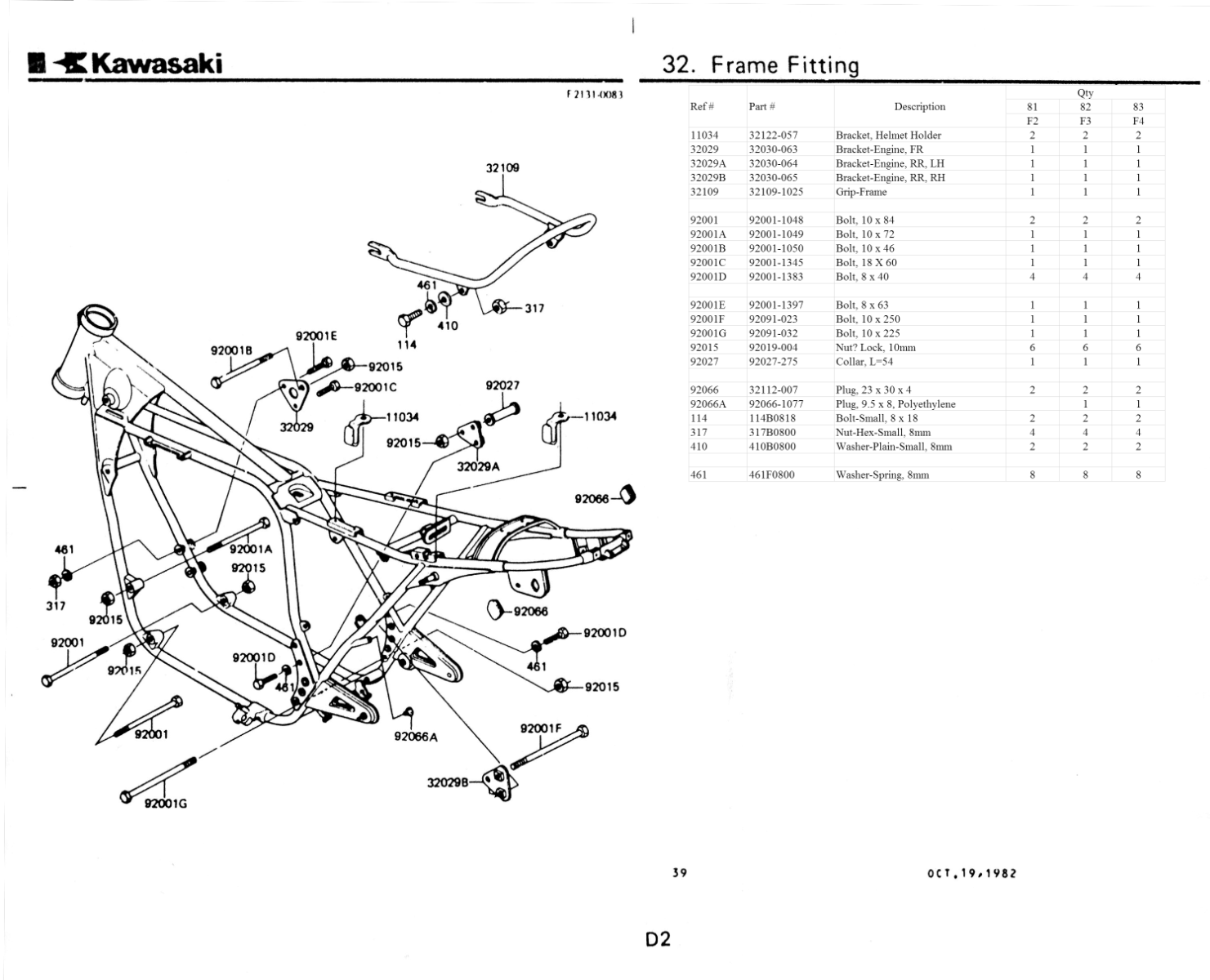

Kawasaki did make a unit (part # 32109-1025) like what you are seeking. The part was used in the UK and EU markets at least that is my understanding. I know the 81,82 and 83 F models for the Z650 machines. I do not know of anyone making it now but you may get lucky and find an old one on line.

By gd4now: Kawasaki did make a unit (part # 32109-1025) like what you are seeking. ... {parts diagram} ...
Is that parts diagrams from a microfiche? Thanks.
Andyp62: the Jarlef z650 site has some pics. the D grip looks different than the F. >> jarlef.no/Kawasaki/Series/Z/650/Z650F.htm

Yes the pic came from a on line parts lists for the F2, F3, and F4 Z650s.
z650.surr.fr/parts.html
Here are the part #s that I have found for the grab rails that were stock on 650s As I understand it the grab rails for the D and E models are different length than the one used on the B, C, and F1 model.
32109-016 - one on each side
KZ650-B1 (1977)
KZ650-B2 (1978)
KZ650-B2A (1978)
KZ650-B3 (1979)
KZ650-C1 (Custom) (1977)
KZ650-C2 (Custom) (1978)
KZ650-C3 (Custom) (1979)
KZ650-F1 (1980)
32109-1025 one piece both sides and back of seat
KZ650-F2 (1981)
KZ650-F3 (1982)
KZ650-F4 (1983)
32109-1002 - one on each side
KZ650-D1 (SR) (1978)
KZ650-D1A (SR) (1978)
KZ650-D2 (SR) (1979)
KZ650-E1 (LTD) (1980)
32109-1016 one piece both sides and back of seat
KZ650-H1 (CSR) (1981)
KZ650-H2 (CSR) (1982)
KZ650-H3 (CSR) (1983)
KZ750-H1 (LTD) (1980)
KZ750-H2 (LTD) (1981)
KZ750-H3 (LTD) (1982)
KZ750-H4 (LTD) (1983)
KZ750-M1 (CSR Twin) (1982)

OK not sure why but I feel like I sort of sent you down a rabbit hole. I asked on the z650 proboards site about the grip for the F model bikes as was told they are like hens teeth, you will not find one.
You did ask if there were other grips from other bikes that might be made to work. I do not know off the top of my head if any other units would work on a 650. I think the issue would be the length/distance between the connections points.
Kawasaki did make another like grip for the 650 H models (these were sold in the US unlike the F2 F3 F4) The part# is 32109-1016. It is my understanding, not saying my understanding is correct, that the connection points are not the same on the B, C and F and is not a direct bolt on. It is also my understanding the the above part will work a 750 twins.
Others here may be able to measure the connection points on the different models to see if any will fit.
Sorry for sending you down the rabbit hole!!!!!
