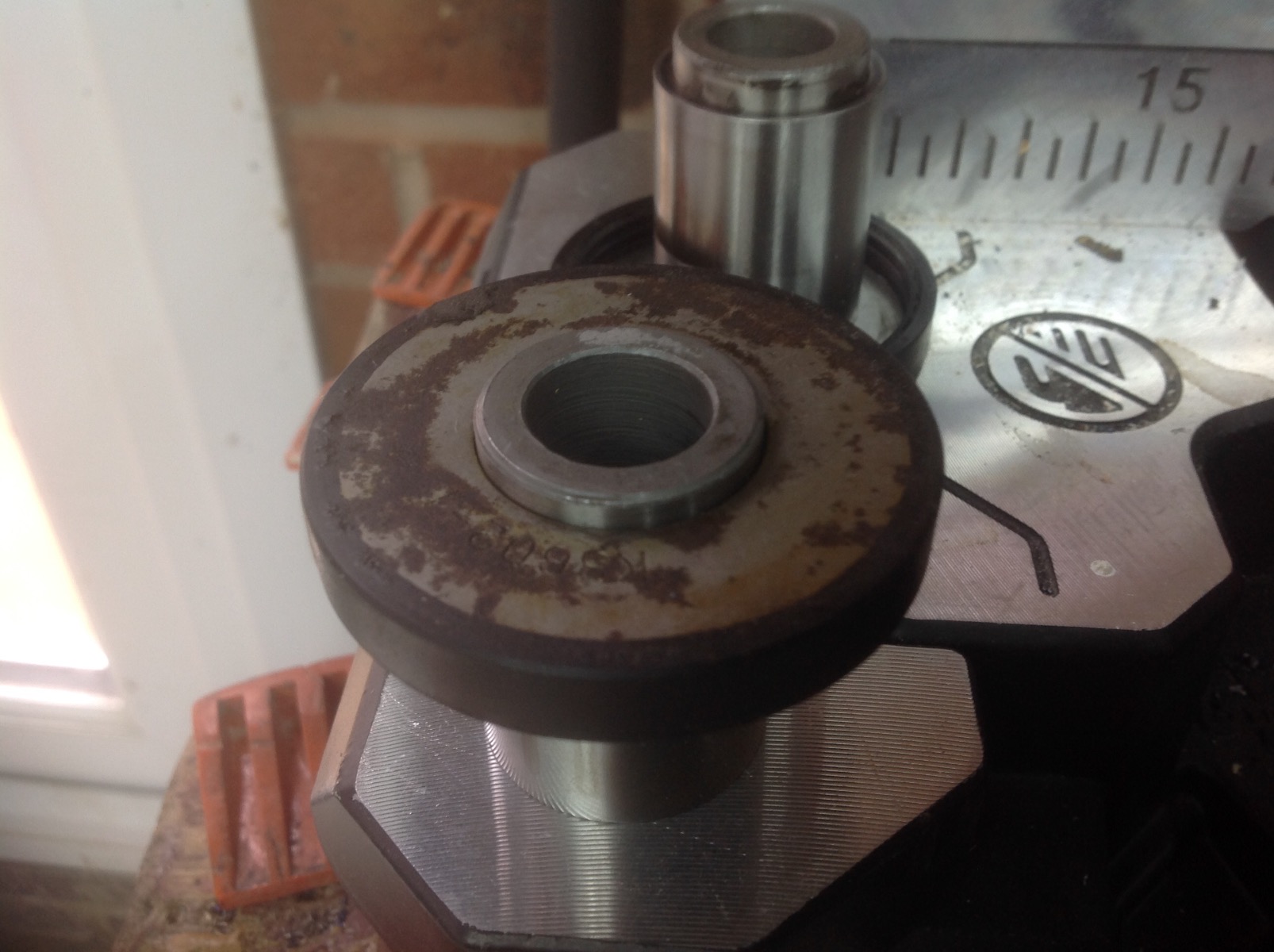

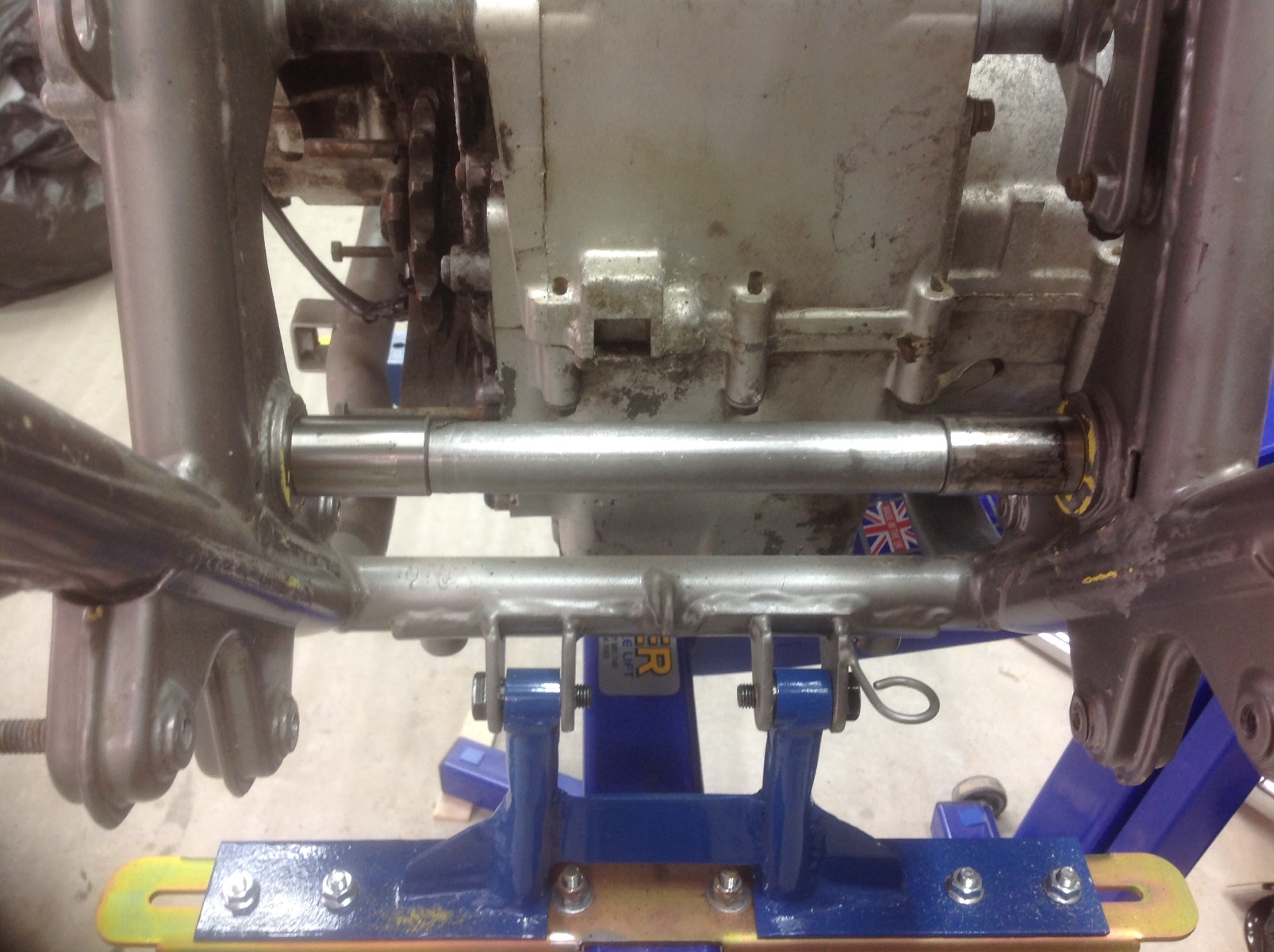

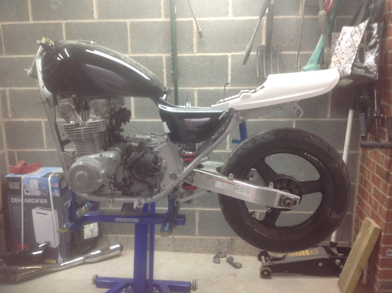

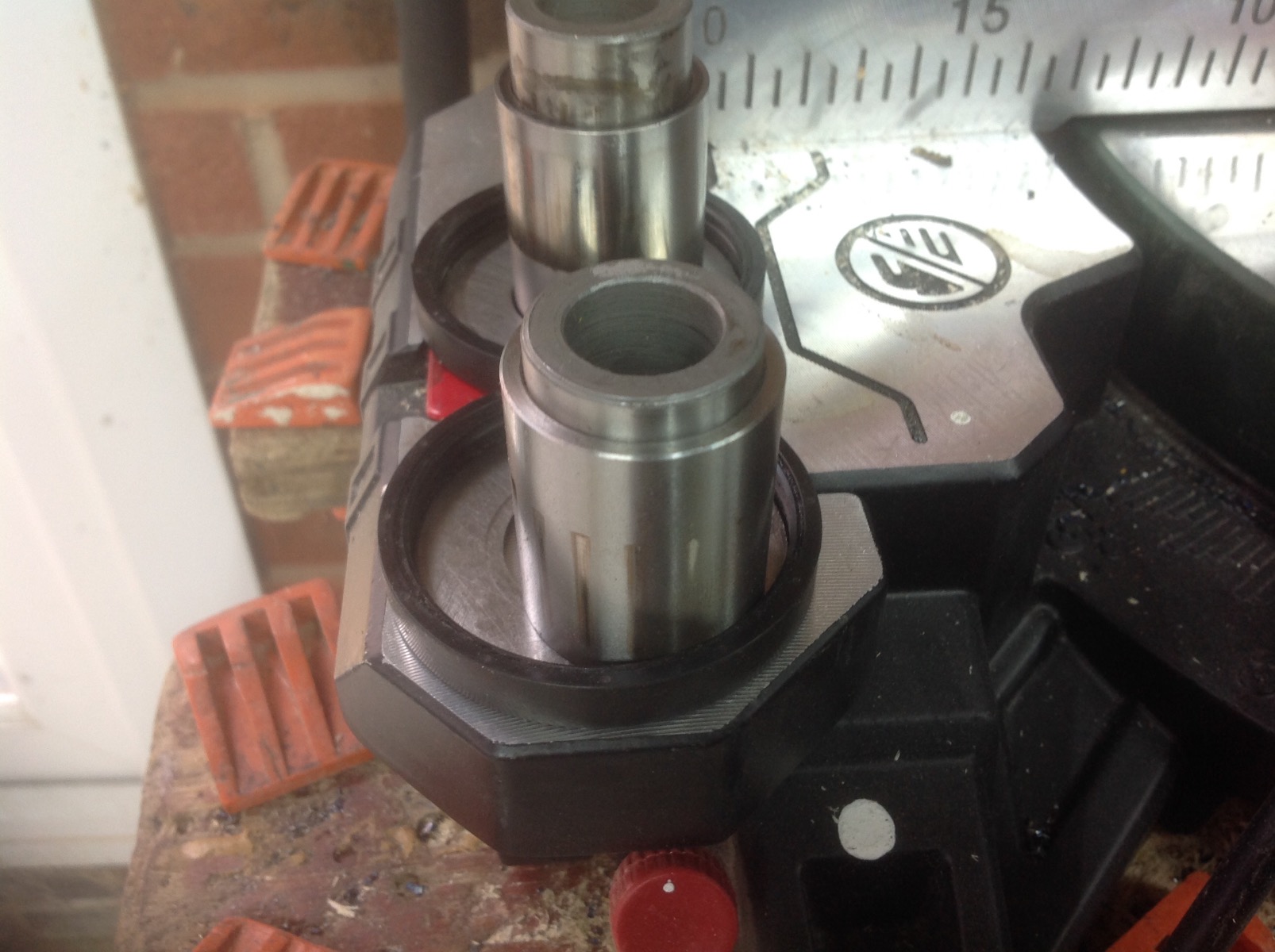

11 May 2023 16:47 - 11 May 2023 16:49I don't disagree with you Zed, however unless you have access and the skills to do your own machining (which obviously you do) sometimes simple is best. To use the GSXR wheel in the GS swingarm the wheel etc would need to be adapted to come down 10mm on the axle diameter (not impossible) but if he is determined to run the big wheel then a complete GSXR600k1 back end would make sense, with the exception of shock mounts the swingarm is almost bolt in. The KZ inner races and centre tube fit perfectly inside the GSXR inner races and support tube, all that is needed is a 1mm spacer washer either side. Even the stock GSXR dust seals fit perfectlyI have done many wheel and swing are swaps and anything can be made to fit anything else.
