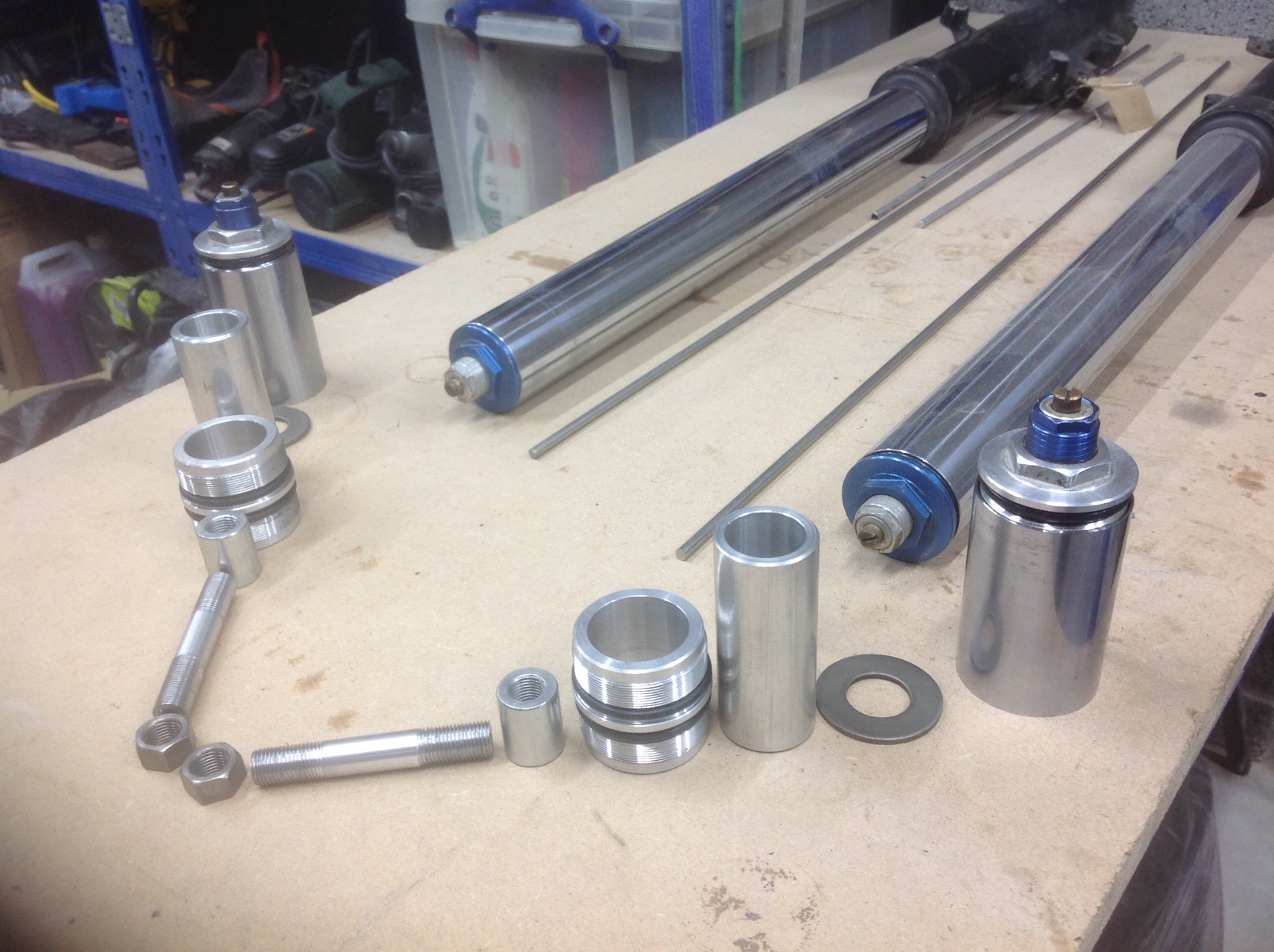

I had mine made in alloy as part of my fork extensions ( they are 75mm long though so I think it would of been asking a lot of PVC)
