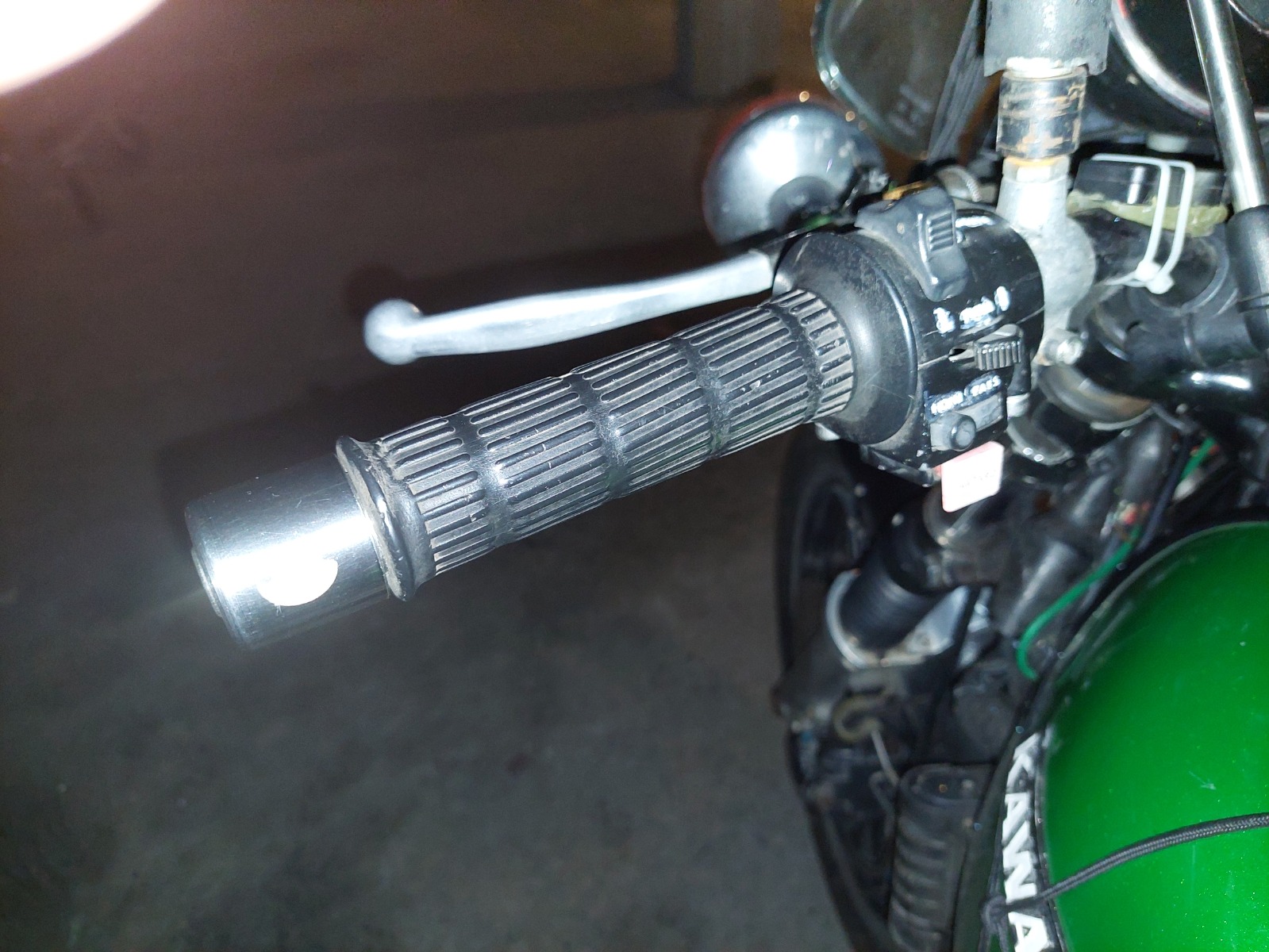

Aloha guys.
Haven't worked on my bike for a while, but summer is coming and I have a feel I'm gonna spend lot more time working on the bike now.
Anyway, the other day, I was brainstorming because I couldn't sleep and thought just came to me. Handlebar end weights. I have them on my ZX-7, but not on the KZ, and because my ZX-7 is still apart, I have no way to take it off and check or compare with and without. So my question is, just how much or rather, is it worth getting one and install it at the end of the bar? I don't remember any vibration coming from the bike when I was riding, but hey, since I'm working on it, why not? I mean they are not that hard to install, but I'm working on the bike. Why not get it while I'm still working on them.
Anyone know how effective they are? BTW, I did some search on this forum but I couldn't find the topic about this. Maybe I didn't look hard enough.

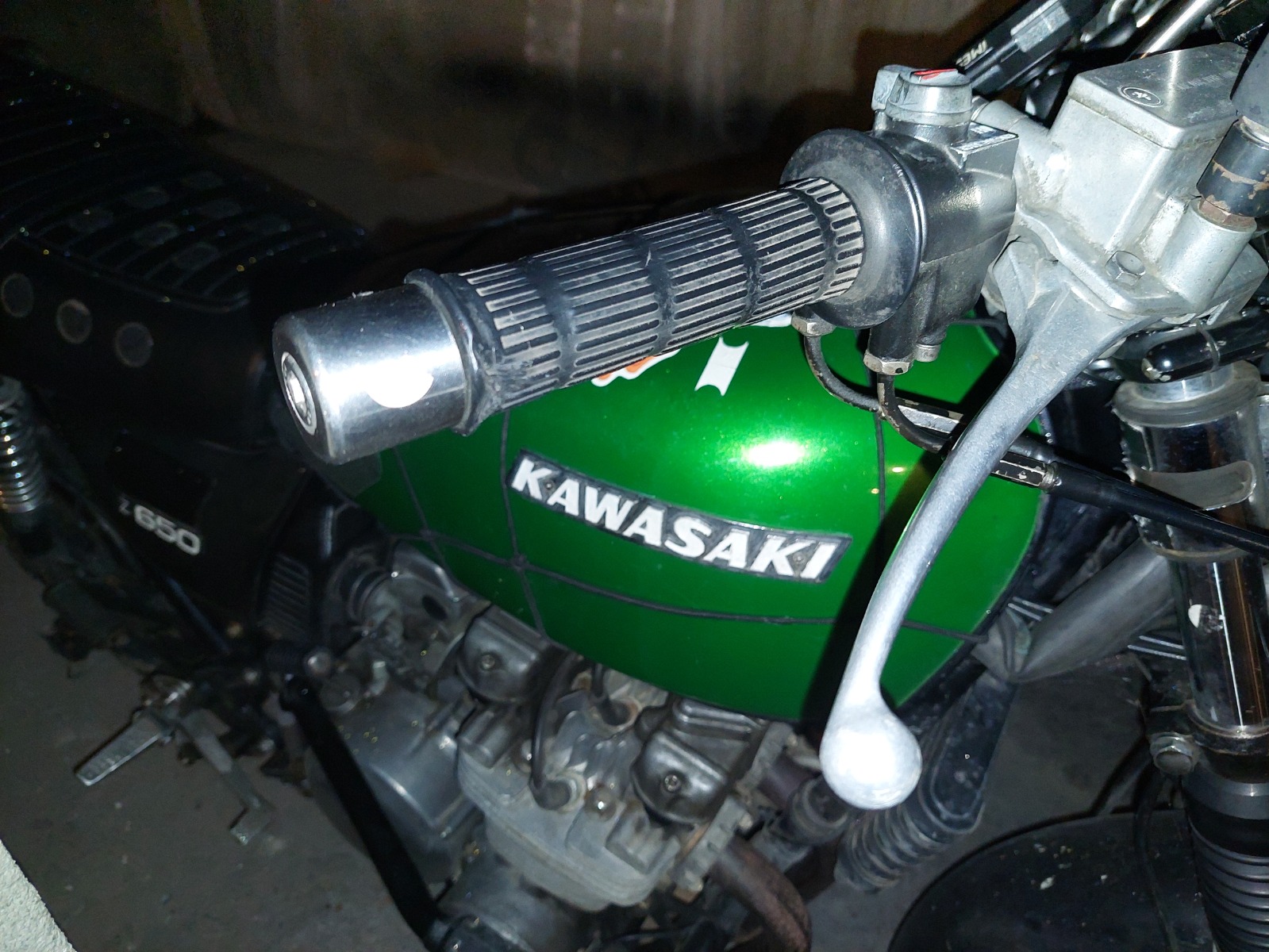

23 May 2022 00:02The OEM's wouldn't use them if they didn't work. The question is how much?
Exactly my thought. My ZX-7 has it, but not KZ. So I was just wondering how smooth it will be. I have never own one, but it seems as all the Zephyr series came with bar end cap. Could those be weighted ones? Any Zephyr owner, can you confirm this?

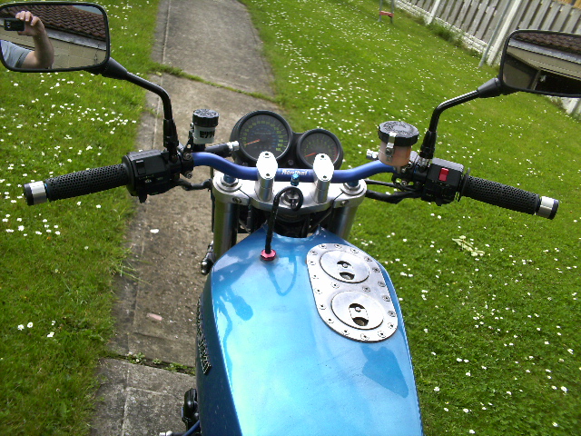

Added some hefty stainless Suzuki bar end weights to stiff Renthal drag bars.
Used a bolt and rubber tube + nut to grip the inner bore of the handlebars.
I recall that I machined the diameter to match the stock grips.
Works well, less vibration and improved steering.
