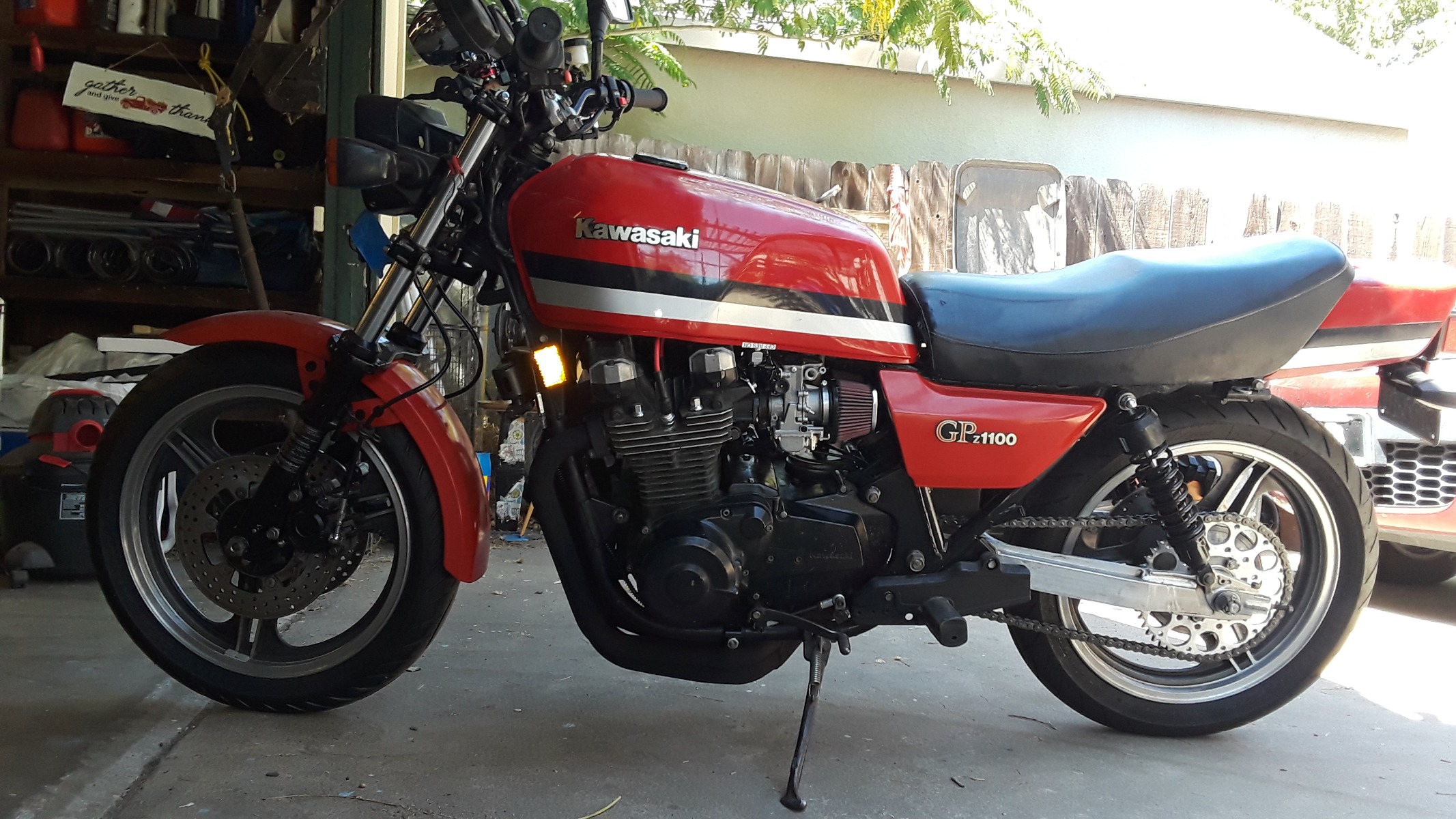

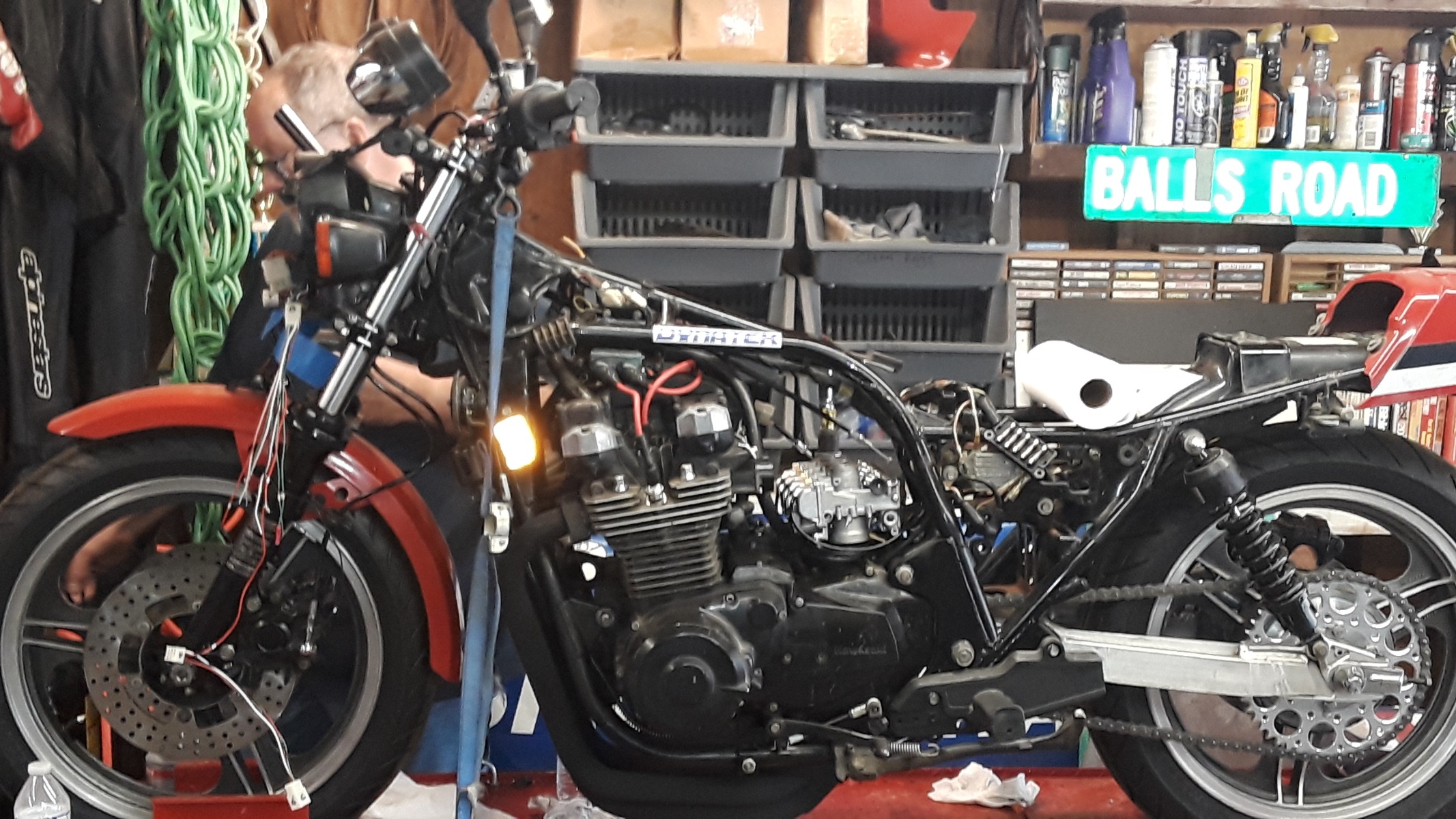

You'll have to make up spacers to make the swingarm fit, I have one on my GPZ ans used some stock spacers and have to make the rest., I'm making a custom brake stay.....
