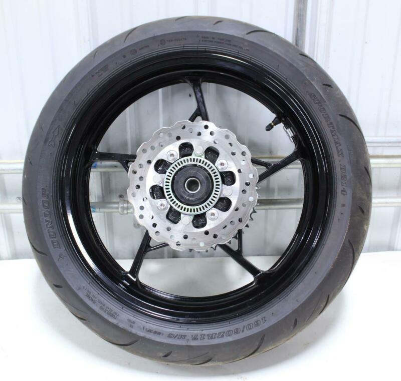

Also, I've found , what I think are the perfect wheels for a swap on these old bikes, that is if you are going to go to 17 inch wheels, take into account I've also used a different front end and swingarm, and some mods to the wheels are to be done, I'll be swapping to these wheels later on down the track. They are a set of 17 x 3.5 front and 17 x 4.5 for the rear, they are from the late model 2017-2019 Z650 Kawasaki, 5 spoke and way lighter than the original Kawasaki mags. I'm having to machine a small amount from the front disc mounts, and some from the rear sprocket carrier but the difference in unsprung weight will be noticeable, I think they look great as well... Its still a bit of work to make any aftermarket, or different model wheels fit though, not a job for the inexperienced.....
