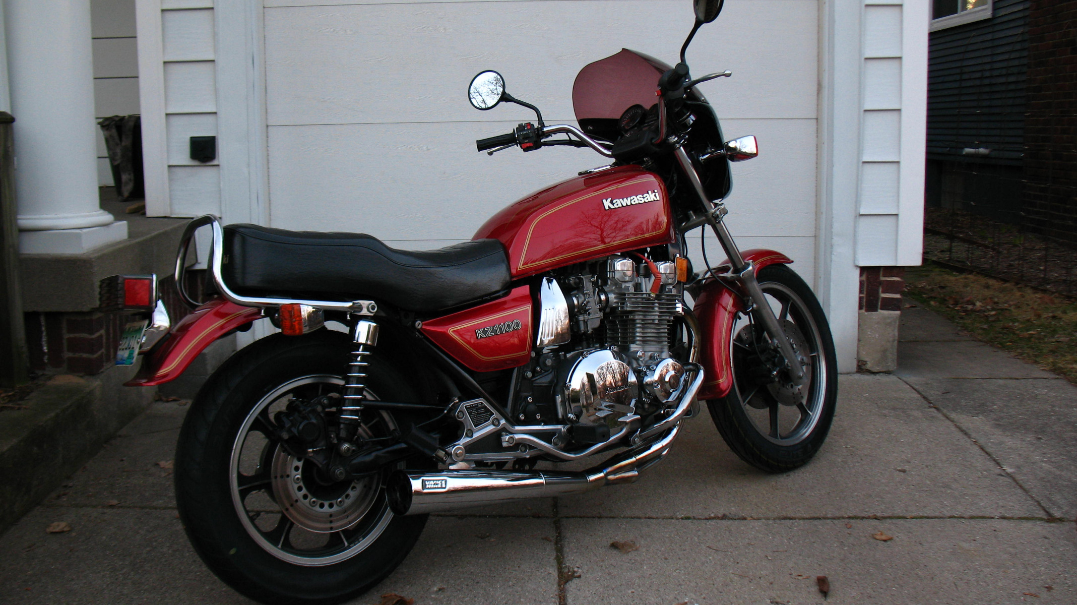

Since junking the air-ride system several years ago, I have been riding on Progressive 12.5" shocks and fork springs. By comparison, my 1100A handles beautifully and the ride is way sportier IMO.
Note the absence of an air balance contraption on the front forks. It was a pretty simple adaptation once the forks were removed.

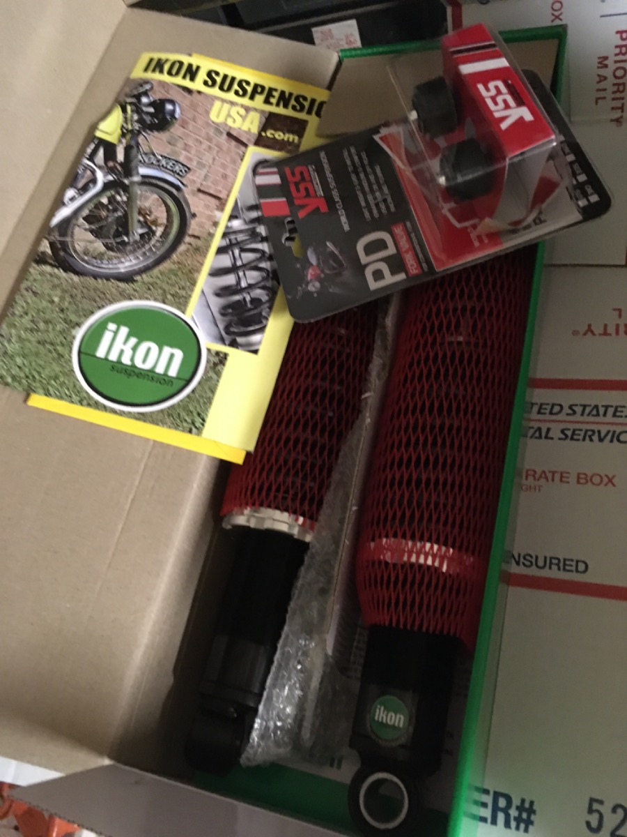

Well, this is what I wound up with-made-to-order Ikon 7614 alum body shocks from Ikon USA in PA and YSS 265 Emulators from Brooks Suspension in England. Waiting for the seat from Sargent where they’re going to try to replicate a ZRX seat shape.

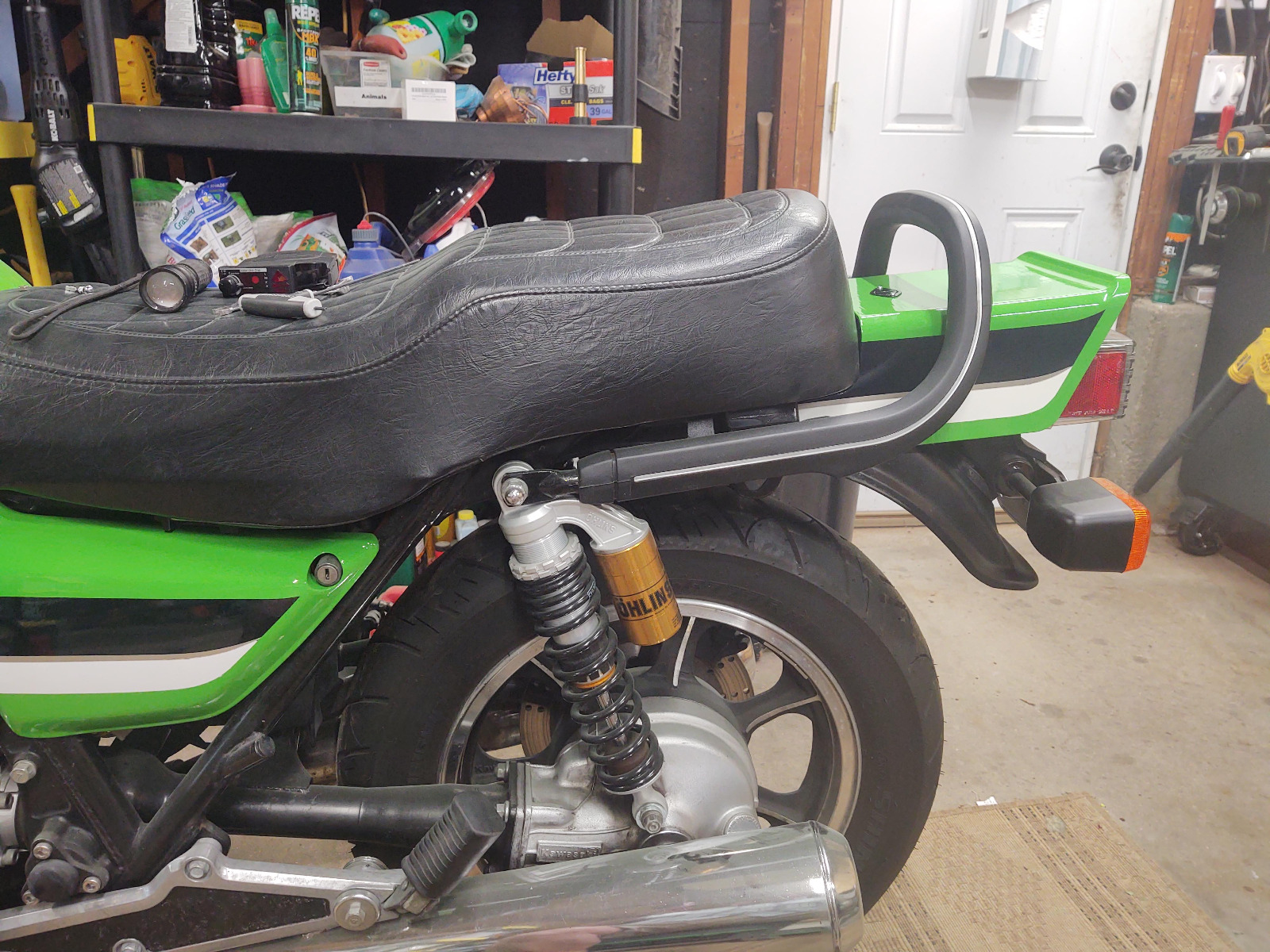

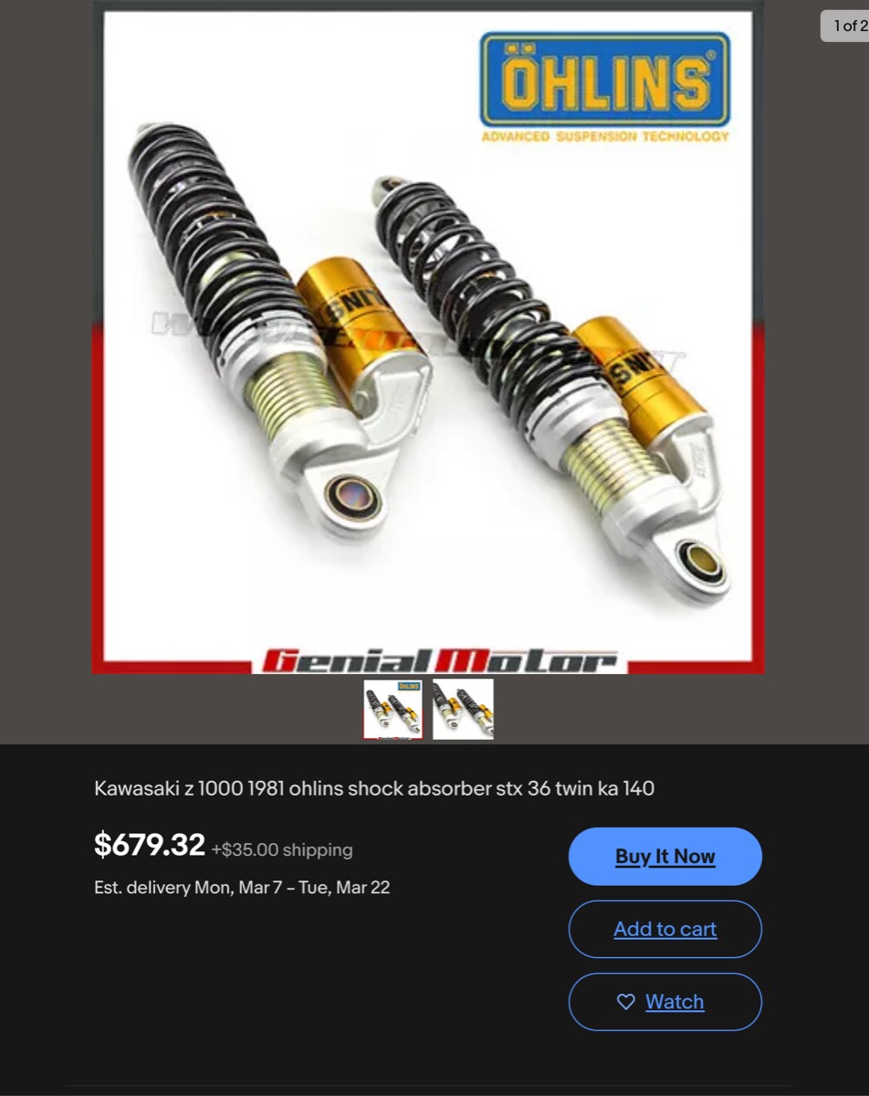

I checked and Ohlins USA says they don't have them available anymore. I could get them off eBay from Italy for one or two hundred more. They look cool but then so does keeping original non reservoir. Tail section is cool. Why not post a pic of the whole bike? And, where’d you get the grab rail?
I’ll post pics, buy I’m looking at snow and motivation is spread thin. I also want to lube steering head, swingwarm and drive splines, check valves and put a jet kit in, so I’m still collecting parts and don’t want to work on several times.
