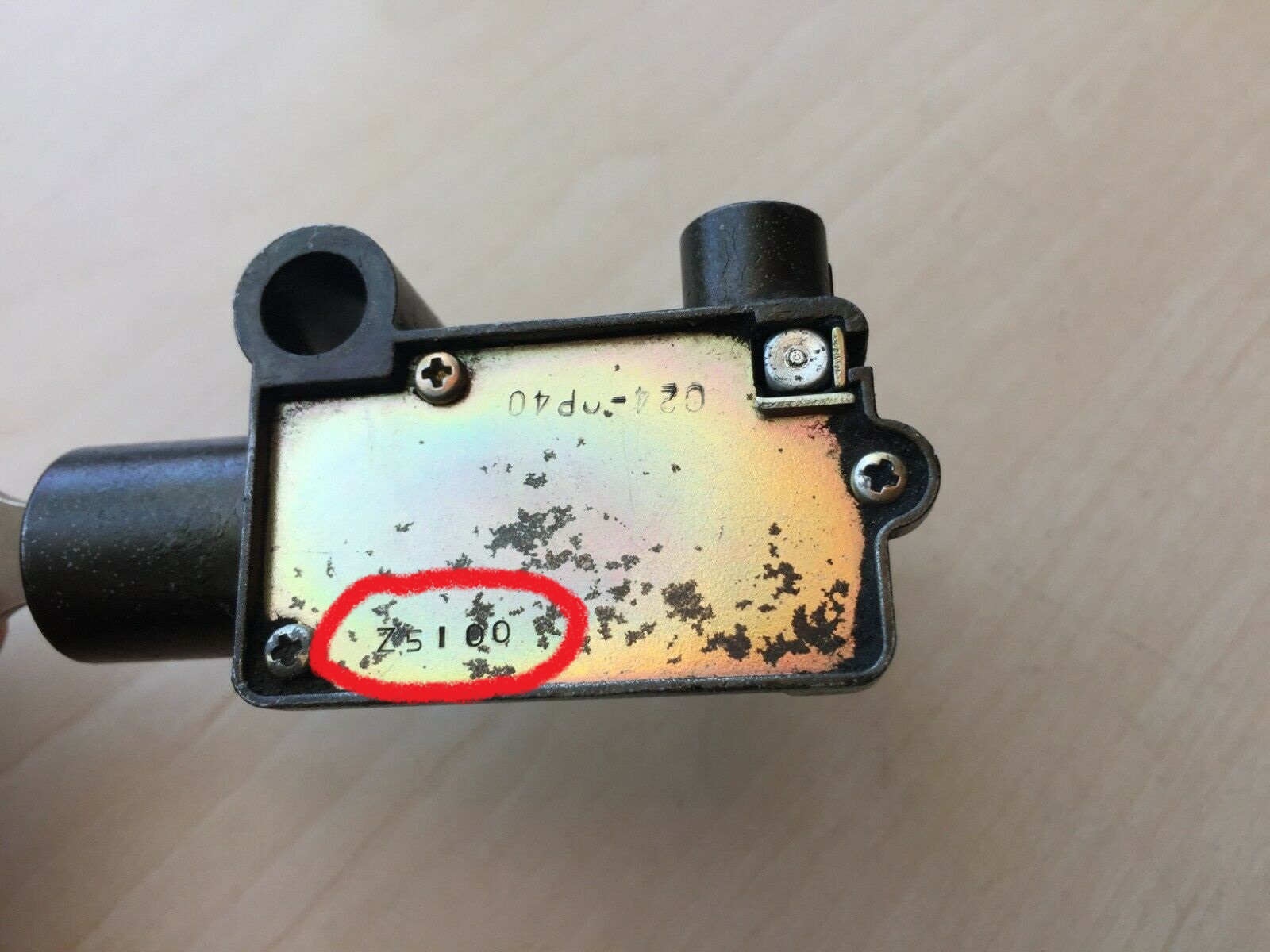

- Highway Magician
- Posts: 78
- Thanks: 34
Re: Fuel tank cap key question
09 Apr 2021 14:06
I've never had Kroil attack painted items.
Here's where the seat lock, key code is stamped. It will begin with Z.
Motorcycle builder since 1973. Master Tech. Current bike: 1982 GPZ1100B2.
The following user(s) said Thank You: Claude.

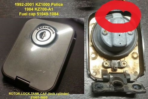

If your cap is like the one pictured below, you can see the 'gaps' in the corners of the cap on the hinge end. I know on KZ1300 models, it's possible to get in that gap with a thin punch and punch the hinge pin out to remove the cap. Once the cap is off, you can take it apart to find out what's stuck.

- Highway Magician
- Posts: 78
- Thanks: 34
11 Apr 2021 20:44
It's likely that the latch (circled in red) is stuck. You can remove the fuel sender and get a good idea of the tank's condition.
I would drain it (if necessary), invert it and then pour several gallons of boiling hot water into the tank (through the fuel sender opening).
Then put the fuel sender back in. Let it sit for 5-10 minutes, put the tank upright and try to unlock it.
I've used boiling hot water to free up totally stuck and heavily varnished carburetors. I think it would work in this situation too.
