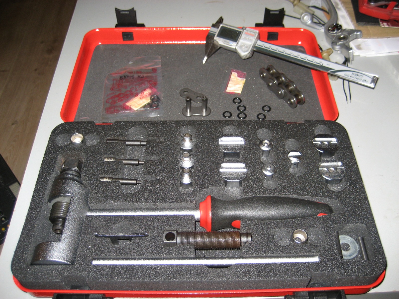

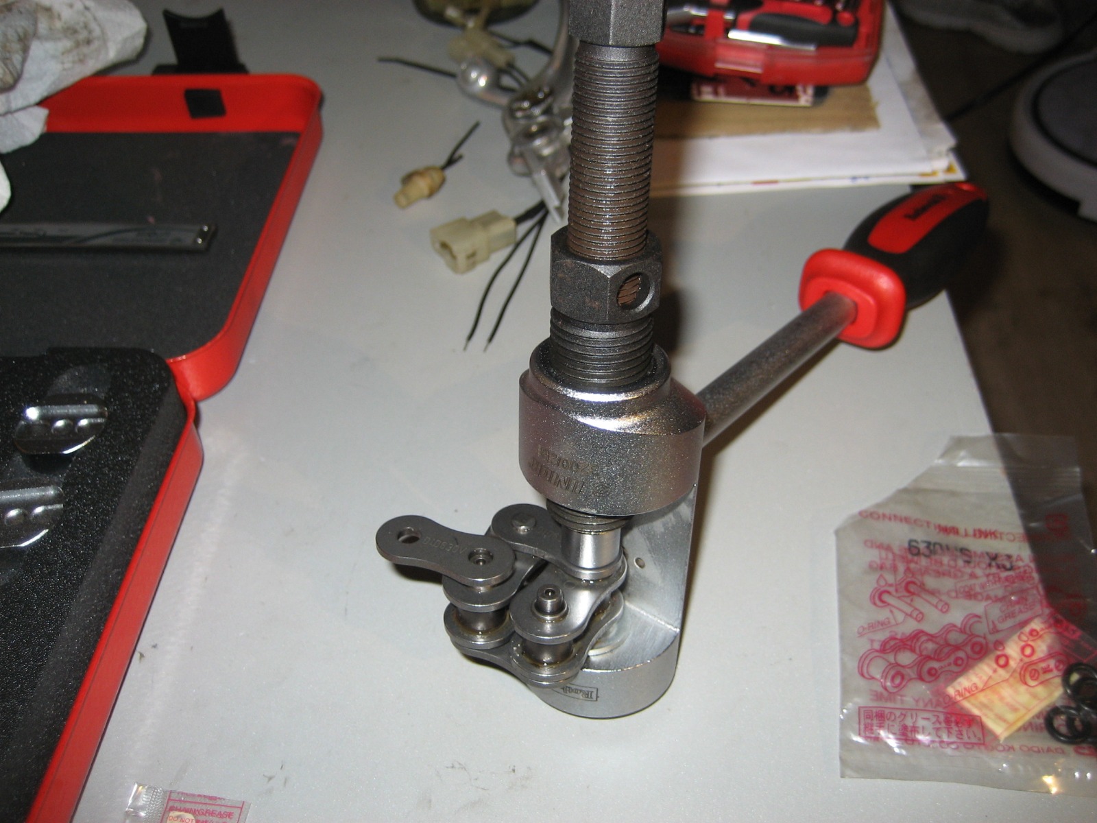

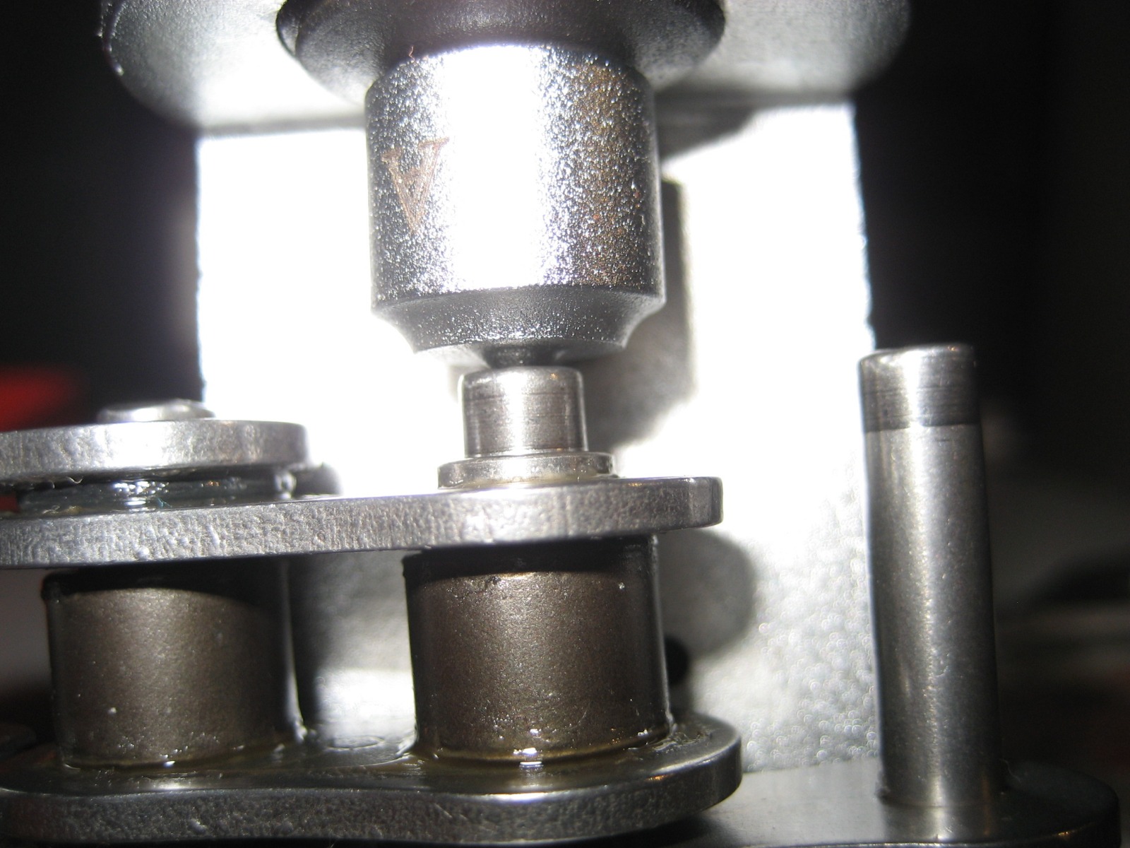

Stay away from cheap chinese tools. I love to buy quality tools.
www.louis-moto.co.uk/artikel/rothewald-c...ald-tilting/10009883
