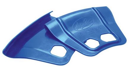

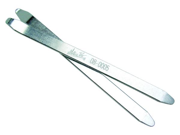

27 Jan 2021 15:24650ed wrote: I use a pair of Motion Pro rim protectors and two 11 inch Motion Pro tire irons. Ed
Thank you for the tip!! I didn't know rim protectors were a thing but now I need some.
The KZ440B project bike has powder-coated rims and I was worried about installing the tires. The original plan was to coat the tire irons in Plasti-dip but I wasn't sure how well that would hold up.

By Nerdy: Thank you for the tip!! I didn't know rim protectors were a thing but now I need some.
I doubt Plasti-dip will hold up at all. The first time doing the job I used milk jug plastic >> large pieces folded in half. Then I got some rim protectors which make the job much easier. see pic. The milk jug plastic tends to move around. no big deal, but kind of a pain.

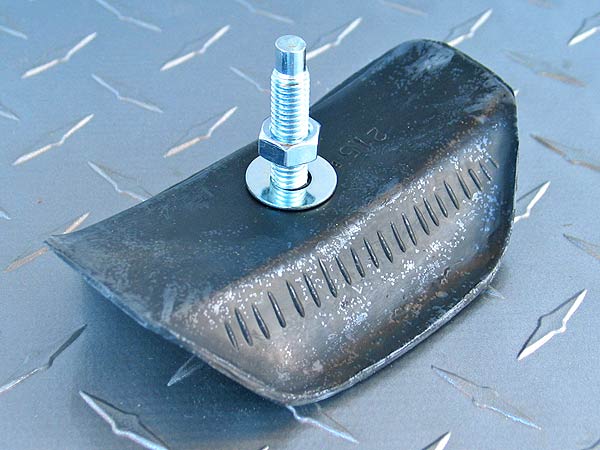

28 Jan 2021 15:36 - 28 Jan 2021 15:38Kidkawie wrote: Practice.
Theres more involved than just slapping on a new tire. First, throw the tube protectors in the trash. You should run 2-3 layers of quality duct tape in its place. Use baby powder on the tube and inside the tire so the tube doesnt get bunched up. I use the 3 lever method. Been doing MX tires for 30 years, street tires are easy as F. Front tires barely need spoons.. Line up the yellow dots with the valve stem.
I always use the tube protectors (rim locks). Why, one might ask? This is because many years ago on my BSA, which did not have rim locks, the rim slipped a tiny bit some number of times inside the rim until eventually this slippage caused the the rim to clip off the tube's valve stem. This happened when shifting into top gear in heavy traffic. Needless to say I was extremely lucky that the idiot directly behind me didn't hit me when my rear tire immediately went flat causing the back of the bike to swerve radically and violently from side to side. He thought I was doing it on purpose!
I don't know if modern tires on the Kawasaki might slip a little inside the rims. Maybe they won't or maybe they will, but considering the tiny extra time it takes to install the rim locks I'll keep using them. Ed
