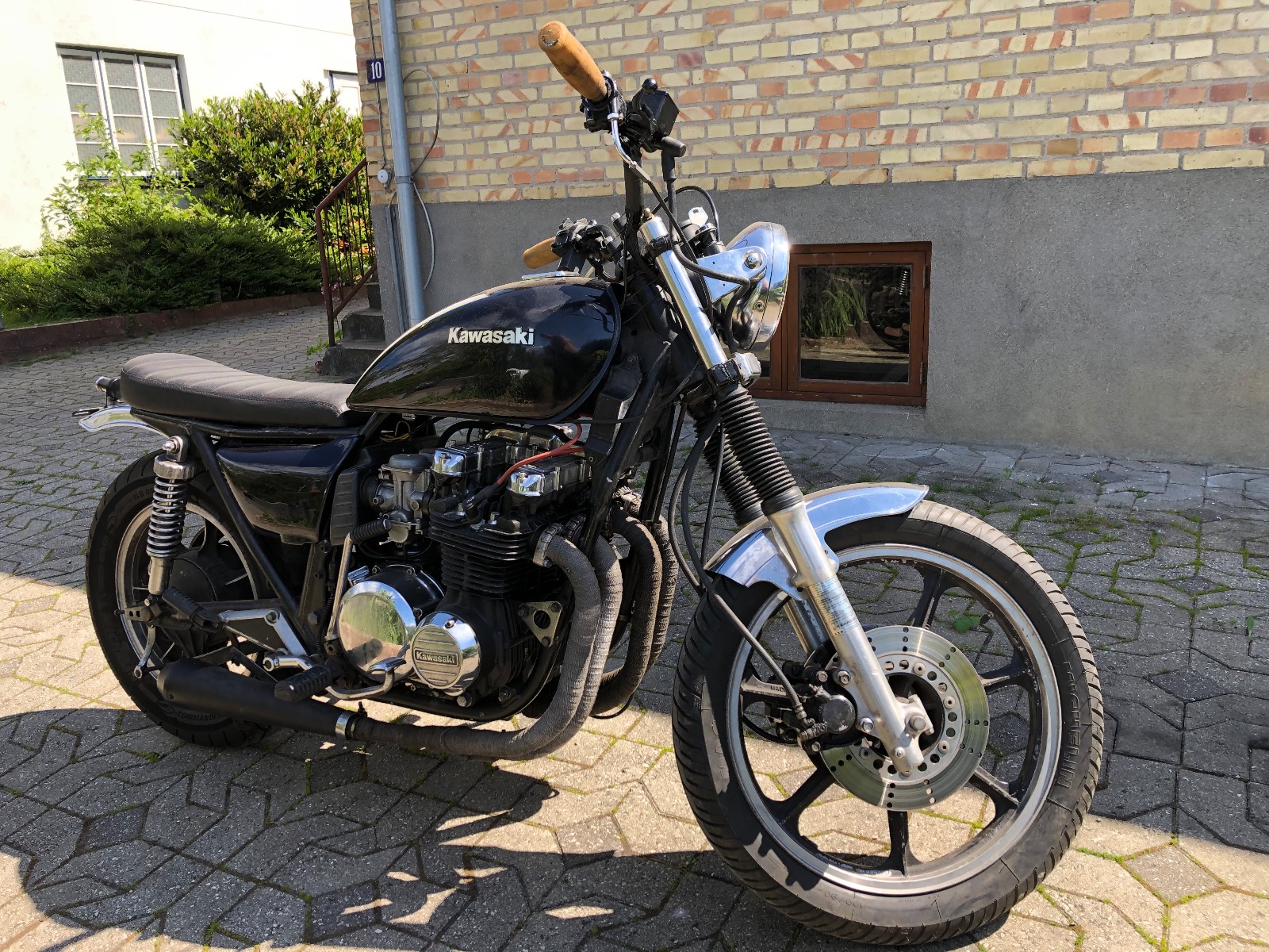

A picture of your bike would be very helpful. That would help us identify it as a 1977 KZ650-B1 or a 1977 KZ650-C1 (or maybe even a later model). Ed

23 Jun 2020 22:27650ed wrote: A picture of your bike would be very helpful. That would help us identify it as a 1977 KZ650-B1 or a 1977 KZ650-C1 (or maybe even a later model). Ed
That is a very good point and reasonable request

OK. Step one is to find out exactly what year and model bike you own. I can tell you for certain that is NOT a 1977. The forks, carbs, swingarm, wheels, etc. all show is is a later model.
Take a look at you bike's VIN (frame number) and then compare it to those at models.kz650.info/index.htm to see what year and model you have. The bike's VIN will be stamped into the neck of the bike where the front forks attach. Also, find the engine serial number which is stamped near the oil filler cap and also compare it to see if it's the correct engine for the bike model. Ed

24 Jun 2020 08:54650ed wrote: OK. Step one is to find out exactly what year and model bike you own. I can tell you for certain that is NOT a 1977. The forks, carbs, swingarm, wheels, etc. all show is is a later model.
Yeah unfortunately the papers and VIN number are as far away as the bike. Even then, I do not think that it would help, as it is my clear impression that it is a bastard with parts from a lot of different models. The engine is a kz750E for instance. And I am pretty sure that the papers says 1977 Z650 (as I am in Denmark and therefore it is not called KZ).
But perhaps you can then just help me identify the frontend? That should be enough to order brake hoses in my opinion.
